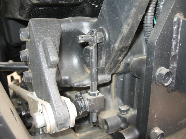

Getting ready to down load some pics been working on it all day WOW what took me an hour to cut the yard only took me 20 minutes with the 54D, but I do have some questions the selector knob for deck hieght what does this do because I had to use and adjust using the adjustment for the cat hitch. It has been a learning experince for me due to the fact this is my first tractor. The question was raised what impliments I got, I have a 54D 200cx loader a five foot scape blade and going to tractor supply this week to pick up a 4 foot countyline bush hog.:D Will be getting those pics soon
   / 2320 #5
on my 2320 the deck height selector knob is all but useless.. The full up 'locked' positionn is only 1 'click' away from a height of around 3" (which to low in my opinion). Also the markings dont even come close to lining up
I ended up using a mower deck height measuring tool and figuring out where about 4" was and marked it on the 3pt lever.

   / 2320 #7
Brian
You know you posted that same issue back last year and I gave a method to fix the issue and others have tried it and it works well. That deck position control works very well when everything is adjusted properly. Also one of the other members mentioned about the rod that goes from the 3pt to the deck lift, on the older ones it has a threaded clevis on one end that you can adjust after you get the 3pt upstop set correctly and then the knob can be calibrated.
http://www.tractorbynet.com/forums/...g/150174-2320-mid-mount-mower-adjustment.html

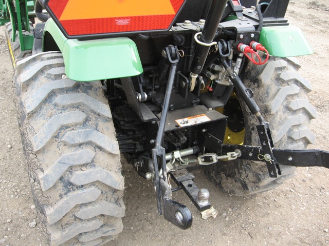

   / 2320 #8
For any 2320 owners that are interested here are a couple pics of the upstop limiter, one a closeup and the other a bit farther away so you know what you are looking at..
As I mentioned in the other post be careful with this adjustment and do it one turn at a time then test to see if you have adj it enough. Also as I previously mentioned I am not responsible for any bad stuff you do to your own tractors based on any of this info, but done correctly you will be a happy camper.

   / 2320 #9
I never saw your previous post on this topic, sorry..
I am going to reread the posts and possibly attempt the fix sometime soon..
Brian
