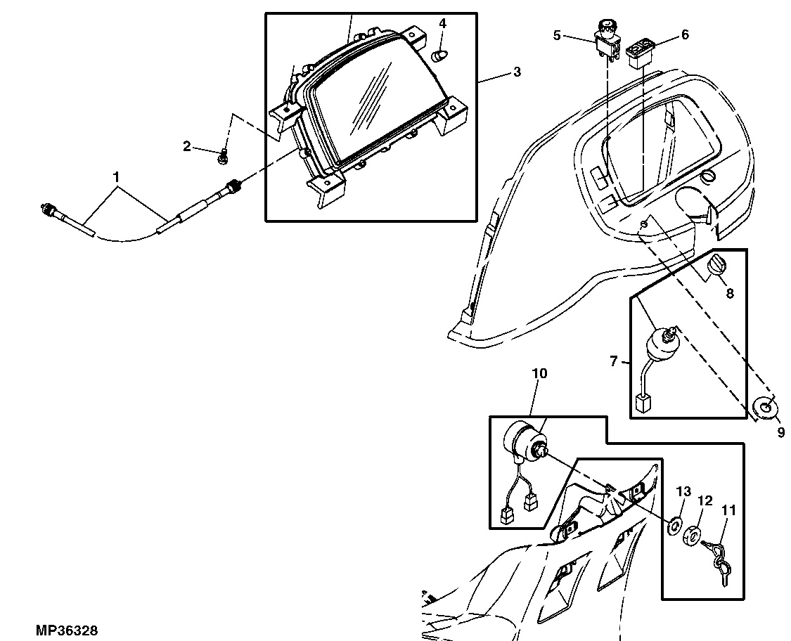

Hi All,
Started up the 2320 the other day and the RPM gauge is not moving (stuck like it was turned off) and the Hour counter isn't counting anymore. Nothing out of the ordinary has been done to the machine. I use the machine almost everyday, so it hasn't been sitting around for a while.
BTW there are 297 hours right now.
I opened the hood to see if I could find something obvious, but nothing looked out of place. Getting into the dash didn't seem very quick and easy so I didn't try.
Other than this, the tractor is acting normal.
Any suggestions, or just I just call the dealer?
Thanks,
BILL
   / 2320 RPM gauge and Hour Counter stopped working #2
It's driven from a cable like a speedometer cable...maybe it came off? Number 1 in the attached picture:
Hi Kennyd,
Thanks for the response and the diagram. I popped the hood and what I think is that cable you mention seems ok and not disconnected. Looks like I need to open up the console/dash to check if something is wrong in there.
Thanks,
BILL
   / 2320 RPM gauge and Hour Counter stopped working #4
There's three places that the problem might be
The pickoff at the engine
The speedometer cable
The dashboard cluster
   / 2320 RPM gauge and Hour Counter stopped working #5
Hi Kennyd,
Thanks,
BILL
I would disconnect the cable and make sure turning one end that the other end also turns. You may find the inside cable is broke.
   / 2320 RPM gauge and Hour Counter stopped working #6
Absolutely. And a cordless drill is a great way to test the cable if disconnected from the engine side.
