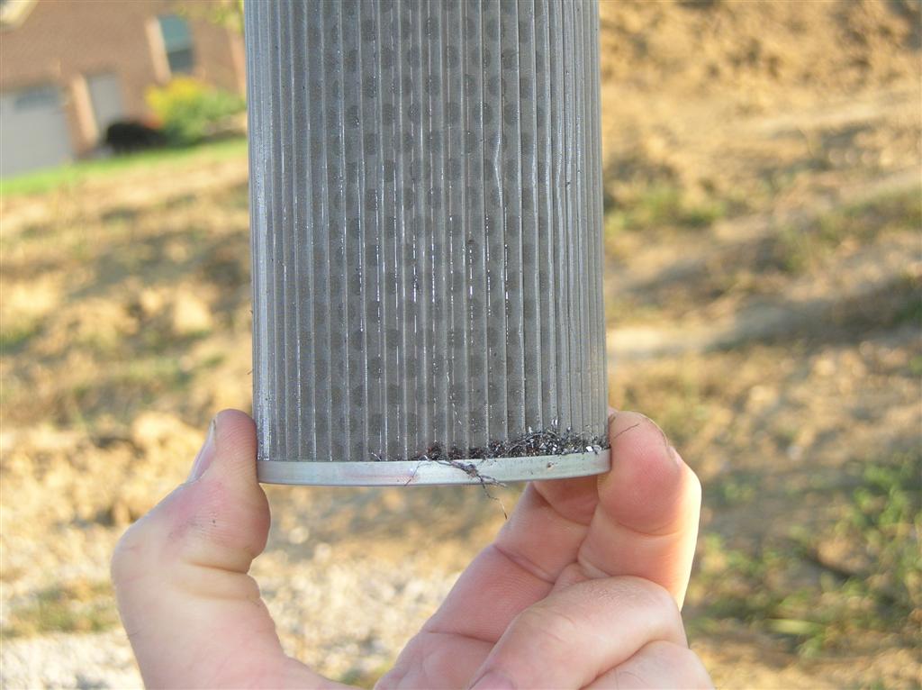

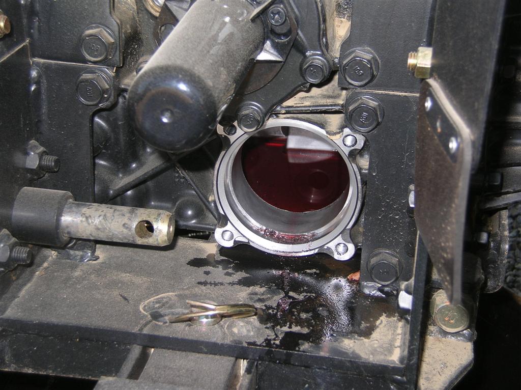

/ 2320 Hydro Oil Change #4
Here are two pictures showing what greeted me when I did my first hydraulic oil change. Make sure you clean out the oil sump. I found a lot of shavings in there. If you do clean the sump, just make sure you don't leave any lint behind or any other contaminants.
I can agree with everything thatguy said with the exception of one small little thing. I saw oil in my sight glass right away as I was filling.

BigD9, Thanks for the pics, that is pretty much exactly what I found in mine. Does anyone know if you have to space the magnets out or if you can put them back in stuck together. When I tore it apart they were all together so that is how I put them back in. Also does it matter if they are at the top or bottom in relation to the filter when it is reinstalled?
My personal opinion is it does not matter at all, however that said I did space them around the filter housing. Also those magnet bars are fragile and break when striking a concrete floor after slipping from someones fumble fingers. :(Enough said.
