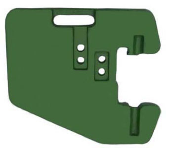

hi i have a 2009 2305 got it yesterday, dose any one no wherei can buy front weights. and what would be a good weight for my 2305 i have a 4 foot bushhog and a 5''tiller that i will be using.

I assume you know that the dealer sells them. I think they are 42 lbs. ea. and about $35.
   / 2305 #3
I think they are a little more now-like $42 or a buck a pound. The 2305 will hold 5 of them IIRC. They are called "suitcase weights" They look simular to this:

hi i have a 2009 2305 got it yesterday, does any one no where i can buy front weights. and
What would be a good weight for my 2305?
I use a front blade to counter balance a 4' tiller on this tractor. .
