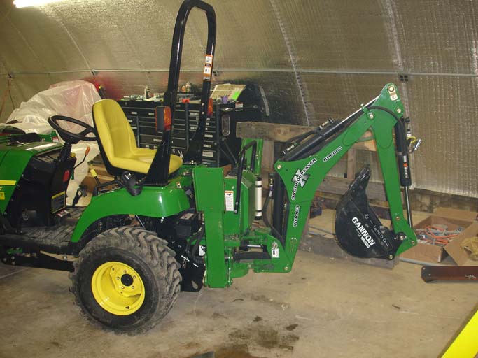

Will you be able to use that BH any during the winter, or is it going to wait till spring thaw to get a workout? Did the addition setup for the seat raise you up close to hitting your head on the ROPS? I assume also, that you have to rotate the seat before you climb in to use the BH.
/ 2305/ Woods BH6000 Backhoe Update
#28
I dug a little inside one of my buildings today. I need to install a floor drain before preparing for concrete. Our temperature today is about 15 degrees. We were at -2 degrees last night so the ground is frozen even inside this building. I was able to get down about a foot in 5 minutes. Basically just a waste of time, but I want to try it.
The seat does go up then rotate. It may be slightly higher in the normal position too since the bracket is now taller. I didn't notice any difference while plowing snow today. It is comfortable in the backhoe position as well. I'm very satisfied to this point with fit, on/off, and overall quality. The one thing I really don't know about is the most important part: Digging ability.

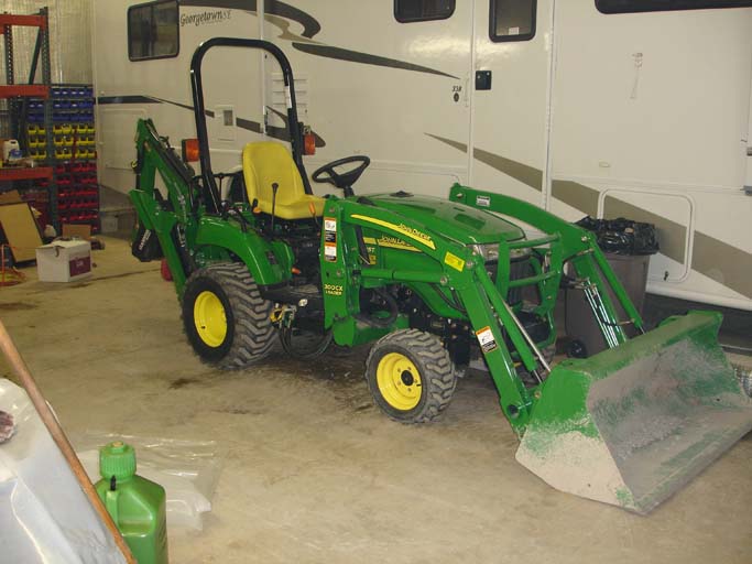

I have a 2210 with the woods hoe. The pressure and flow are good. Most movements are best operated one at a time, but the speed is good for the size of hoe. The controls are somewhat easy to learn and with practice you'll have it down quickly. Second time at the controls, I dug two ditches for drain pipe, each ditch was about 10' long, 30" deep, 12" wide. It took about 45 minutes to dig both. Certainly a time and lower back saver over a shovel. I have about 10 projects planned for the hoe (more with neighbors/friends requests).
#32
I'm glad to hear that. I noticed movement seems good using 1 control at a time. What RPM do you run at? It seems to move quickly even just above idle.
/ 2305/ Woods BH6000 Backhoe Update #33
Usually 2500. As needed I'll feather the controls to reduce the boom or swing speed.

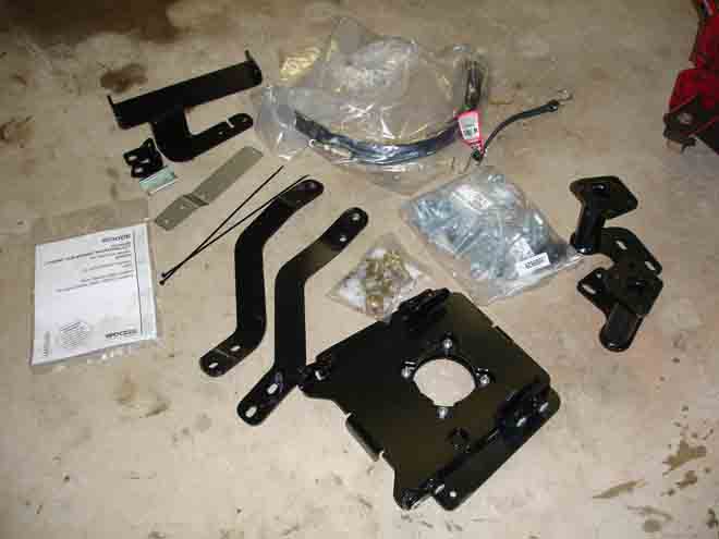

What are the part number(s) to the seat swivel bracket(s)? I may install that part on my 2210. Currently I have two seats, one for the tractor and one for the hoe.
#34
Seat Assembly Listed Only as Pieces.....#'s are
1# 1009649 Retainer Ring
1# 1008307 Seat Lift Link
1# 1008374 External Retaining Ring, .375
1# 1016552 Tractor Seat Bracket
1# 1016555 Seat Mount Plate
1# 1016561 Lift Bracket
2# 5/16 NC x 3/4 HHCS GR5
2# 5/16 Lock Washer
2# 5/16 Flat Washer
1# 3/8 NC x 1-1/2 HHCS GR5
1# 3/8 NC Locknut
