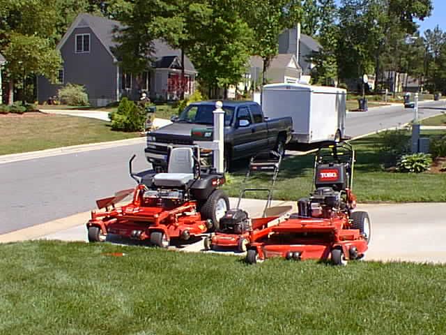

Give the ATOMIC'S a try. Very similar to Gators. I run them on all my mowers (TORO). They work good in wet grass also.
