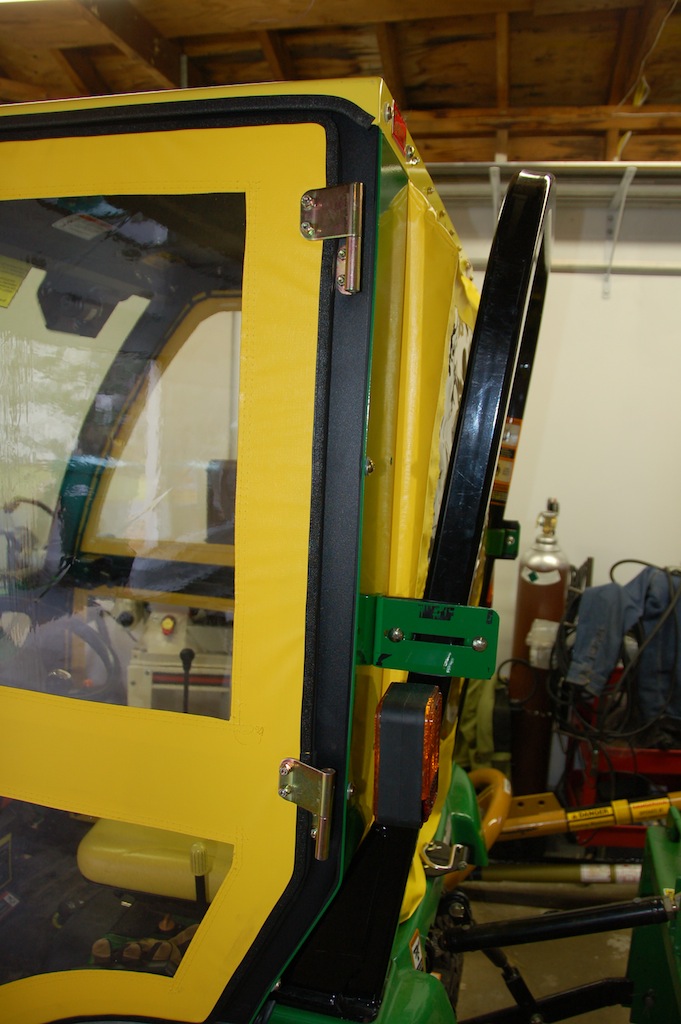

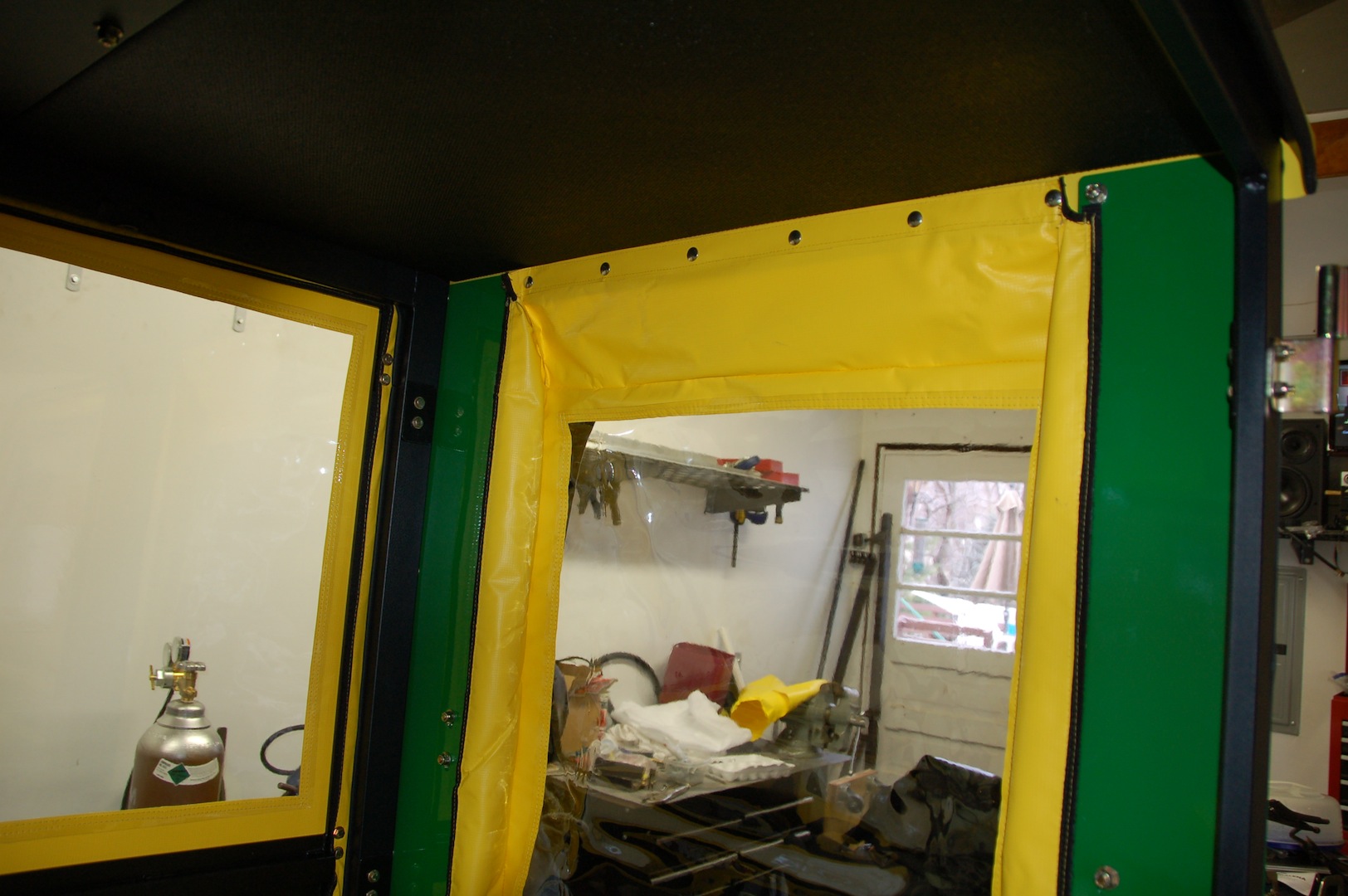

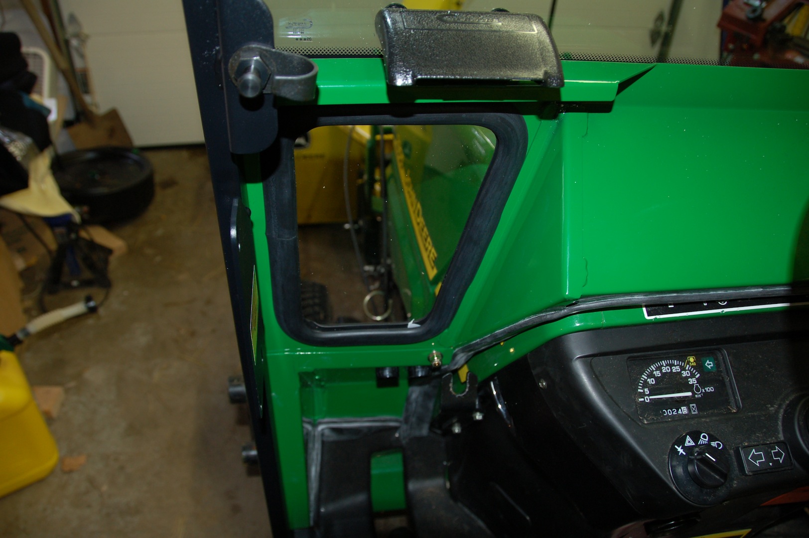

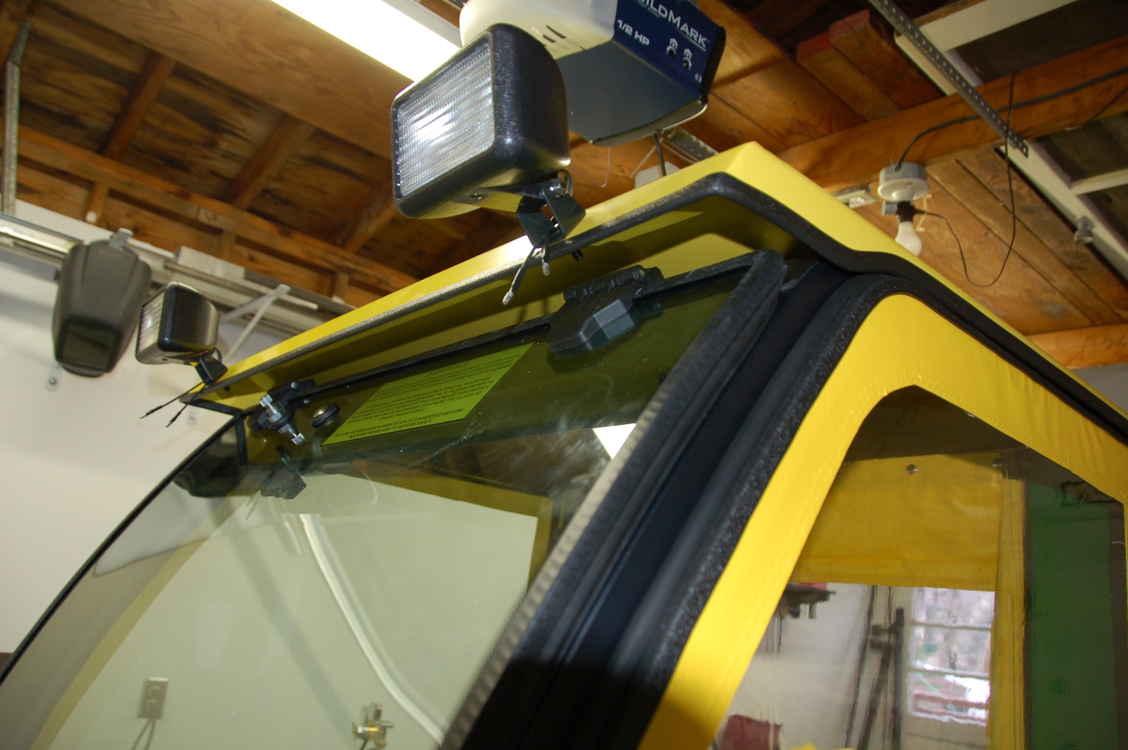

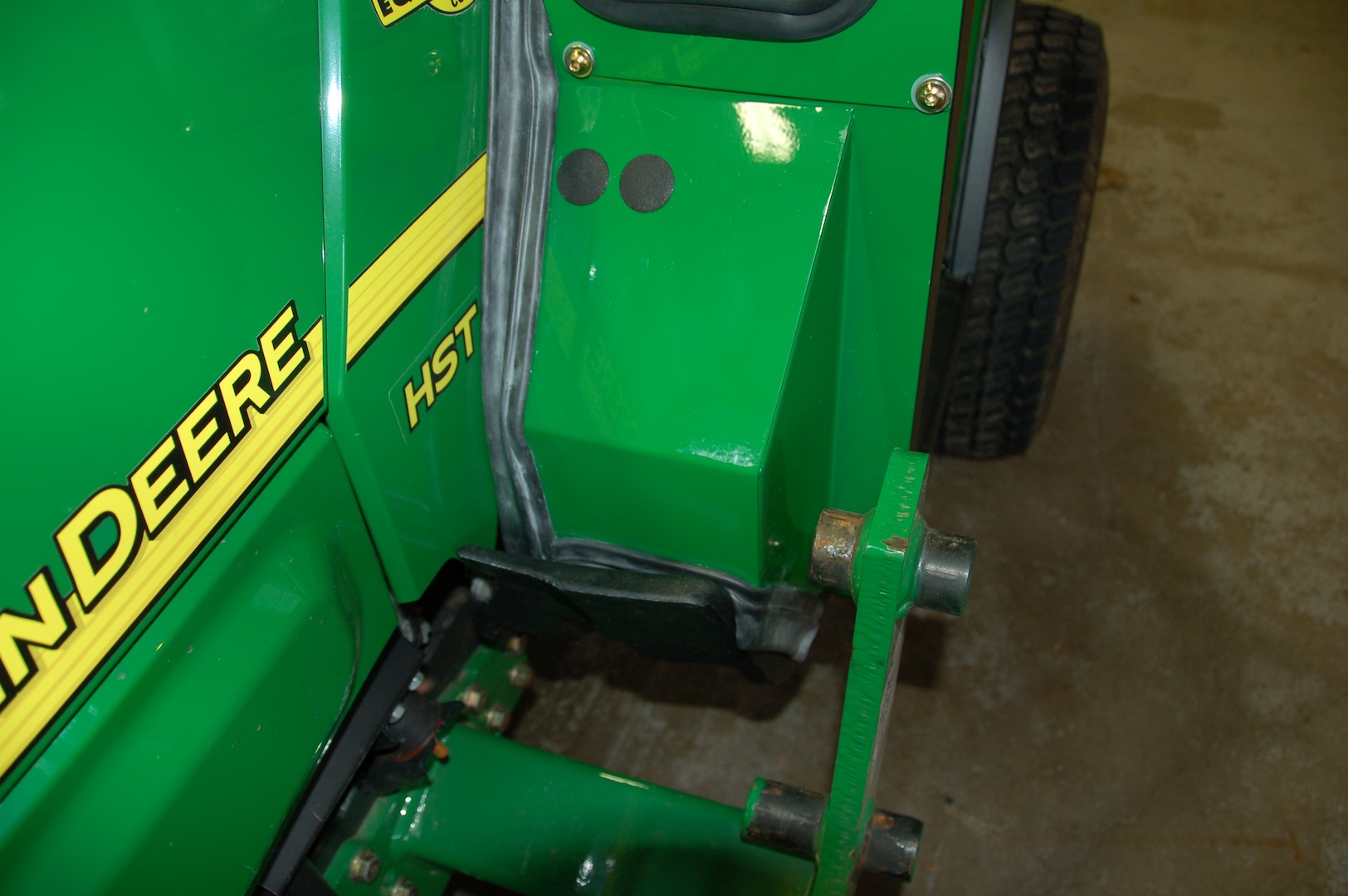

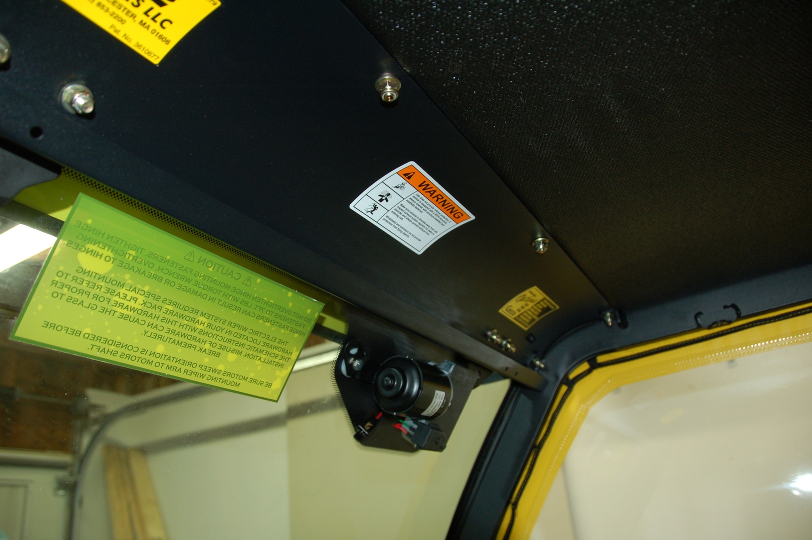

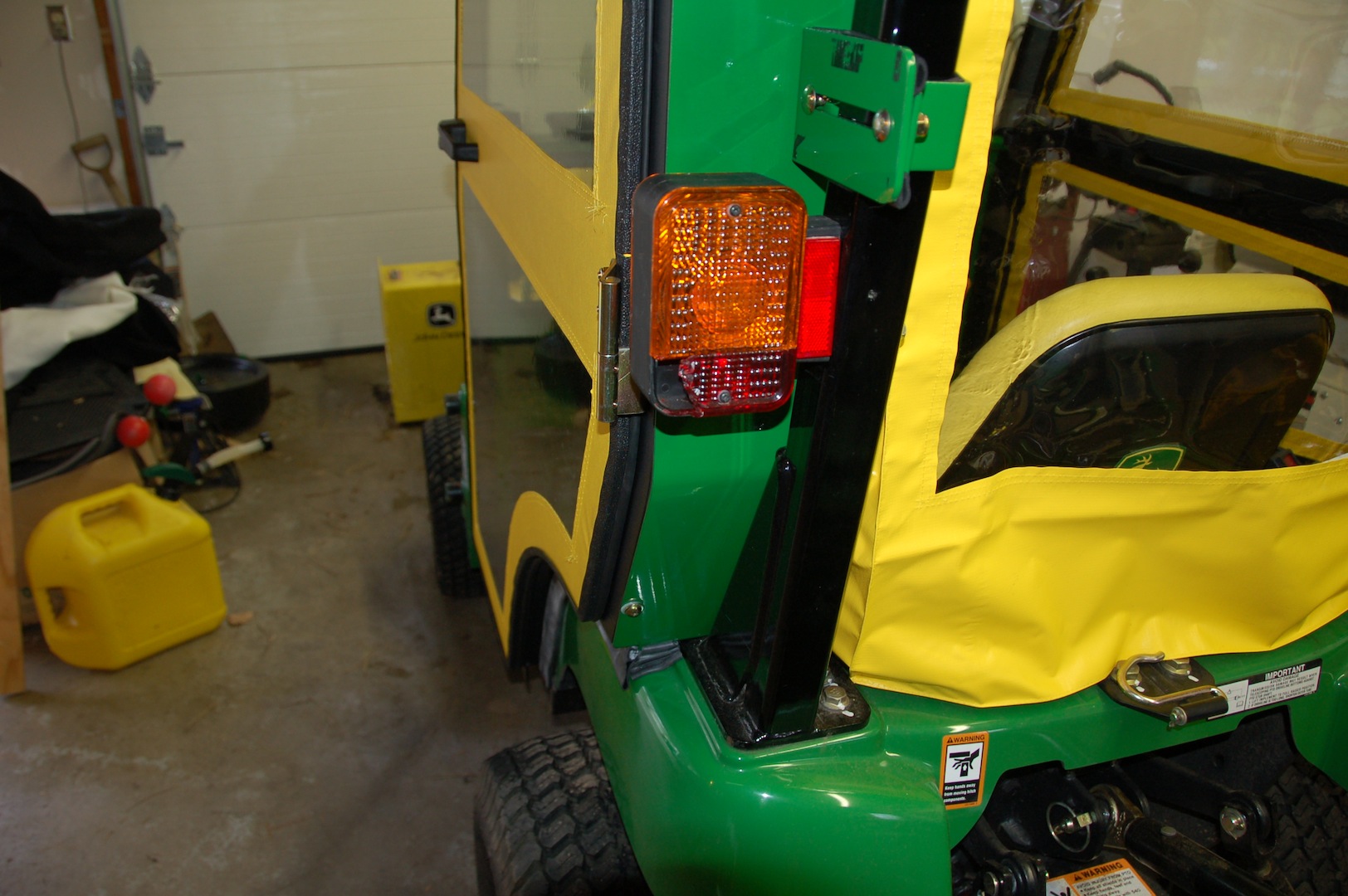

The pics I wish I had when deciding to purchase, and then installing, a soft side cab on my 2305.
Note that I'm not saying I installed everything correctly, and I'm not quite done.
Hope they help others.

Looks like you have done a great job putting it together. Looks just like mine except I didn't see a heater. I suspect it is coming, typically would install a cab without a heater, especially where you are, you get the Lake Effect goodies like we do here.......
/ 2305 Curtis Cab Install #3
Looks like you did a nice install I agree about need of heater....I'm so glad I found one in put in the Original Cab . Even when I had the Golf Cart Heater it was better than nothing when outside temp around 0 or below.
Enjoy
Have fun and be safe!!

Thanks! Yes, heater's coming hopefully. It was either not shipped, or lost in transit.

Nice installation, you will wonder how you did without it.

I had to grind a small notch in the panel of the cab to route the chute cable through.

Nice job. they arent difficult to put together, just awkward at times. S second set of hands is often helpful. I dont know know how I was able to survive before getting mine. :D

Looks great. I was told by the JD dealer that the cab greatly reduces the entrance area. Is that true?
#9
Do you mean it's hard to get in and out of there? I don't think so, and I'm a big guy. I can measure the openings if you like.
/ 2305 Curtis Cab Install #10
I dont think that's true. I'm 6'4" 250+ and have no problems with mine. The only complaint I have is I have to adjust the seat up just a little more forward with the cab. But the benefits of the cab far out weigh this nit.
