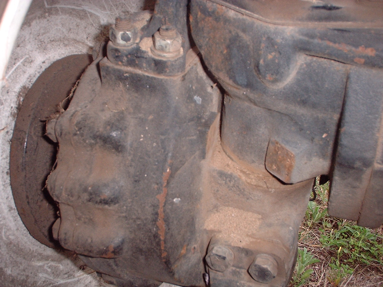

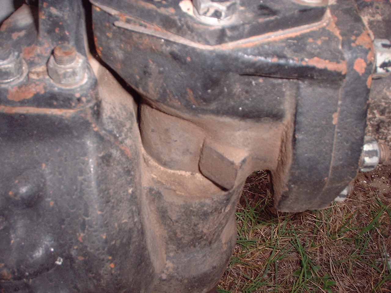

/ 224 steering question.
#13
well look at this. One pic taken on right side, one on left side. (as I am in drivers seat)..you see an obvious stop on the left wheel casting, but look at the right, (the one that goes whacky)...you see no stop present on the casting. So it makes me wonder if that "stop" on the wheel housing is actually a welded on piece of metal. Cause if it is, then somebody missed mine....
Tomorrow I will get the front end off the ground and rotate on the axis to see if I am right.

/ 224 steering question. #14
Not much chance of those stop bosses being welded on - those are castings, not forgings and would not respond well to welding (think, big cracks).
