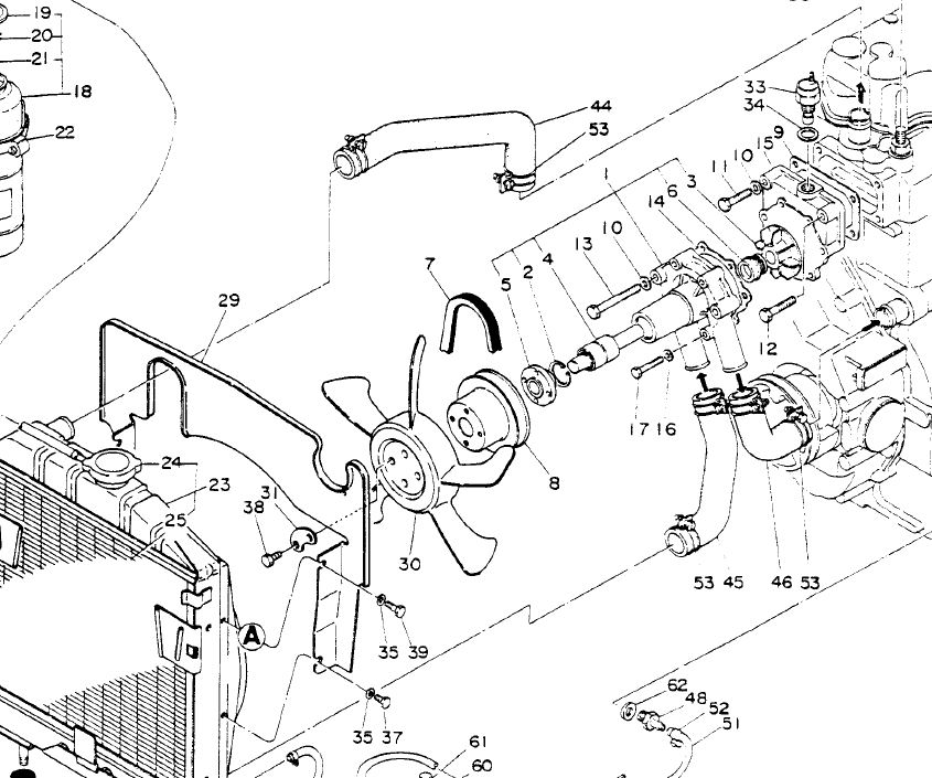

Hi everyone! It痴 been a long time since I致e posted here. I致e started to use my 2210D more often again, and decided to revamp the cooling system.
Acid washed the radiator, replacing the fan, belt, all of the hoses and water pump.
Got the new pump in, and for the life of me cannot remember which hose goes to which outlet coming from the water pump!!!! The hoses are a little different from the original ones that were on it. The new ones fit a little awkwardly. So they don稚 look right To me either way I Run the two hoses coming from the pump....
Can anyone tell me which of the two pump outlets goes to the engine, and which goes to to the radiator, looking at it from the left side of the tractor?
Thanks in advance for your help!
Steve

Do you still have the old hoses? They have probably taken a set, and laying them along their paths will tell.
Otherwise, a water pump always pulls from the bottom of the radiator and the return from the block goes into the top.

There are *two* outlets from the bottom of the pump: one goes back to the engine, the other to the bottom of the radiator.
Just want to make sure I don稚 make a critical mistake, which would require taking everything back apart to remedy!😳😈

Hope this helps.
   / 2210D Water pump to engine?!
That痴 what I needed! Thanks for all the parts, and thanks for that diagram.
