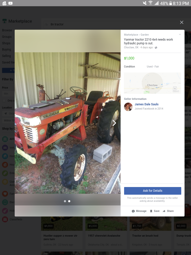

I found a 2210d for sale in my area. Its listed as in fair condition. I've message the seller with a bunch of questions since his post wasnt detailed. He just has "it needs woork, hydraulic pump is out". It looks all original, paint faded and not like the refurbished ones you see trying to pass off as nearly new. From reading up here and at hoye, it's obvious that the 2210d is a highly regarded tractor, rightfully so. And obviously I'd need to go look it over thoroughly. But how many more things wrong will it take before it is a bad deal? Oh and it looks like it has the brackets for a front loader, but doesn't have a front loader in the pic...definitely one of my questions I asked.*

If all it needs is a hydraulic pump , it is a good deal. I can supplya hydraulic pump. new or used.
   / 2210d for $1000....what do you think? #4
don't know your abilities. But i would buy it for $1000 if it was me. The pump usually does not go out , so we have been told by so many folks on hear including dealers. But they do go out, they just are not worked that hard, the pumps that is, to wear out, esp on a tractor that does not have a loader.
Make sure that its not the small pump that powers the clutches or what ever in on that tractor to make the transmission work as that is more detailed and far less knowledge will be avialible for that and not sure what internal trans parts may or may not be available.
Edit: now that i zoomed in on the pic i see a loader frame. THey may have just disconnected the loader lines and not looped them and deadheaded the pump to shear it off. This would make more sense than it wearing out, but again its a mechanical part and can fail.

i also think the front tires are reversed to get the width wider, they should be the other way that puts excess strain on the steering joints and bearings up there

Another thing to consider is that the key on hydraulic pump shaft may be sheared. I had a customer bring me a tractor that the JD dealer had for a month & couldn't figure out why it didn't pump any oil. When I saw they had dead headed the hydraulic line, the light bulb flashed. Broken key! We didn't even bother to unload the tractor from the trailer.
