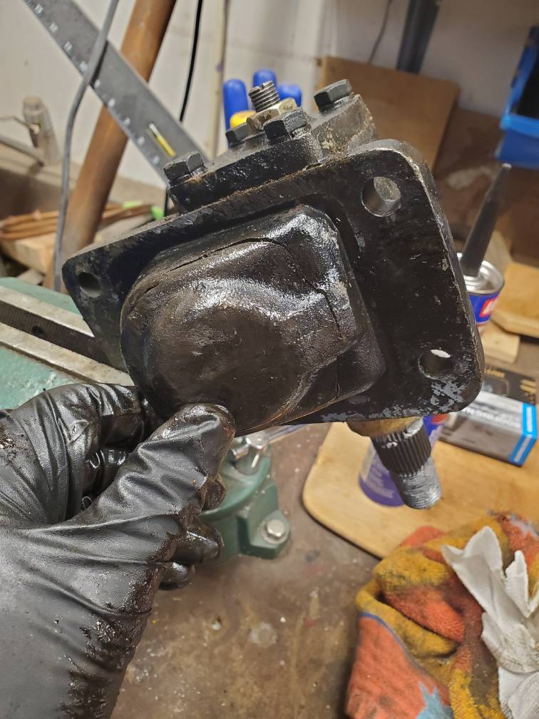

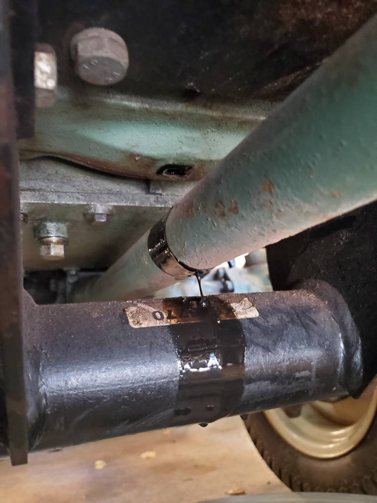

Went to neighbors to move a little dirt. Wound out over turning wheels and busting the steering box. Drove home (1/4-1/3 mile) using the brakes and a few manual adjustments to keep straight. Got home to find oil pouring from bell housing!

Ok...oil is going to be from steering gear box. Phew.

what you did was not the cause of this, you can't break a steering box by overturning the wheels.. it must have had a crack forming already, and you opened it up. it probably had a defect, or you hit something previously..
/ 2210 steering turned serious #4
Todd doubtful overextending the range of the steering box would do this (although like some much something's gotta give at times) These tractors are pretty old and I'm guessing the box is cast and may have had weakness in it from the beginning that time and vibration opened. I believe overextending damage is usually more related to the gears. and that certainly wouldn't do this. If it were me I'd start removing the things you need to get it off and examine it carefully. If it truly is a crack in the box itself and the internals are fine I'm thinking a good machine shop could repair for you.

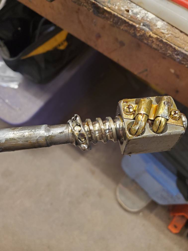

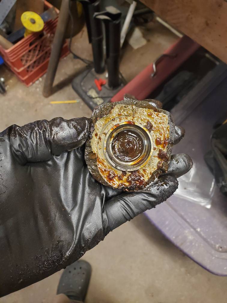

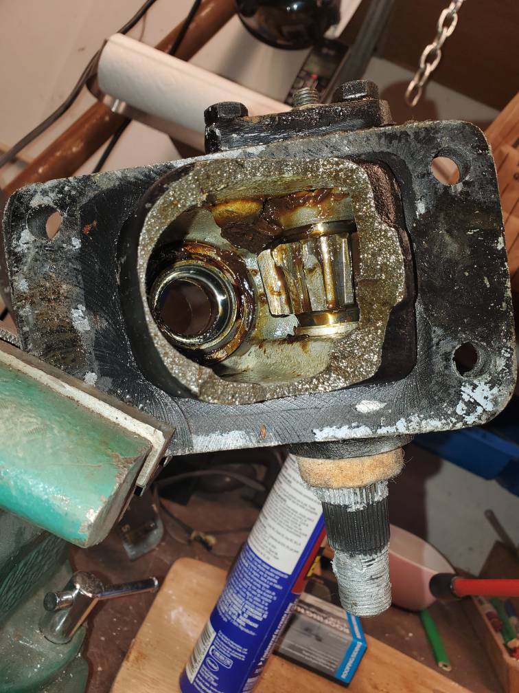

I shoulda just bought the bearings and seals used my old gear box.20200908_210006.jpg20200908_210128.jpg20200908_210302.jpg

Recap:
I blew the bottom out of the bolt on steering kit.
I purchased the rebuild kit, includes steering shaft, to rebuild my original steering box.
(Side note. The aftermarket steering box is quite different than the original)
I am hoping that i could return the steering shaft to Hoye as i would like to use my original with new bearings and seals...
Now i am unsure. Original shat is split. One of the tests Hoye shows in their videos is testing the shaft for endplay in and out. See the problem i am going to have?20200916_175358.jpg
