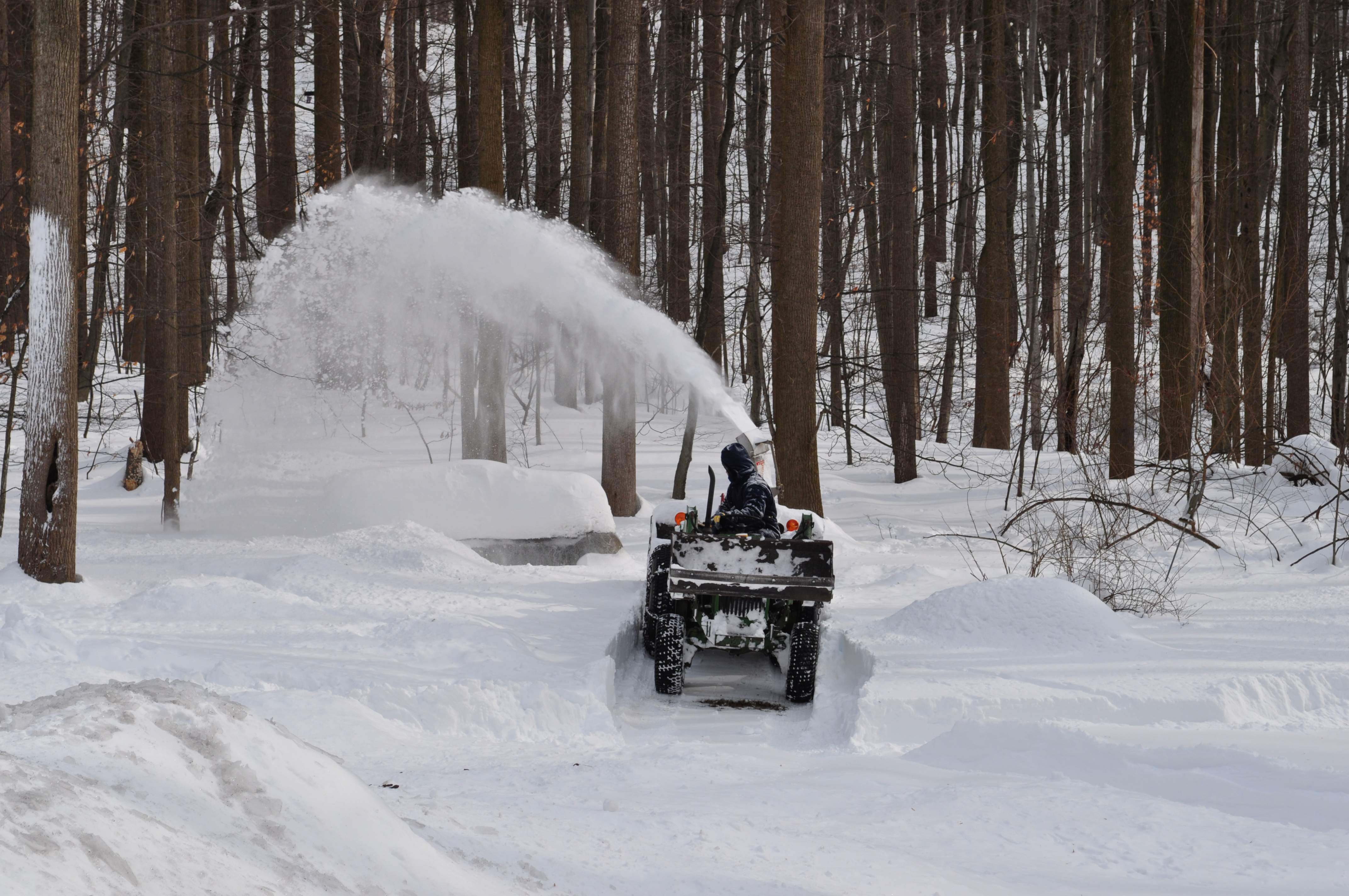

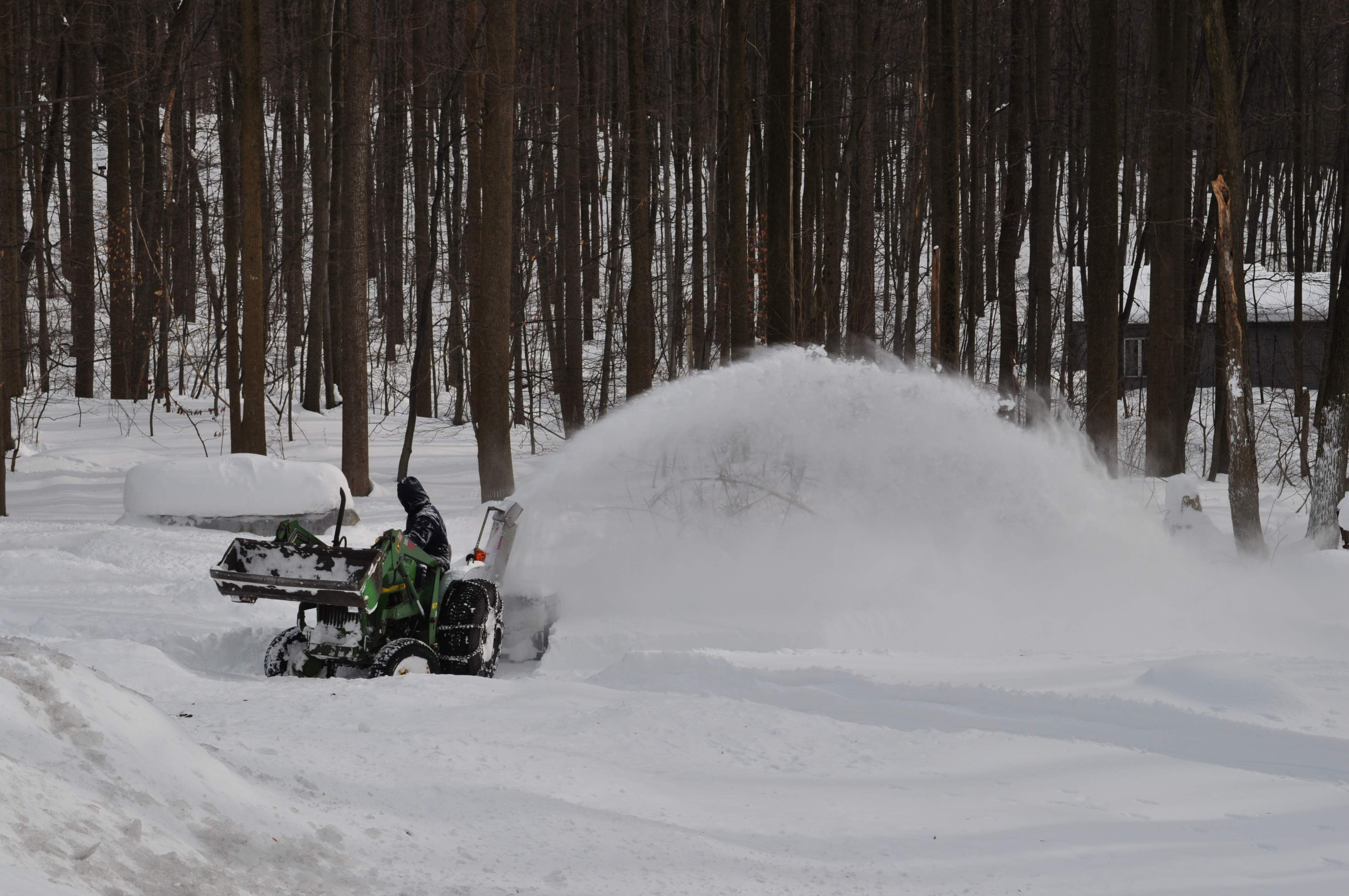

For what it is worth I had a JD tractor with 18HP at the PTO and an Inland 60" snow blower that performed flawlessly over the years. I can't imagine 1 less HP will making that big of a difference.
