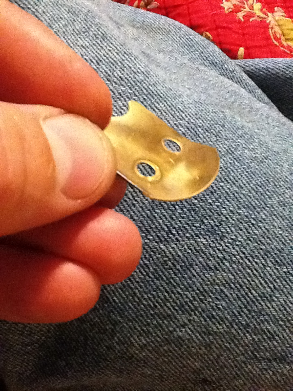

Aha. The choke plate was stuck closed. It appears that the black plastic spring holder has a piece broken off of it. The choke plate got jammed and bent. Anyone suppose I can replace just this spring holder?

Aha!!

New choke repair kit, $20. Starts like a charm! Choke lever still slips out a bit over time. But it runs great with the occasional Push off of the choke lever...
