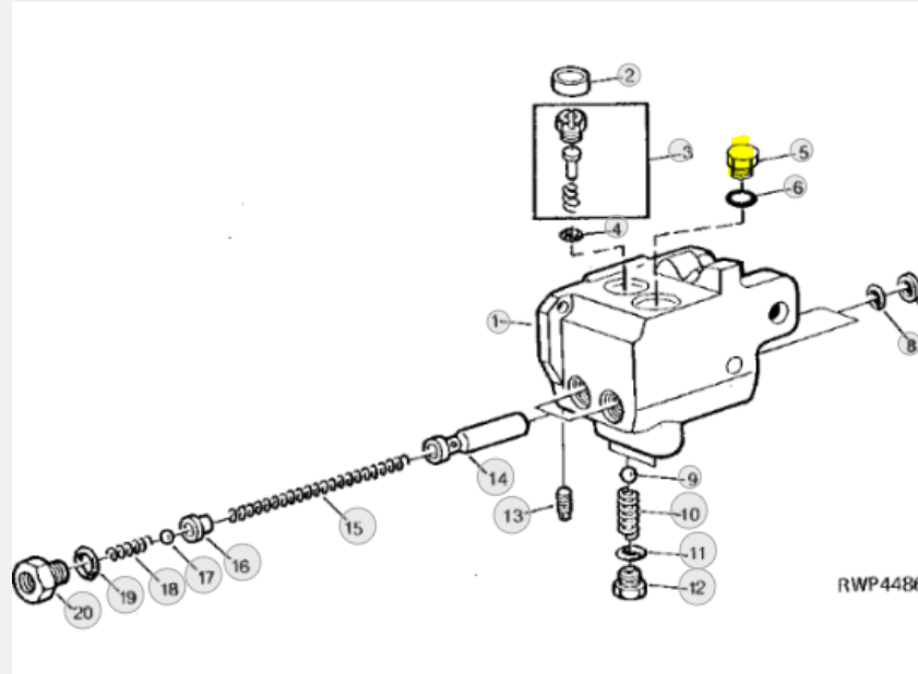

I am with TxJim, try and push the grease out by bleeding the brakes. If you do not want to run the tractor while bleeding the brakes, you can remove plug 5 and fill after about ten pedal pushes. Also do not allow the pedal to "snap back" or you could damage the brake valve.
Any idea how much grease was pumped in?
Over time, I think the grease that does not come out by bleeding the brakes will dissolve, after all grease is used to hold packings and o rings in place during assembly.

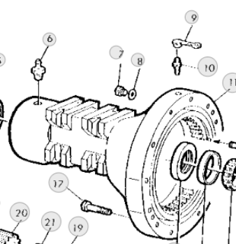

What part in the schematic is the bleeder?
