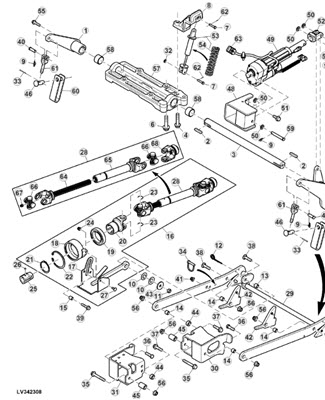

One possible disadvantage of the Gen2 2-series (2032R/2038R) can be the Command Cut control mechanism for the mid-mount mower. It is a very complex computer controlled linear actuator mechanism that is quite prone to failure and the replacement actuator alone is $1200. There have already been quite a few reported failures. While this may not be a big deal while the tractor is still under warranty, eventually that warranty will run out. I still don't understand why JD made something as simple as a deck lift mechanism so complicated.
The diagram below shows just the rear section of the auto-connect / lift mechanism.

I was intrigued by that system but there was no tractor on the lot with a MMM installed so I did not get to see it.
Sounds great on paper, though.

I've never had a small tractor with an auto connect deck so am unfamiliar with the compromises associated with such. How long does it take you to install and remove the auto connect deck used with your 2025R, assuming a good concrete floor? Are there compromises associated with the auto connect system, e.g., ground clearance, etc?

I would say there is no compromise with the auto connect. When I owned a Kubota BX I avoided taking the deck off, even though sometimes I should have doing end loader work. With the JD I would say the deck goes on and comes off in less than 5 minutes. Its not hands free, there are two pins to pull and two latches to trip, but they are an easy reach. Its a very slick system. It actually works better on a rough surface, if the surface is two slick, the deck just slides instead of going on or off.

I have a 2038r with the quick connect mower, so far no problems and my dealer has not had any failures of the actuator yet. As others have stated change the deck on rough ground/grass or as I do put 3 pieces of rubber mat under the deck if taking off on pavement. By far this is my favorite tractor, a great combination of compact size, good weight for traction and good lifting power.
