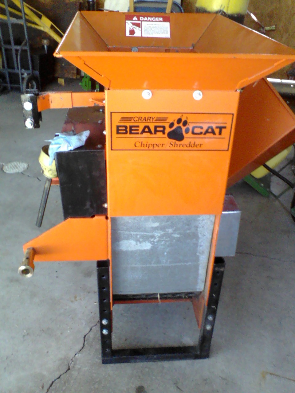

That is how my jd 2720 pto works. It starts my 6" BearCat chipper shredder at an idle without laboring.

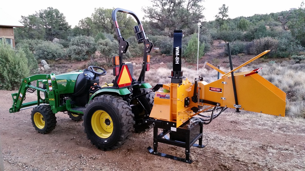

I finally finished putting the chipper together, running it for the first time today. Looks like 23.5 PTO HP can start a 200 lb rotor without a problem. I engaged it at idle (~ 1300 RPM). It definitely "lugged" briefly, but didn't miss a beat. I chipped a few small "sticks", maybe 1" to 1 1/2" diameter, and five feet long. Tomorrow I'm going at the big pile.
The 3-point lifts the 900+ lbs without a problem. Here's what it looks like hanging on the back of the tractor:
