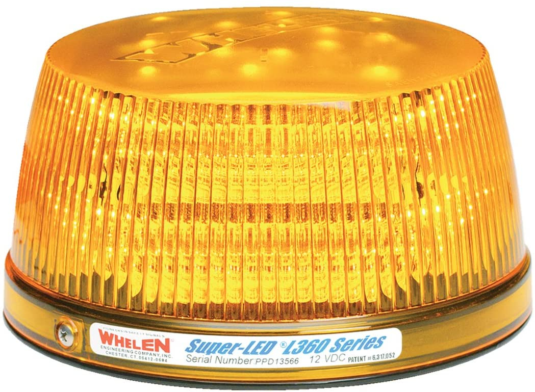

I have a 2032r. I'm looking for ideas on how to mount a round amber LED beacon light to my ROPS without welding or drilling holes, and still have the folding functional. I was looking to see what others have done. Attached is the style of light I'm going to be using.

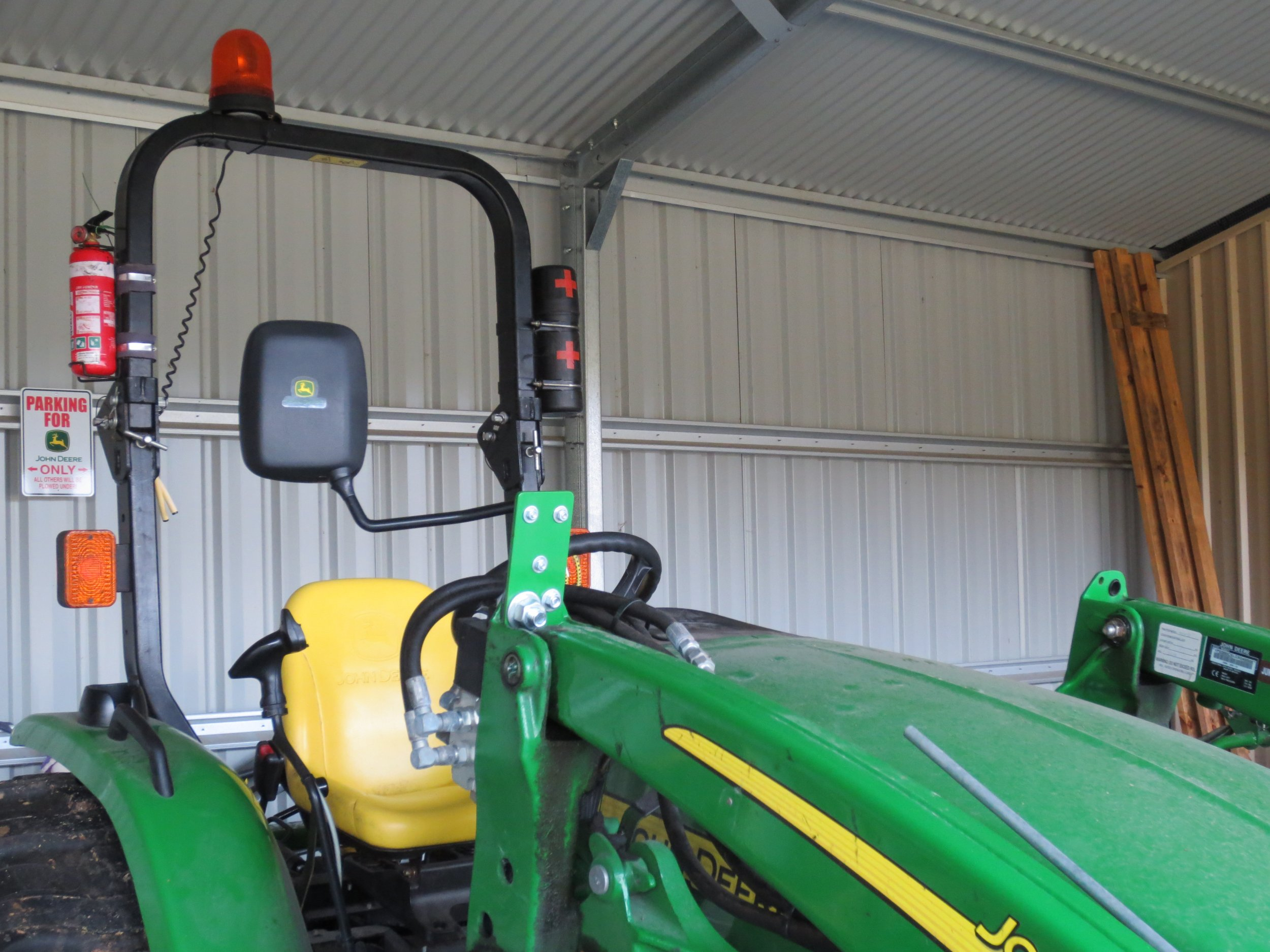

   / 2032r Amber Beacon Ideas #5
Hose clamps or industrial tie-wraps.mount it offset and below the top of the roll hoop. Trees & brush will knock it off. Maybe even your garage door.
That's how I mounted my magnetic bottom amber 'whoop whoop'. A few industrial tie-wraps (zip-ties) and it's been working fine for years.
Mine is mounted on the right side of the ROPS as we drive on the left over here. :)
The 'curly cord' gets plugged into a "cigarette" receptacle that I ran from the battery to the frame under the seat. I only plug it in when needed/required, otherwise the plug is 'tucked up' out of the way.

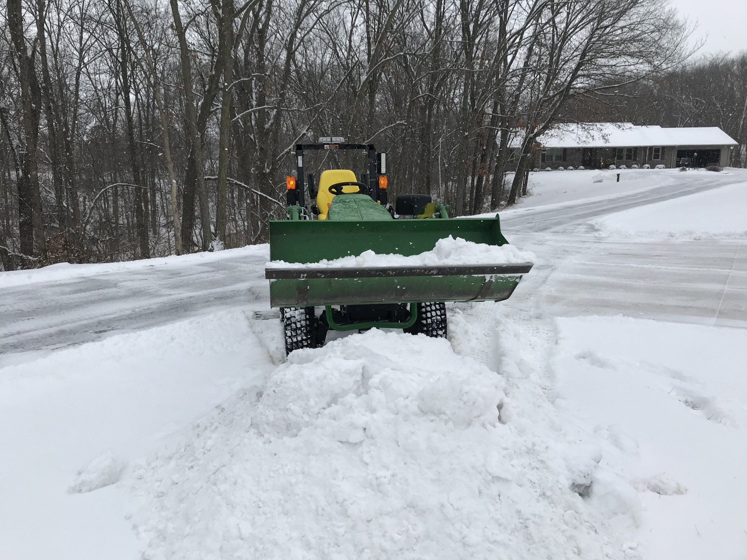

   / 2032r Amber Beacon Ideas #6
here is a pic of mine, a little hard to see, but the rops folded halfway. It’s a magnetic base and is attached pretty solid. The problem newer JD’s the rops leans forward and we need a bracket to level it with the rops up. I only use my beacon when moving snow or road so I lave the rops folded.

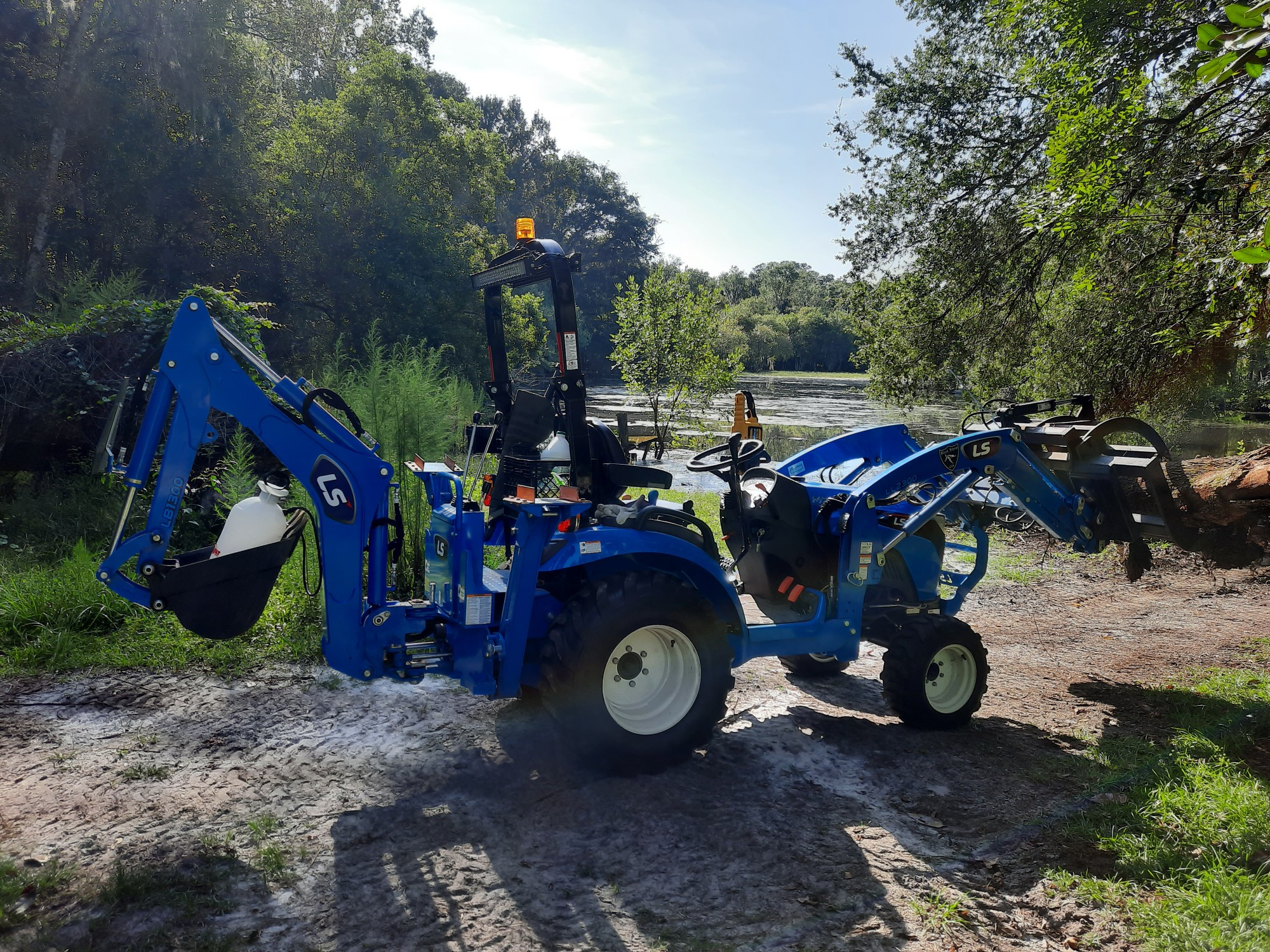

   / 2032r Amber Beacon Ideas #7

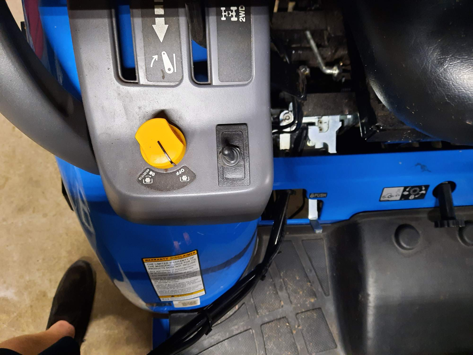

I just locked mine down with HD wire ties. I have to drop my ROPS every time I put my tractor away.
Put the water proof switch in a blank slot next to the yellow PTO switch.
