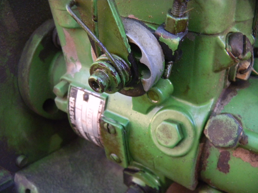

My JD 2030 USA built has a leak, diesel fuel, at the injection pump. It looks like at the "throttle" lever.

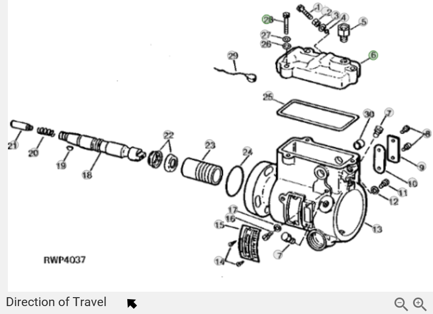

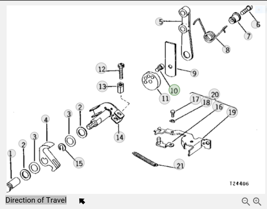

I looked at JD parts. From the drawings it looks like maybe the top cover has to come off (drawing 3) to remove the shaft to replace the shaft o-ring.(drawing 1)
I can't tell from the drawing how the shaft comes out, maybe clip key 15? . Or which parts are inside the housing. (drawing 2 that shows lever)
I do have the 2030 Tech Manual, but it only covers R&R of the injection pump. Nothing about taking it further apart.

R&R of throttle shaft seals is fairly simple after IP cover is removed. BE SURE TO TAKE NOTE of each location of each end of spring is attached
   / 2030 diesel leak injection pump #3
Yes #15 {clip} comes off & the 2 shafts can be pulled apart.
DRAIN the pump by removing/loosening the 2 screws on the side cover..
.. if your ordering parts, get the side cvr gasket too.
DONT drop the clip..
Its much easier to just get a gasket kit.. 24371.. than to try to find the throttle orings, sd cvr gasket & top cvr oring..
Good luck.

I can’t say yes or no.. you’ll have to make that call when you try to get the shaft out on the engine side..
The poster never came back to close out his thread..sorry.
   / 2030 diesel leak injection pump #6
Thanks for the input. Much appreciated. The leak only occurs when the engine is off and a very slow drip so I have some time. I have the parts in hand (o rings, side gasket, cover gasket) as of today so will work on it after haying is done.
