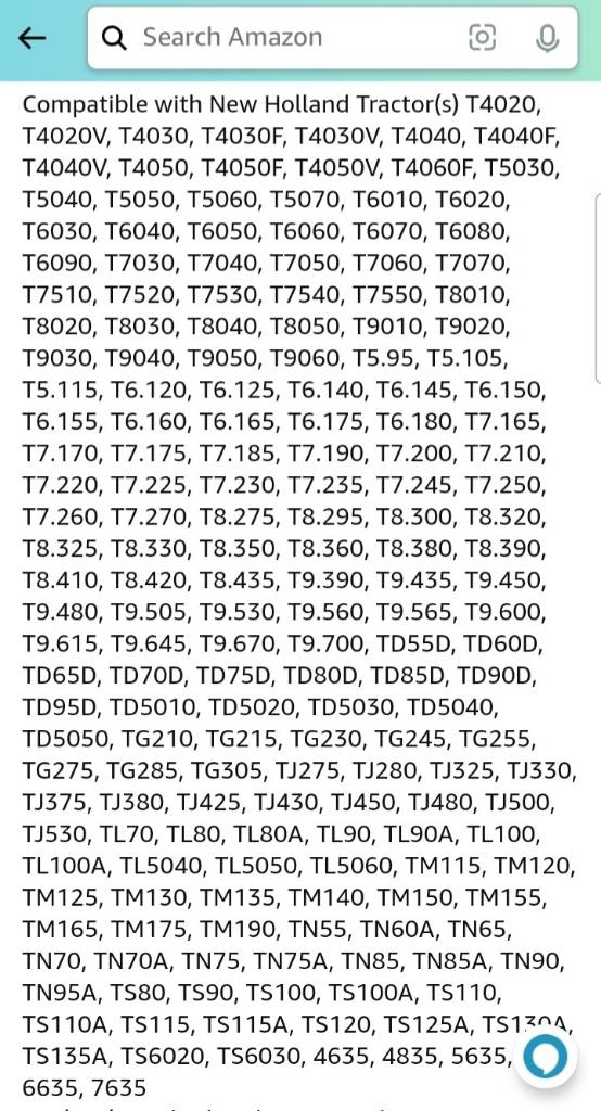

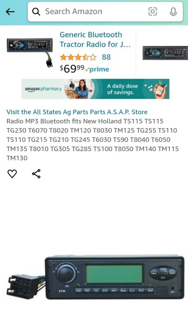

Maybe simply order this $70 one from Amazon and be done with it?
   / 2023 New Holland Radio Help
#13
Maybe simply order this $70 one from Amazon and be done with it?View attachment 819562View attachment 819563
Yeah, I'm kinda at that point now.
I will be putting a replacement radio in my Powerstar 75 to see how it does, as I have a couple of projects upcoming for that tractor that involves lots of hours, so it'll be nice to be able to tune into my regular stations.
Thanks!
