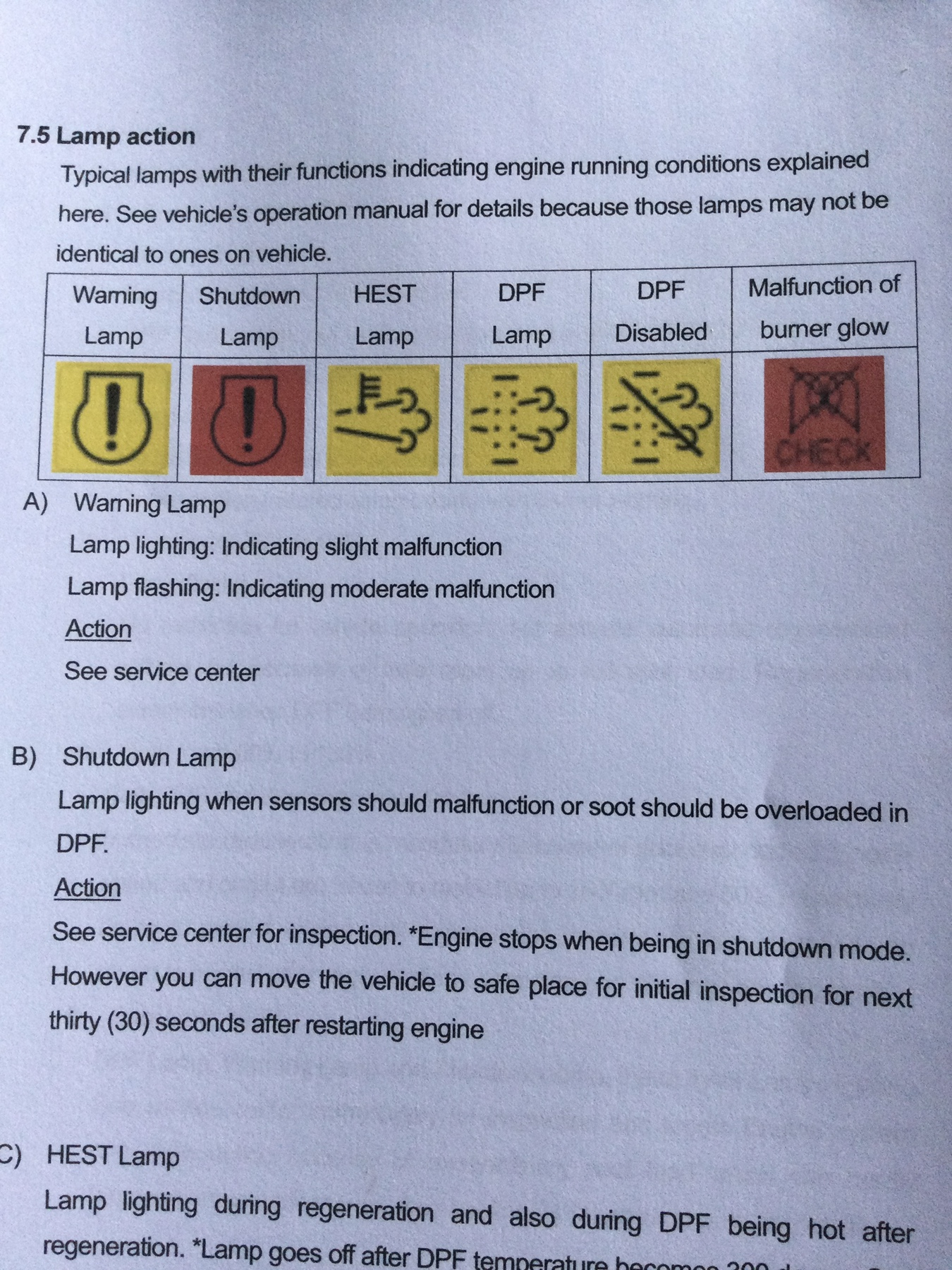

Look to see if the shutdown lamp is light. The 30 second run time could be a sign your tractor ECU is in shutdown mode due to a failed sensor or a soot overloaded DPF. See attached pic from the manual
   / 2019 NH Workmaster 33 - engine shuts off with throttle #6
That indicator light is on the far bottom left side of the instrument panel and it’s not very visible when lit during daylight.
