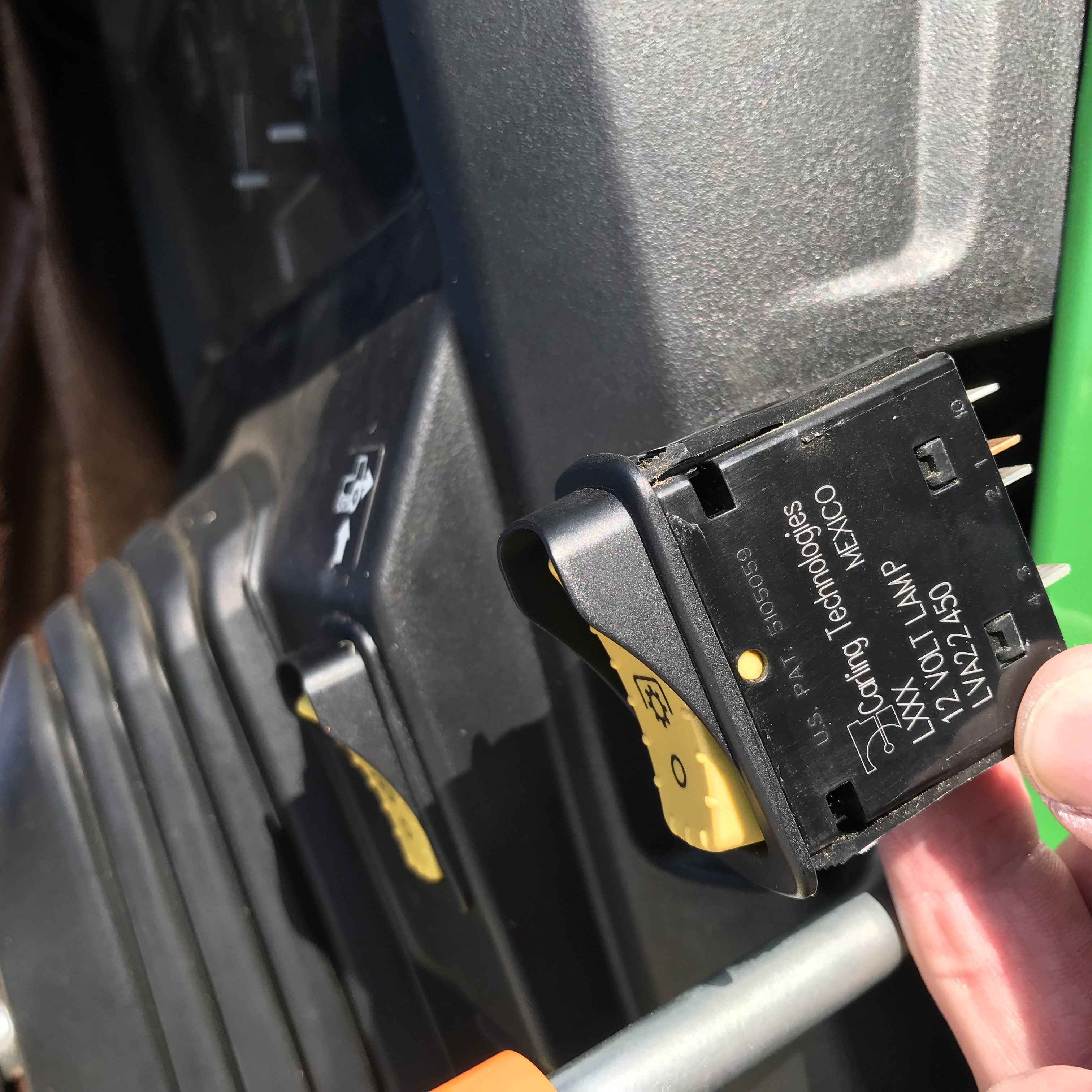

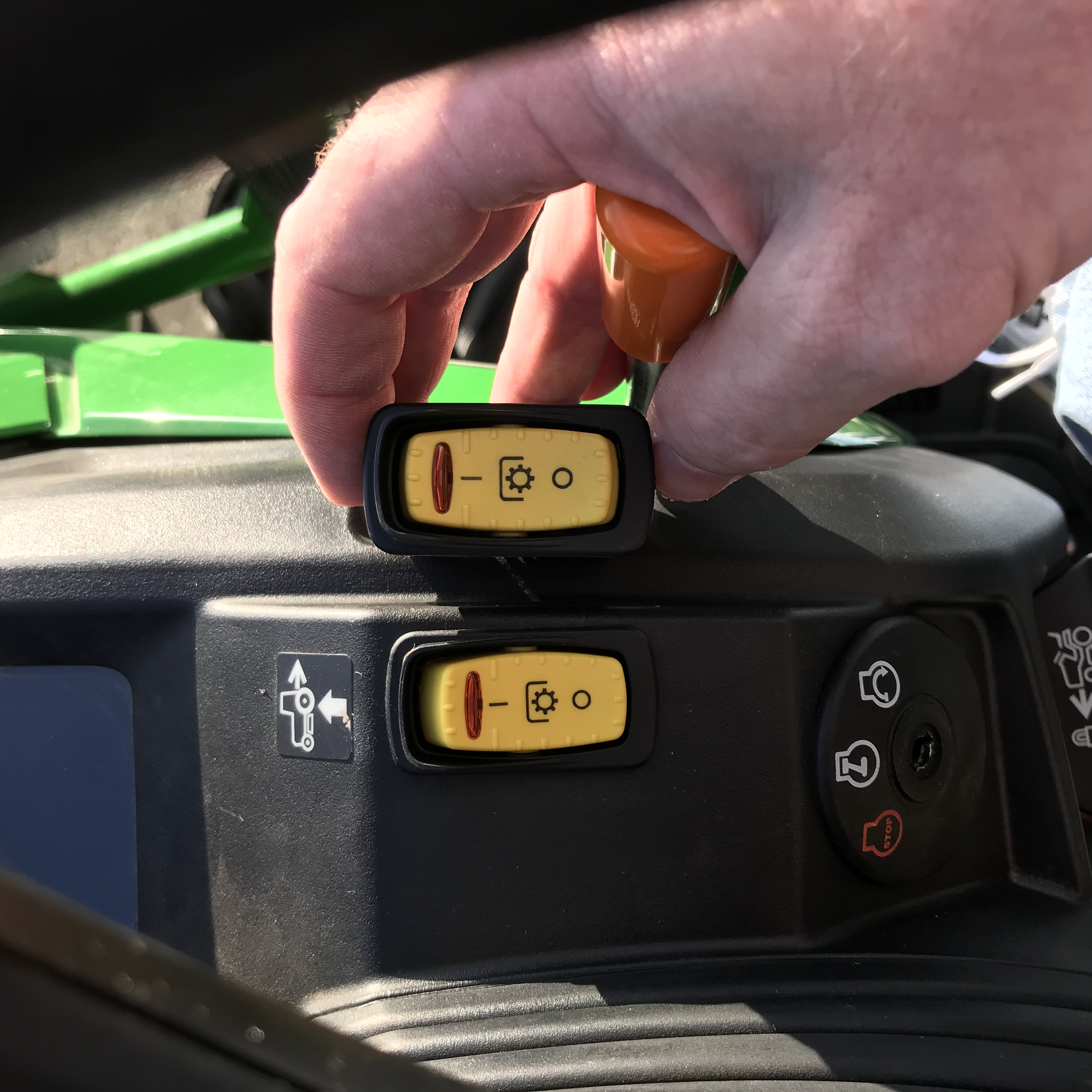

Well, I dropped by my John Deere Dealership today and they had a new PTO rocker switch for me. They had it shipped in from Atlanta over the weekend. Here is a couple of pics of the new switch installed and the old one taken out.
and a side view
I have to take the bad switch back to the dealer since it is bad and still under warranty. We just carefully slide the blade of a utility knife under the plastic surround of the switch and popped it out, unplugged in bad switch, plugged the new one into the receiving socket, and popped it back into the dash panel. A one minute fix.
