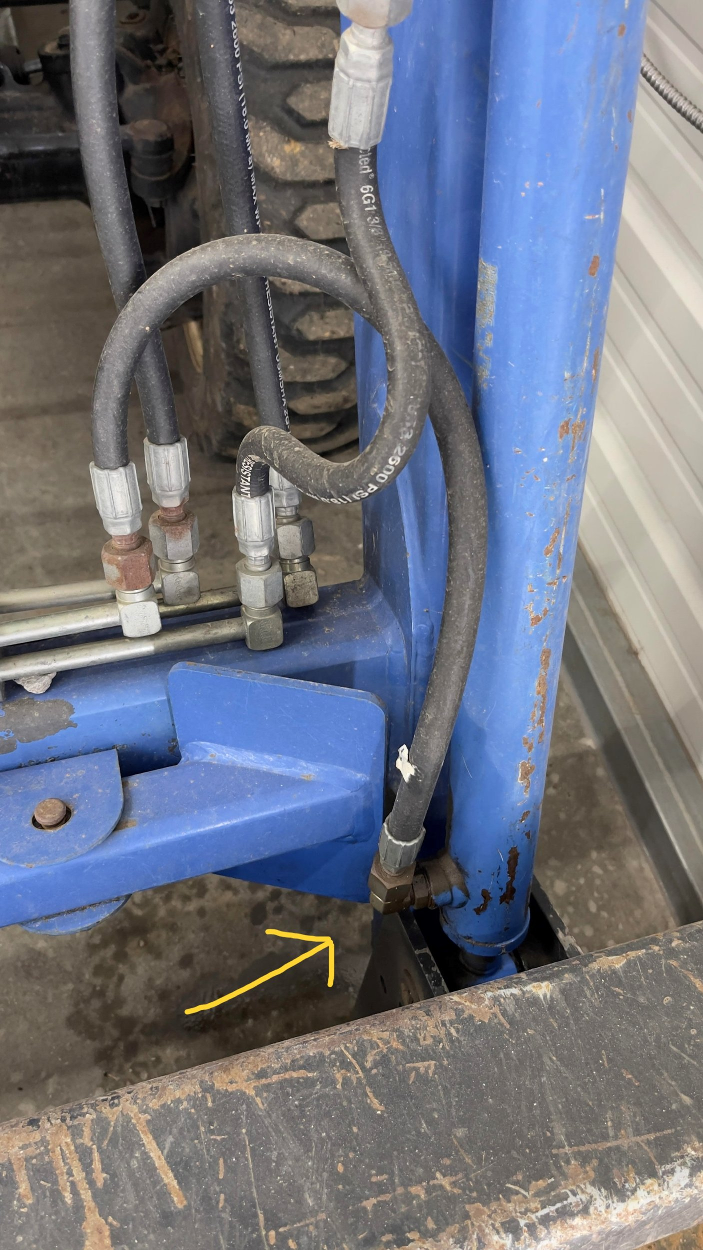

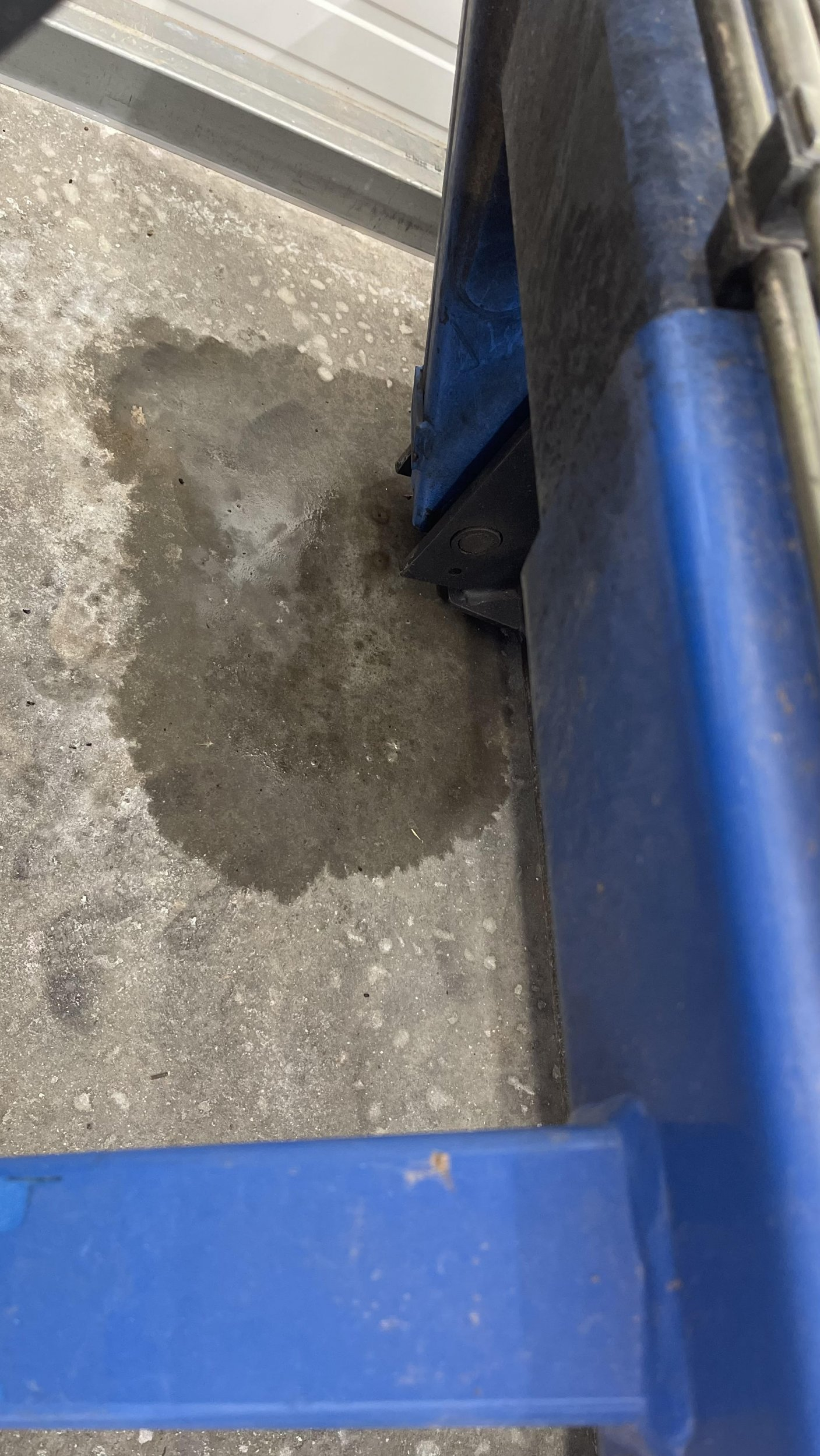

This is my first tractor, bought it used last year and everything has been great. Over the winter I went out to my property where it's stored indoors, and noticed a leak. This is the front end loader, on the left hand side (sitting in the seat). There are no signs of fluid running down the arms, just at the bottom where it's resting on the concrete. Any thoughts?

Went back today to take a look, it appears to be leaking from her (Yellow arrow) Is that an o-ring?
   / 2013 Workmaster 35 Leak near frontend loader #3
I don't believe there's an O ring in that type fitting. Try holding the lower fitting with a wrench while tightening the fitting on the hose a bit. Make sure the hose itself is dry and not leaking somewhere along the length of the hose and running down.
