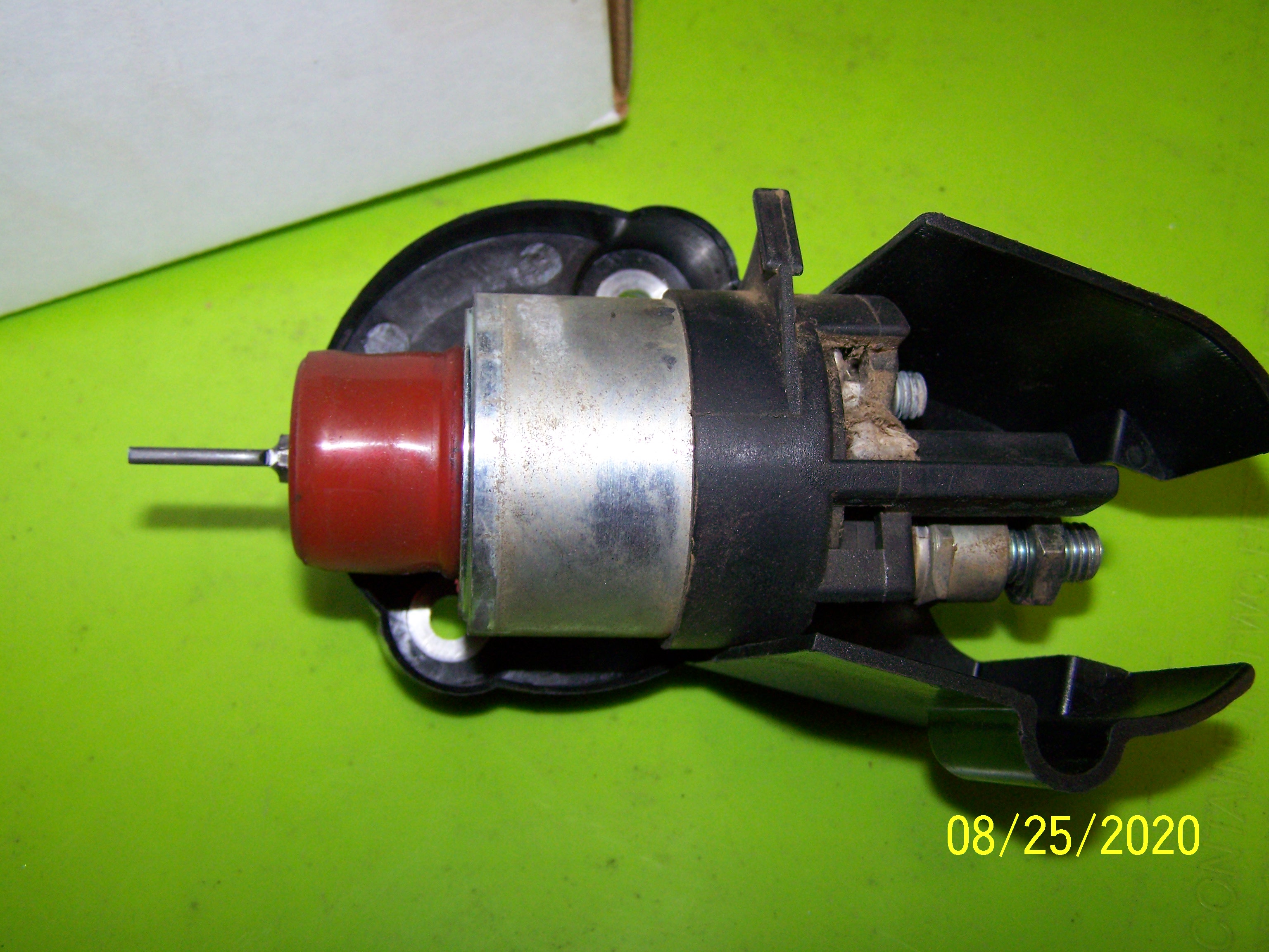

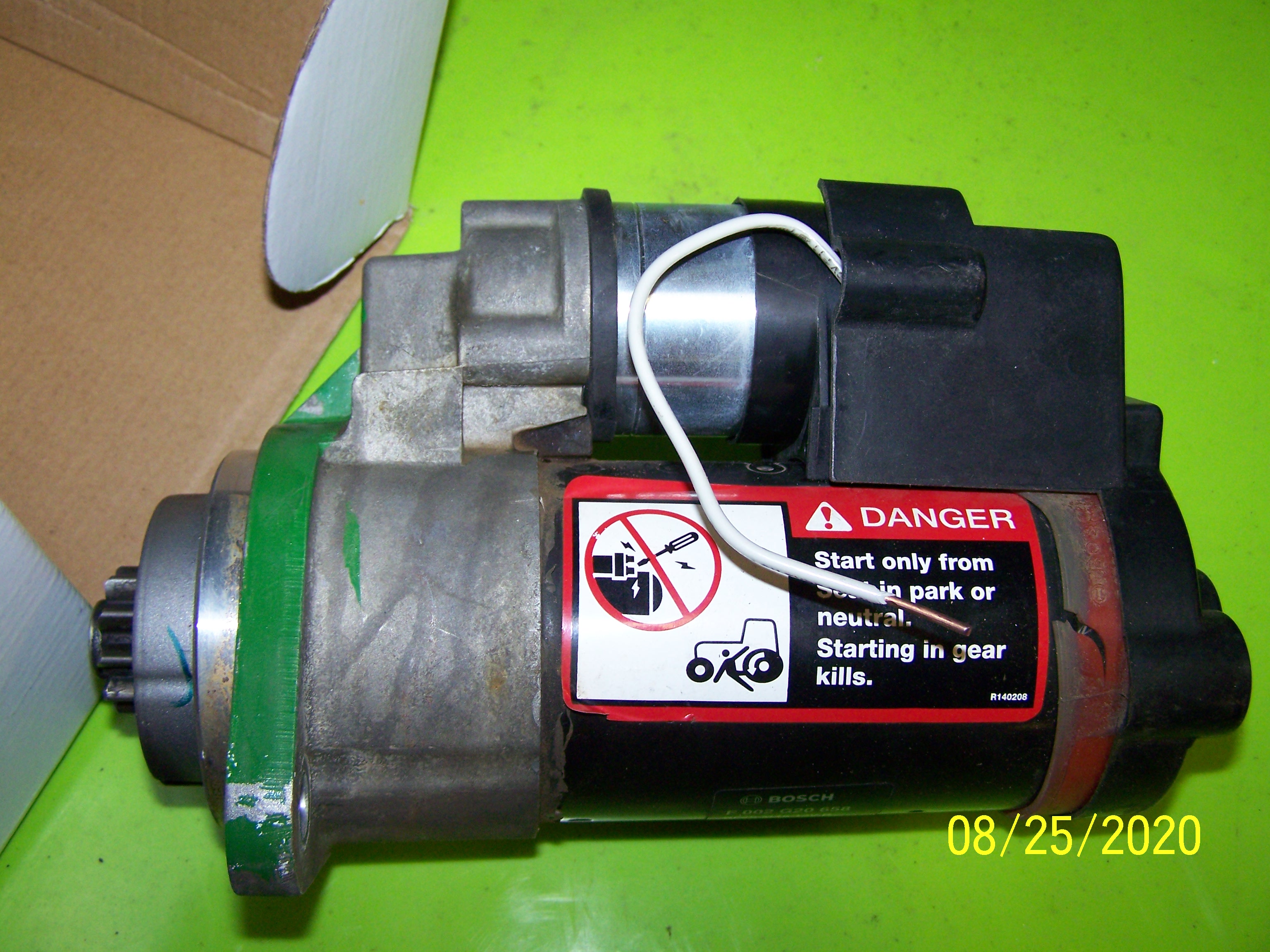

Thanks for the reply's, I have already bought a start solenoid and will try to put it on this Friday. I have the tractor at my hunting camp in Alabama( approx.80 miles from home)
The parts manager told me that is is located behind the Dash, I was wondering if any of yall have changed the solenoid before ? and if so, offer some instruction as to how to access it
Thanks
/ 2013 JD 5045D wont start #5
JD had issues with the solenoid that is mounted on the starter. I ended up replacing my starter with a new one off eBay for about $100. The solenoid was also available ($35) on eBay. I bought one and installed it on my original starter and it now is a good spare.
I was told that JD won't sell just the solenoid, you have to buy a starter/w solenoid to the tune of $400+.
I read on (this forum, I think) that even though there was no recall JD will replace the starter if you bring it to their attention. I would contact them first.
