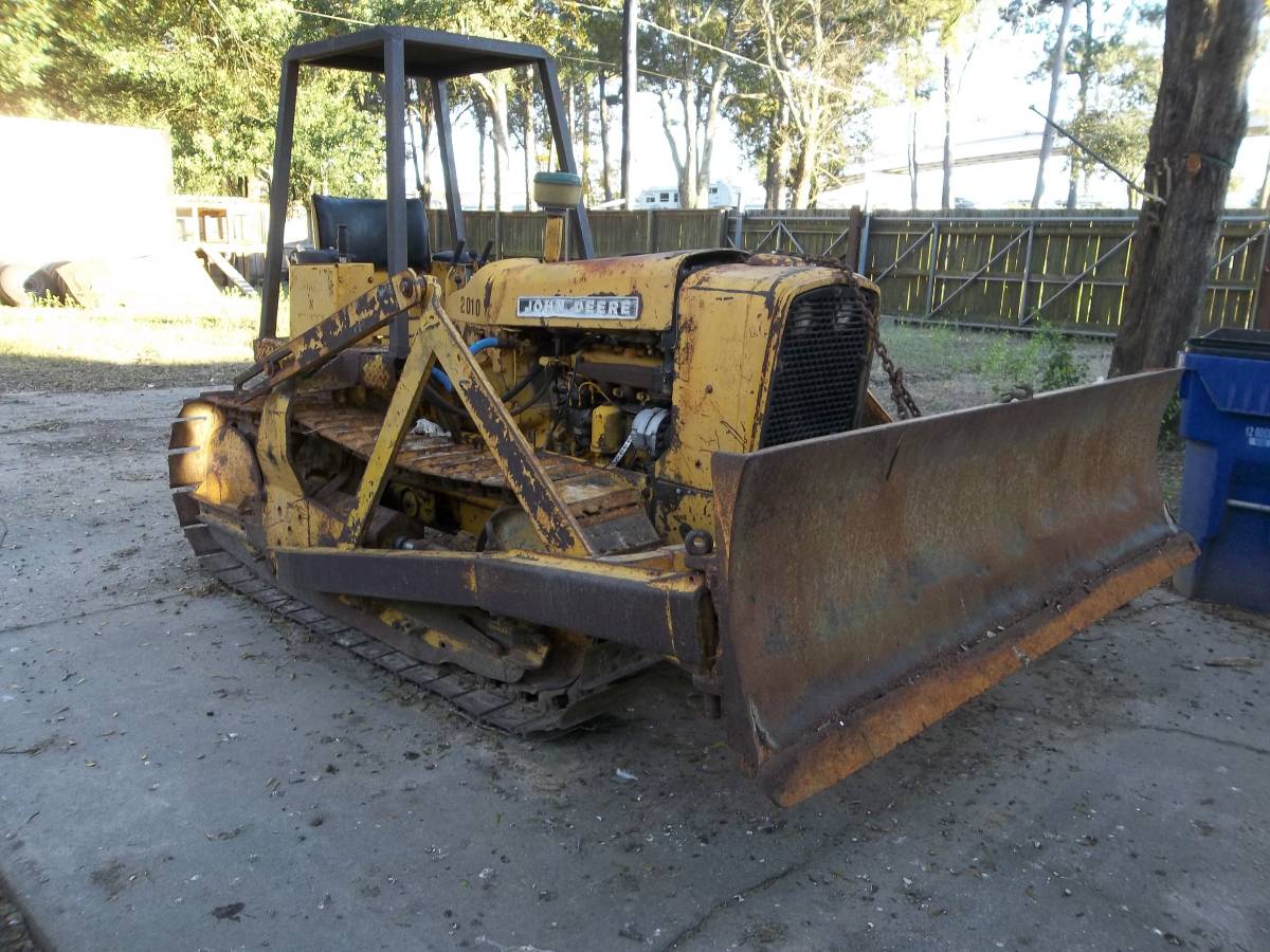

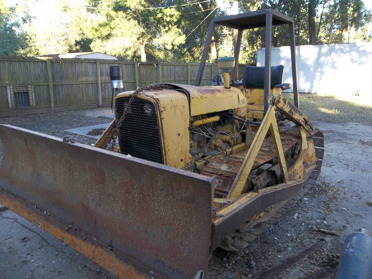

Hello everyone, I am glad I have found this forum! Seems to be lots of good info here!
The other day I picked up a 2010C with I believe is the 602 blade?
It痴 the 4 cylinder diesel. The number on the engine is 319826.
The SN on the chassis is 2010C 39557
I picked this thing up for $2500, and story goes that it was turned off after work one day some years ago and it never re-started.

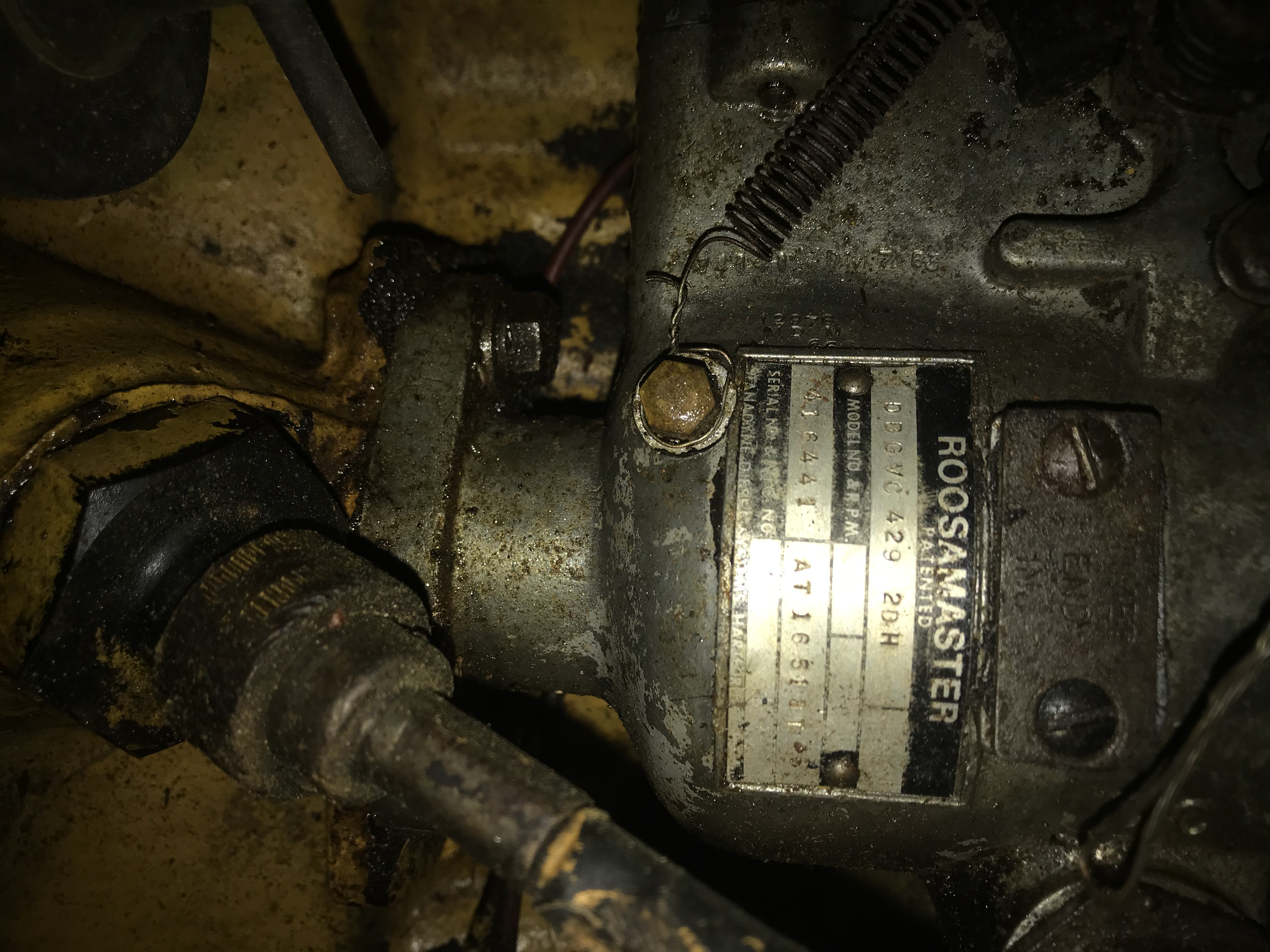

It appears that the injection pump is some sort of newer?
Engine seems to turn over fine, glow plugs are very worn.
Also, the diesel primer hoses are gone, and someone has removed the 2 canister filters on the left side of the engine and put a single inline filter there.
I am wanting to fully test and diagnose it痴 starting issue, but I can稚 find anything on doing a compression test on these.
One other thing is I need to fully check the pump timing and it痴 flow to be sure that it is working.
At least 3 cylinders are getting fuel up to them. It痴 not pouring out when cranking with the banjos loose (was hoping to see it pour out like my little tractor).
Cylinder #3 was kind of hard to tell. I also cracked the banjo at the pump, and it didn稚 seem like much fuel was coming out.

The good news is that the undercarriage seems to be in pretty good shape overall, I値l dig into more of that if I can get it started.
DF3B6B42-C0D4-4178-A2F1-2F284E42E40D.jpeg83ED6E69-1B8E-4E8C-BCB7-FEB7E1813456.jpegEFBEAB4D-7A9E-4304-B32C-817BC52F01D7.jpeg2EF9BCC7-12C6-4220-BD36-1377FE4F52D2.jpeg

as far as the starting fuel goes, its VERY possible that the inj. pump innards are stuck/gummed up, not supply enough fuel to start the engine.??
IF it has glow plugs, u can get an inexpensive compression tester from Harbor Freight that will test thru the GP holes.
Good luck & I'm here if u need inj. pump guidance.
