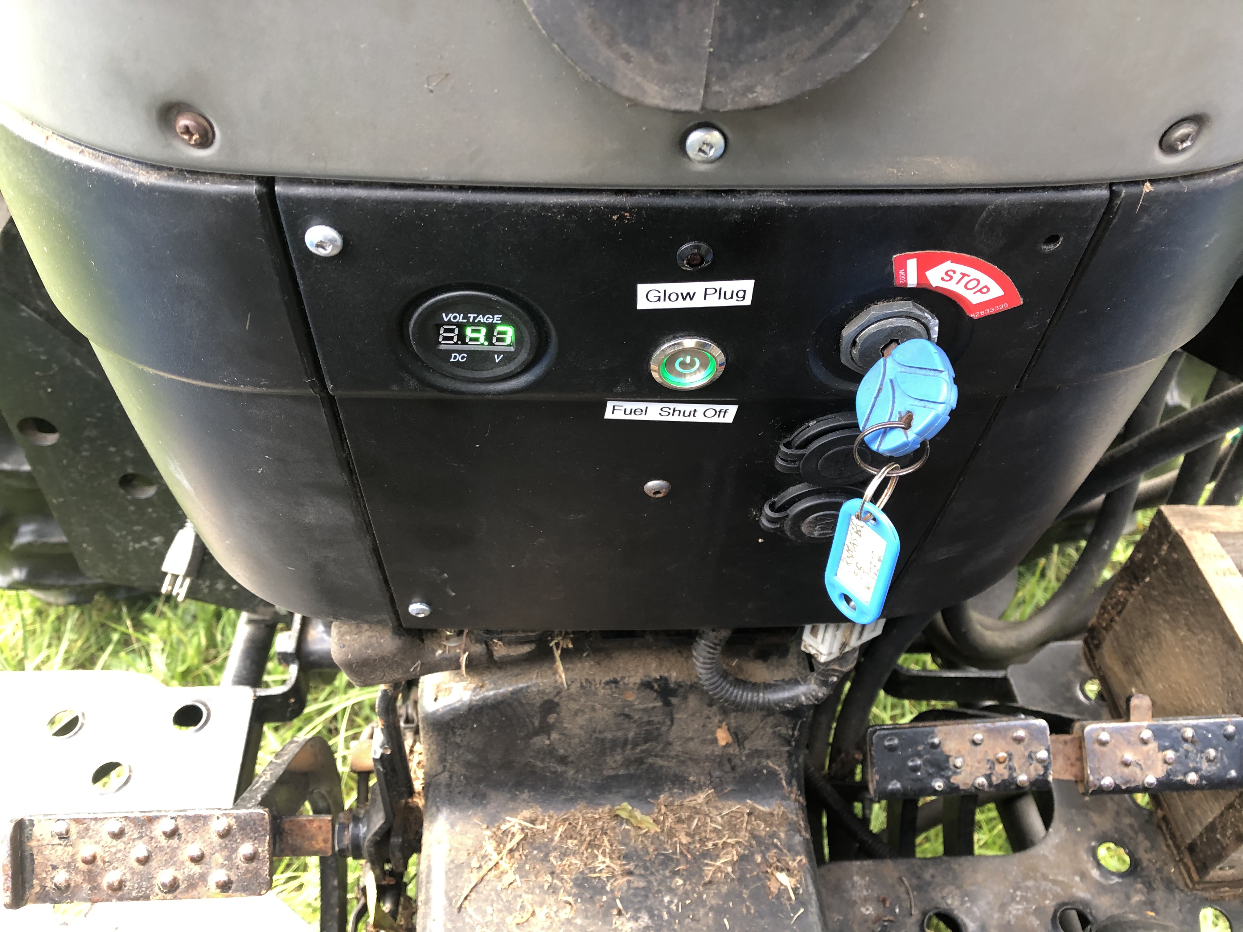

I thought I would post an update.
Thanks to some help from Stillplayswithtractors I got it solved.
Buried in behind the instrument panel (lower left) there are 3 relays. One of them is for the fuel shut off and had gone bad.
The relay must have been working intermittently and then quit completely.
Swapped the relay for one of the other 3 and the tractor fired right up.
To help in the future I have"
- wired in a glow plug LED that shows if the plug bus bar is getting power
- wired in a fuel shut off bypass switch. It feeds directly from the battery to the fuel shutoff.
The fuel shut off switch allows me to run the tractor if any of the safety switches or relays go bad.
It also has an indicator light that shows if the output has power. Therefore it shows if the fuel shutoff relay is getting power normally because the output of the switch is attached to the fuel shutoff.
I added an inexpensive voltmeter too so I can keep an eye on the battery and alternator
