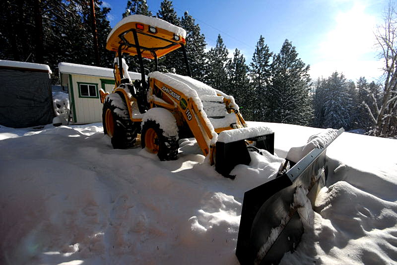

Nice review! Would like to see pictures though...
I probably have only about 10-15 hours on mine. I haven't had any problem finding float. But, I have noticed cavitation on the FEL lift when the tractor is sloped downhill. This and another new one at the dealer does the same thing. I'm hoping it will just go away in due time...
I plowed at night last week, and the lights work great. I haven't used the PTO or messed with the rear hydraulics yet.
Yea, right now a CAB would be nice! However, I think it'll be fine once I get a building to put it in... I'm already tired of cleaning the snow off the tractor prior to using it.
For the front blade (BL-8), I have found it not so good for light stuff. I would much rather use my 2520 and rear blade for anything under about 6". The 110 and BL-8 works better to move the heavier and packed stuff. So, on a heavy snow, or when I need to widen the berms, I'll use the 110 and then the 2520 after, for a nice clean-up, and sanding if it is icy underneath.
Last week when I was using it to move some densely packed stuff, it's size seemed reduced and smaller than I imagined before. But, it sure met the need. When I purchased it, it seemed like it is huge. I'm glad that I did not go with anything smaller and kept the 2520 too.
