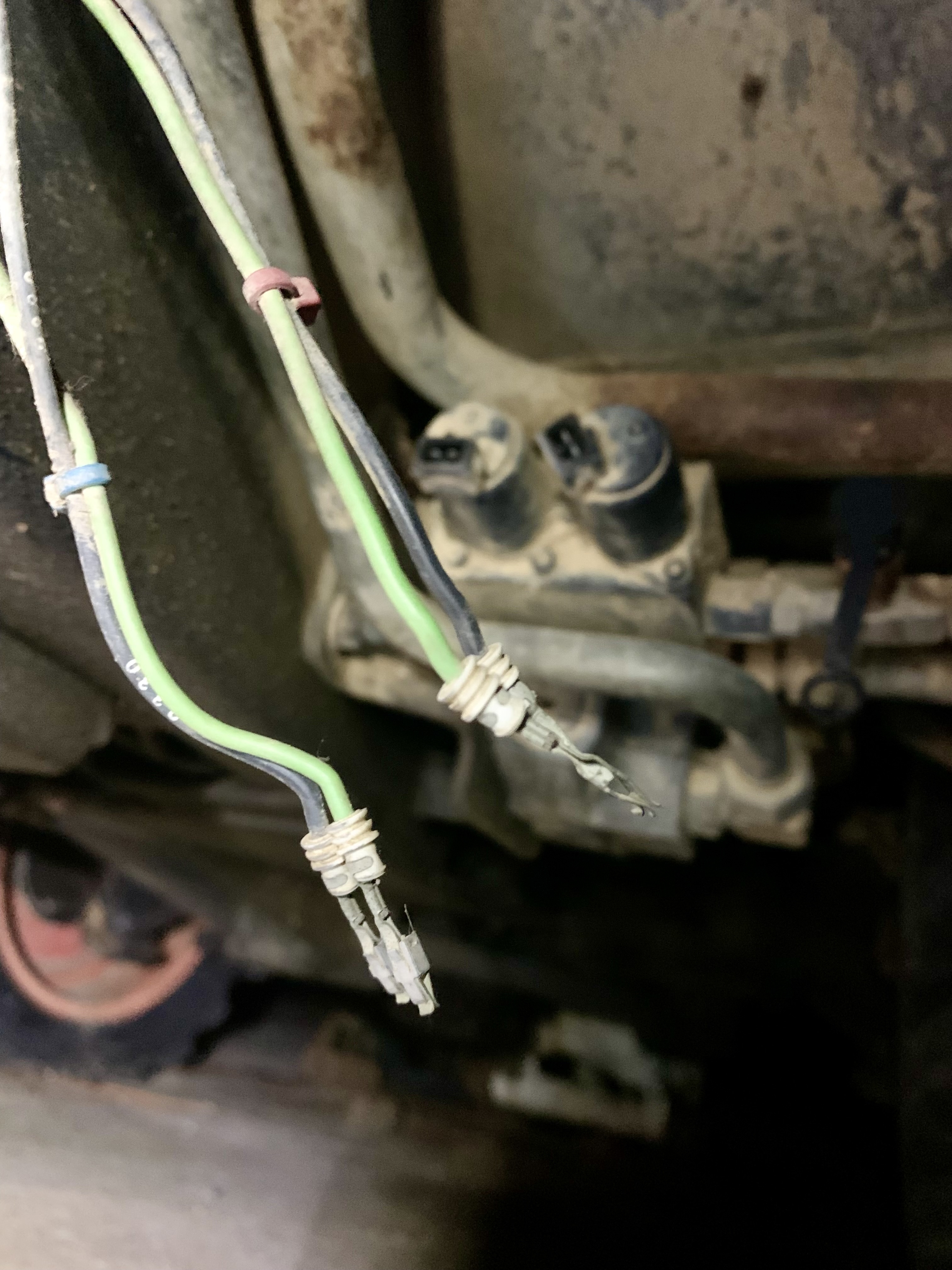

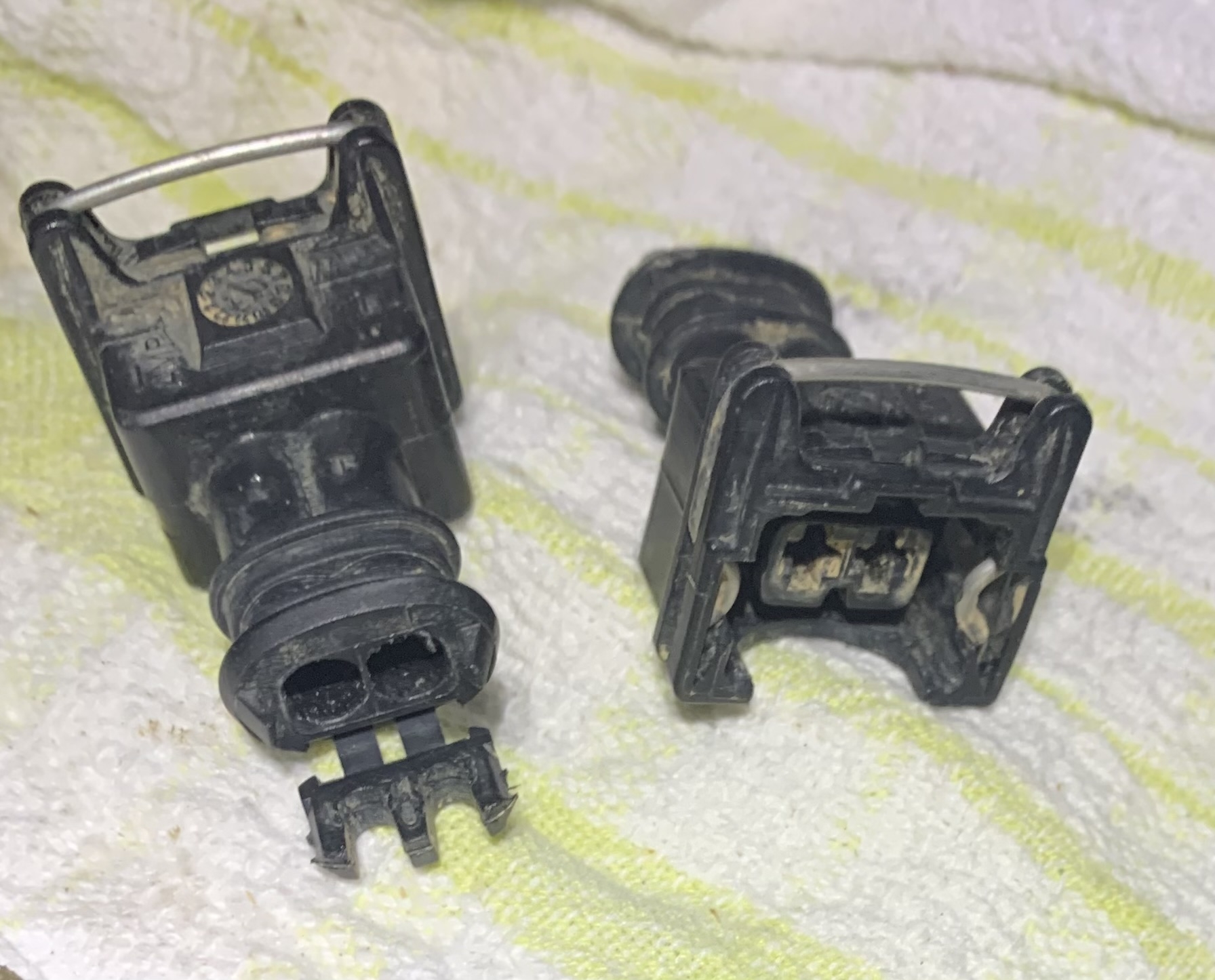

Under passenger side, 4 wires were pulled loose from solenoid connectors. Does anyone know which wire goes where in the connectors?
Also, would this cause all hydraulics to not work ?

That looks different than my hi-flo G-series so I can't help.
   / 2005 Toolcat 5600b solenoid wires pulled loose #3
if it goes to the solenoid check the electrical diagram but it can only be a switched 12volt circuit and a solenoid does not care if the plus and minus wires are reversed
