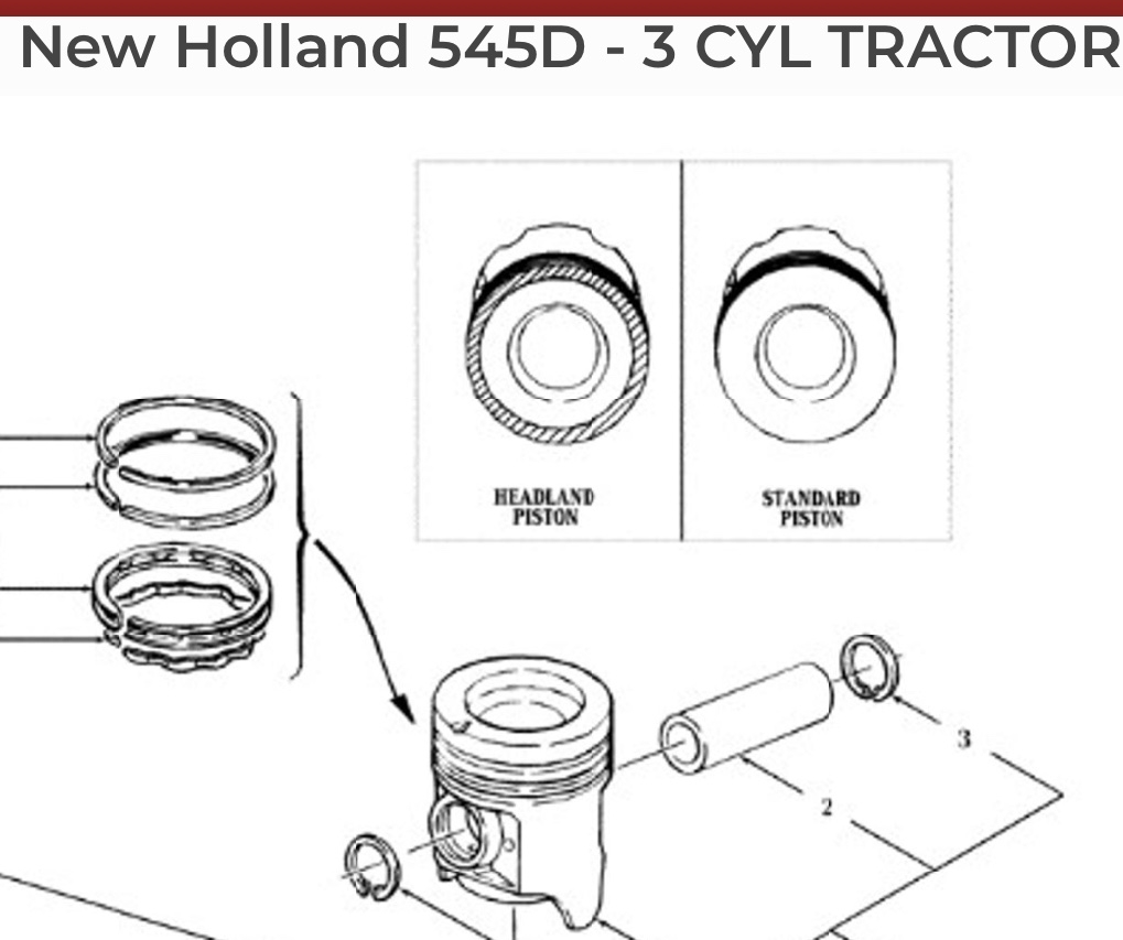

/ 2001 New Holland 545D injection pump question #2
Andy, just saw this post. The answer is no. The 4500 has the same size engine, but standard pistons. The 445 has a smaller engine. The 545D Emissionized has headland pistons. None of these pumps will substitute for the other.
You can try it of course, but I don’t think you will be happy.
You might get the pump numbers and ask the pumpguy on here if he could cobble something together.

I noticed those headland pistons right away and figured they had to do something with the emissions.

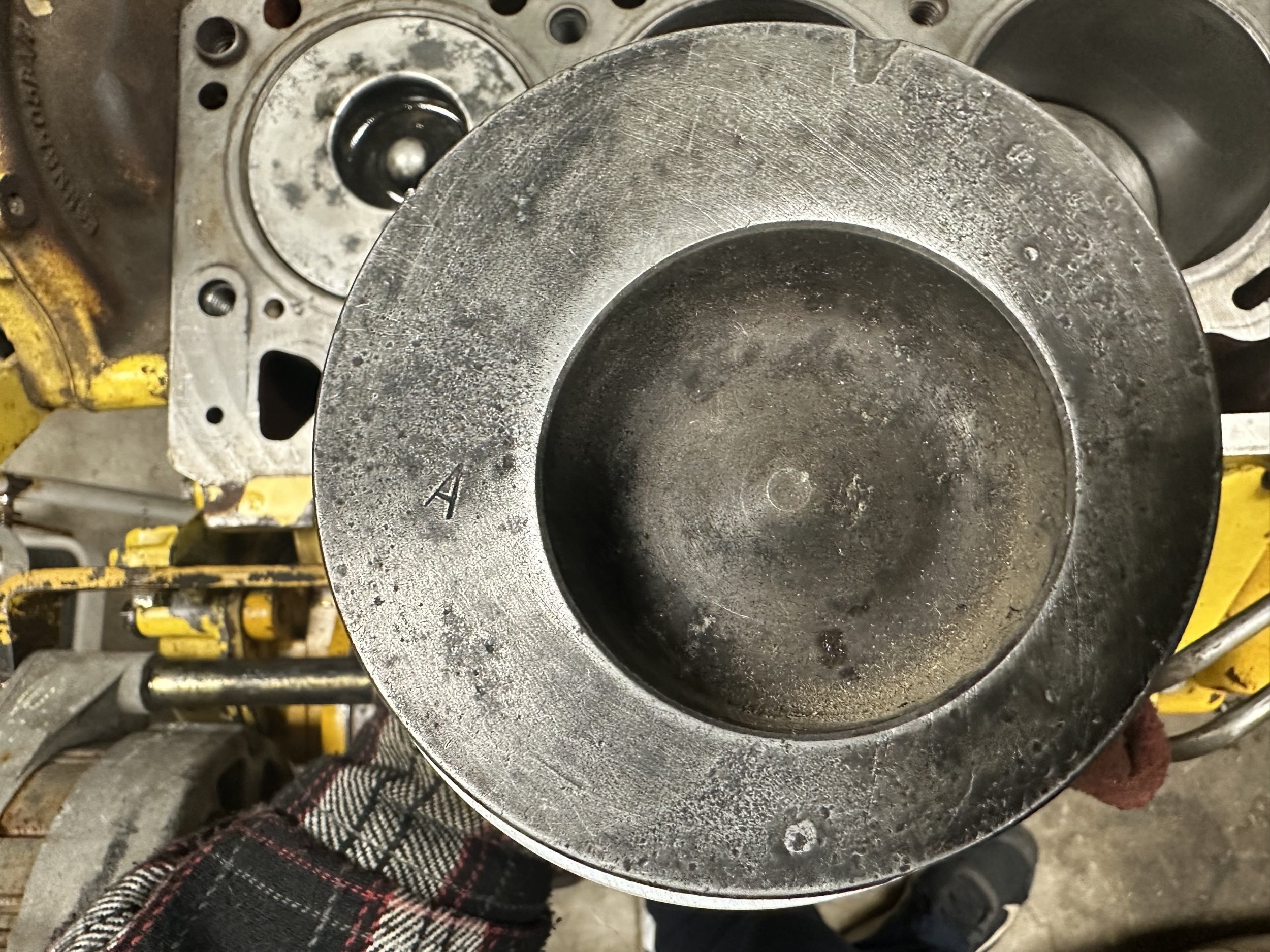

Looks like I’m ordering some standard pistons if they’ll work with this head. I haven’t measured the angle of the injector yet. Can you recommend a quality brand piston or source? I’ve come so far with this rebuild to cut corners at this point.
The 545D injection pump mounting holes were set at a different angle. I welded up and relocated the holes for the non-emission pump. I’ll measure how many degrees the injection pump is turned off the patterns I made.
Here’s a smaller standard piston out of a 4400 and the headland piston in my 545D. They’re similar except for the location of the dimple and the radius. Can I machine the headland to match the standard piston? The location will still be off but I can make match the 2-5/16” standard piston divot.
If there’s anyone out there in this situation, I can say without a doubt. NH 4.400” standard pistons are not a replacement for NH headland pistons on a turbocharged machine.
The hole in the tops of the standard pistons are 2-1/2” wide and 3/4” deep. The hole in the headland pistons are 2” wide and 3/4” deep. When I compression tested it…I was only getting 275psi with the standard pistons installed. I swapped them out for the headland pistons and the pressure went to 500psi.
My 2001 545D was an emissionized, turbocharged tractor. I installed a Ford 4500 injection pump & pump drive gear from a non-emissioned tractor and it purrs like a kitten with the turbo. I retarded the pump a few degrees because the timing on the newer machine is 29* BTDC and the older Ford tractors are 26* BTDC.
