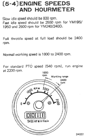

Engine Speeds (p. 23):
The manual says the recommended slow idle is 800 rpm and "Fast idle should be set at 2550 rpm." That fast idle sounds a little high. Does anyone agree that's probably a typo and the fast idle speed should be something more like 1550 rpm.
The "fast idle" is referring to the upper rpm limit. Possibly could be worded different but really should be obvious by looking at the next line showing working RPM.

Admittedly, Aaron, I have little previous experience with diesel engines and I'm sure they have their own, specific, and unique terminology. But, until now, I had never heard the term "fast idle" used to refer to an engine parameter I had always heard referenced as "Maximum RPM", or "Never Exceed Speed", or "Redline RPM" or some other term which implied an RPM limit.
In my past experience, the term "fast idle" has always referred to an increased idle speed used during engine warmup and was usually set by some mechanical means in the throttle linkage. That misconception was reinforced by the implication in "Fast idle should be set ... " that the fast idle speed can somehow be set or controlled by the operator. I didn't consider it as an upper limit since the RPM limit is a function of the engine's design and isn't open to adjustment by the operator.
Hopefully, you can now understand my confusion. It was certainly obvious that, according to my previous understanding of the term, a "fast idle" or "warmup idle" of 2550 RPM had to be an error.
   / '20 Series Owners Manual - errata #4
I had never seen Maximum RPM stated as 'Fast Idle' but that's what Yanmar used in their American manuals for the models they sold here.
Source: YM240 operating manual. (US version YM2000.)
