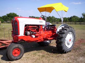

you looking for old or new.
if older is ok.. what about a ford rowcrop.. like a 7xx or 9xx .. either trike or wide front.
great cultivator tractors.. and great ground clearance... here's a pic of my 951.. you have to step up to get on it.. great clearance!!
they are usually cheap tractors and easy to maintain.

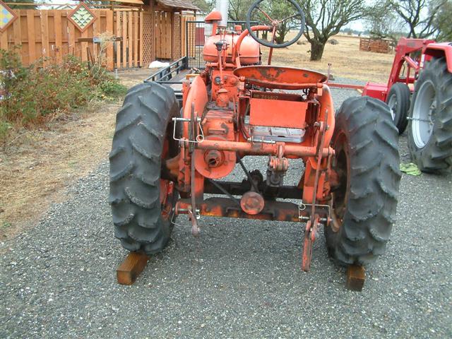

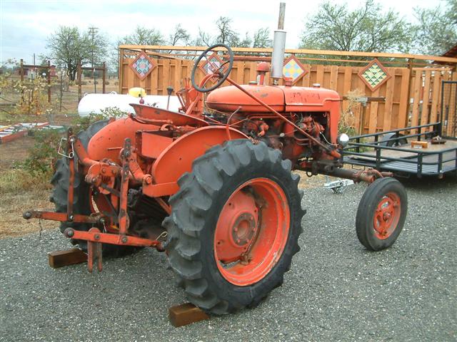

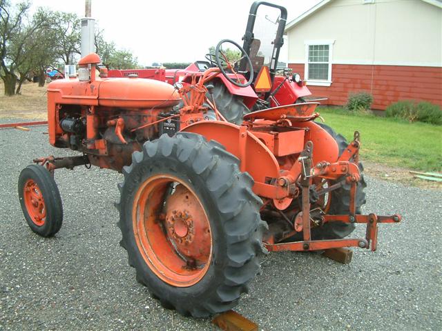

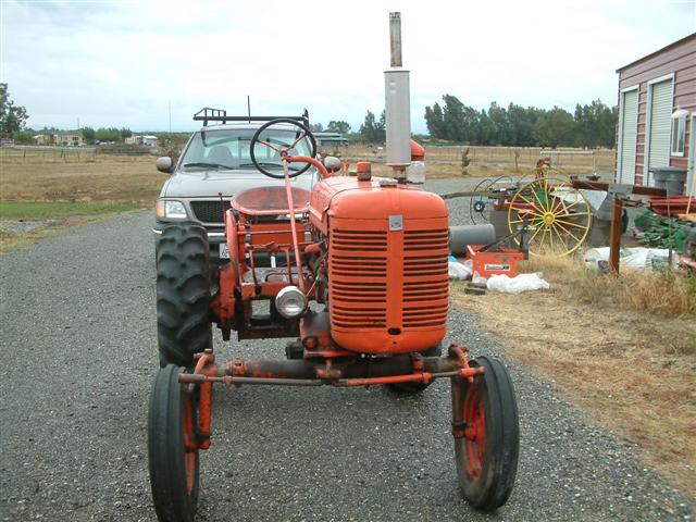

Here's my 1951 Farmall Super A, a real truck garden tractor. The bull gear setup on the rear axle gives a 20" ground clearance when all the support brackets for the pto are removed. I bought this one last year for $1300 including a mid-mount sickle bar mower and a 3-pt hitch. There are quite a few of these still around and parts are easy to find.

yep.. ford trikes have a similar rear outboard gear reduction setup.. gives you great clearance.
so far, all the oldies mentioned are all great cultivating tractors.
