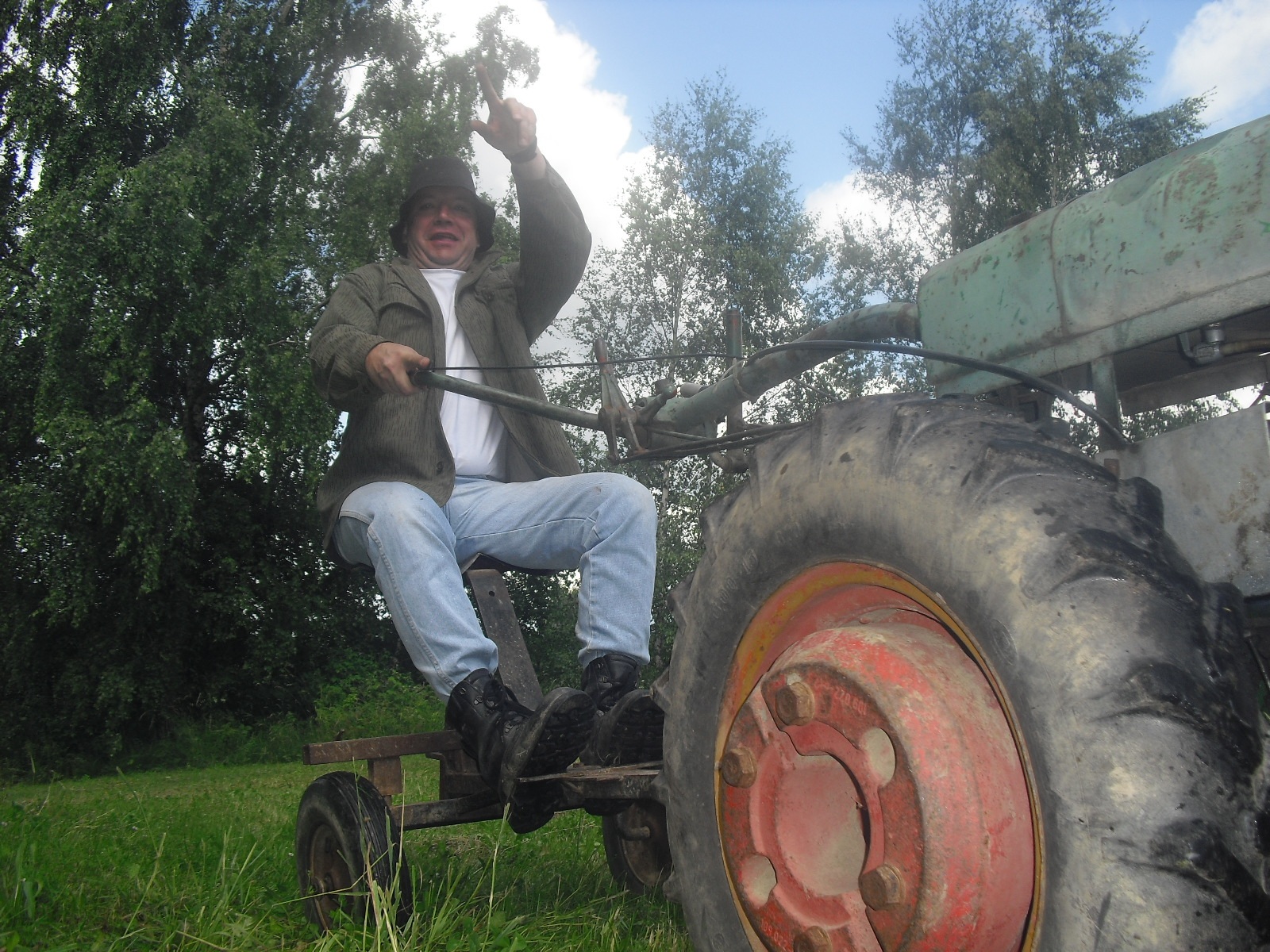

Yes, Sir. As a teenager I thought these 2-wheel mills driven around the villages by grumpy old men were the most embarrassing thing on earth.
Now I am itching to get a cart or a sulky for my 2-wheeler and remove all doubt for my neighbors who already suspect that I'm mentally unstable for owning one (hat tip to Joe Smith).
I know a modern 13 HP gasoline BCS doesn't make the same impression as a PF-63D with a puffing 2-stroke diesel but I think BATFE wouldn't let me import one.
One thing is sure---either one of these encounters in the woods would do it for my neighbors:

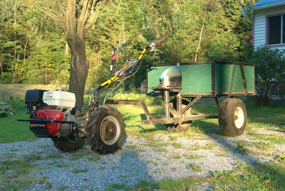

Hi! Thanks for videos. In Europa They are a lot of two-Wheels tractors for many years. I like walk behind but sometime I take a ride with my Grillo 107d The trailer was for VTT ( home made) I add a seat and a new tongue . Grillo at full throttle in gear 4 is fast. Good Luck! Oldmech

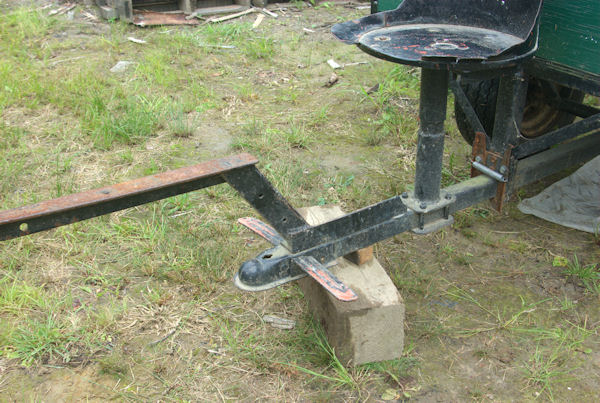

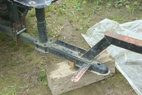

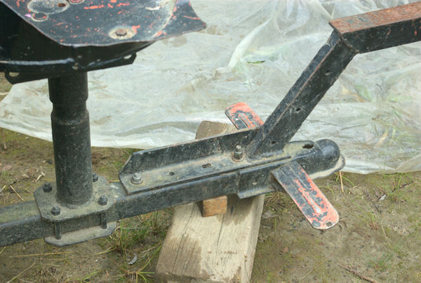

Thanks for posting a picture of your new trailer. I don't think I've seen it before---I remember your red one with the straight tongue. I see you can keep a rear tiller attached to your 107d under the raised trailer tongue. Can you post a picture of the tongue detail?
And how fast do you go in 4th gear behind your Grillo? Like these open category gentlemen in Flehingen? :confused2:

Hi! The garden trailer 10 cu.ft was good for small jobs. But now not enough for my need. With ATV trailer 15 cu.ft I can load 1000 lbs dirt . 1/3 cord wood etc..This one dump. I make offset tongue for add a PTO water pump. I use it with 3 x 50 gals barrels in my trailer. I was going at the river for pick up water for garden. The offset tongue , the seat and the foot steps are not welded on the trailer. They are bolted. So adjustable and removable. I give you some measures V metal bar are 2 in. x 2in. x.25 Offset is 9.5 in. height with two 1 in.x 2.in x .25 L steel welded together. Total length is 44 in. The small attach offset is down 2.5 in. Seat is 15 in. height. I use it often. Seat and feet step make it comfortable . The Grillo top speed is 8.3 mph. but look for me faster. Good luck! Oldmech

I was racking my brain which driven implement was so important to you to make the offset tongue and I could not figure it out. A water pump! You make the Grillo earn its keep---3 x 50 gal barrels would be 1250 lbs of water if they were full. How far is your river? You can travel in style and comfort as you get the work done.
Thanks for the detail pictures and measurements. I am not ready to fabricate yet because I am still setting up my shop and replacing my tools after the house fire but I keep a computer folder with your creations and ideas so I won't have to hunt for them later. Your posts are most valuable to me.

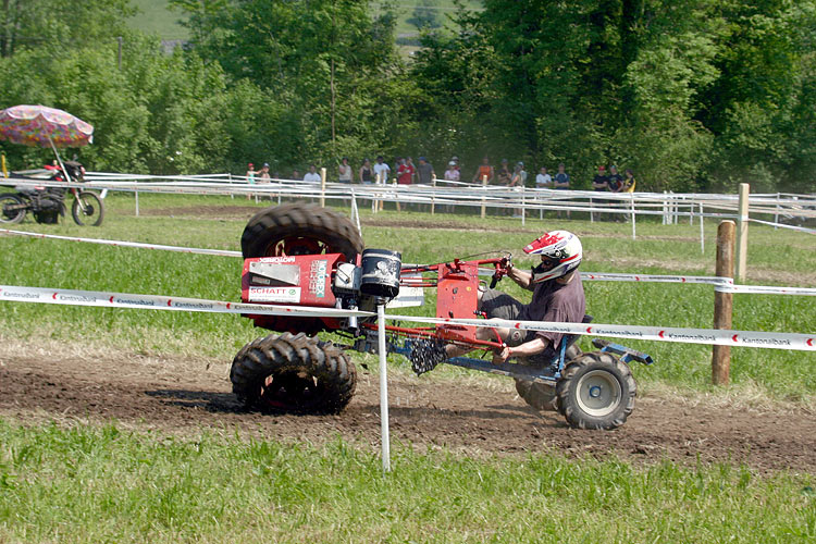

Bernhard, thanks for posting the real racing videos. I noticed that the Swiss and the Germans are having a blast with their Single-Axlers. It reminds one of the early days of racing. Some of my favorites from Ernst Burch's webpage are attached:
