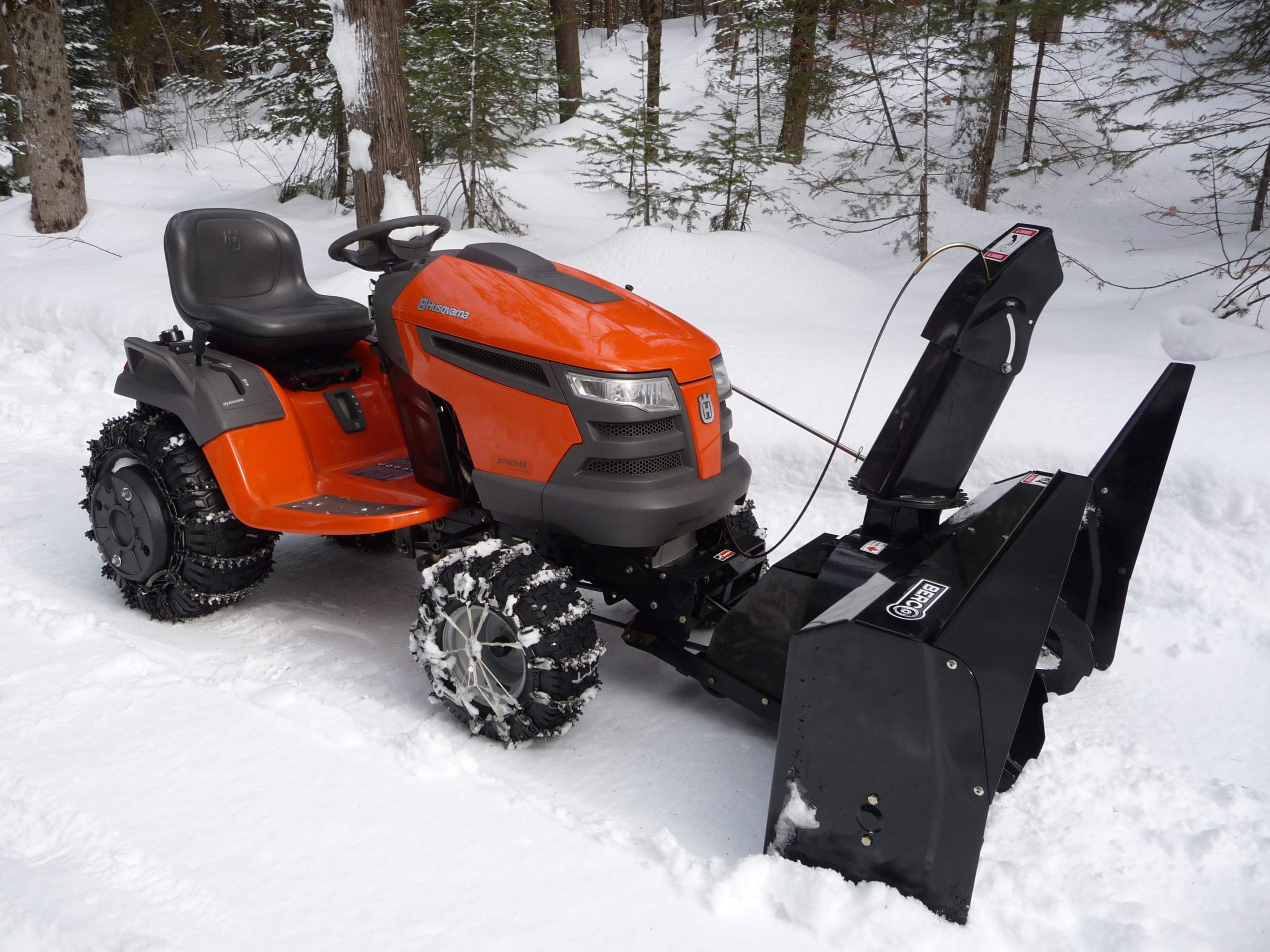

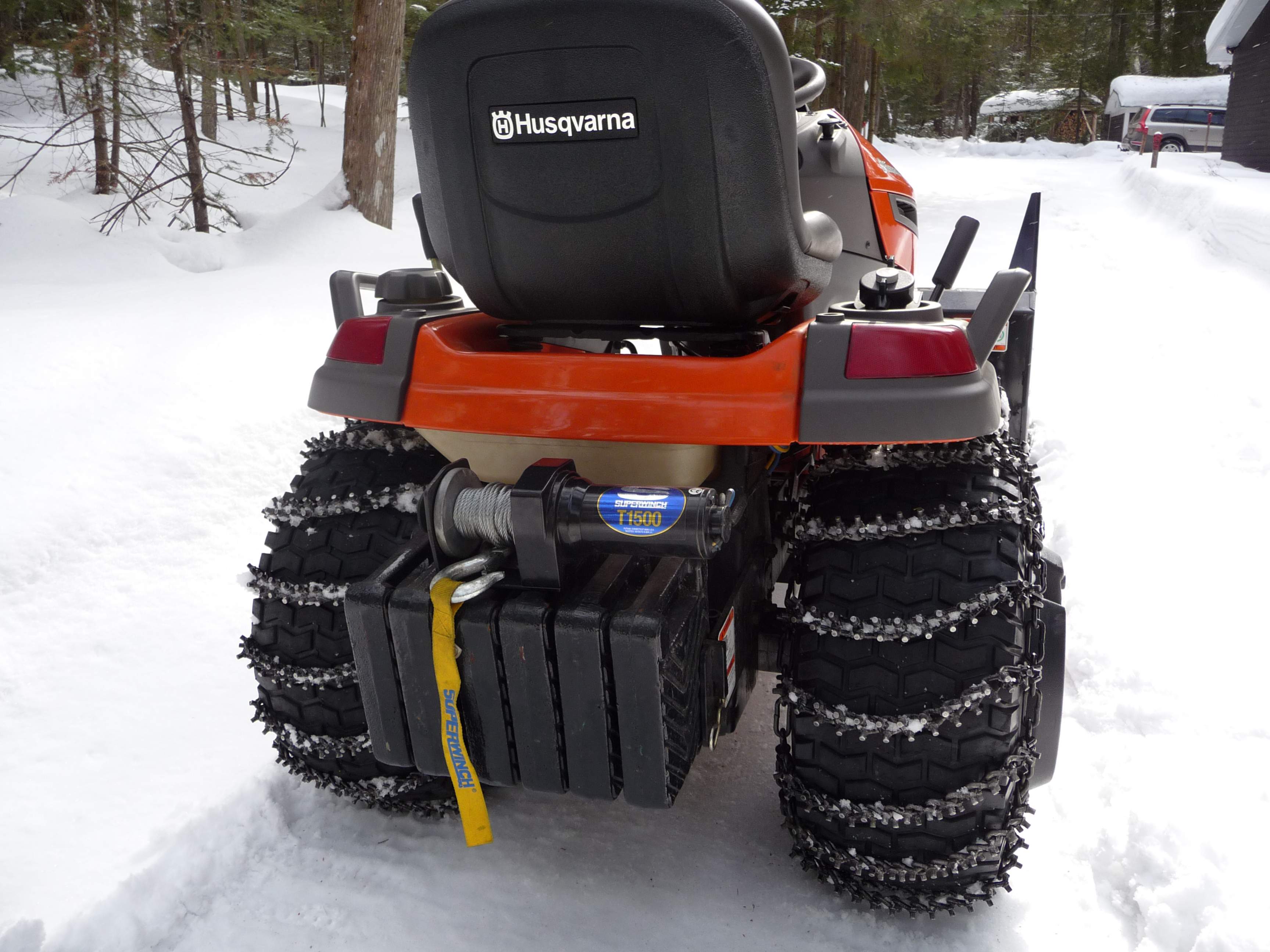

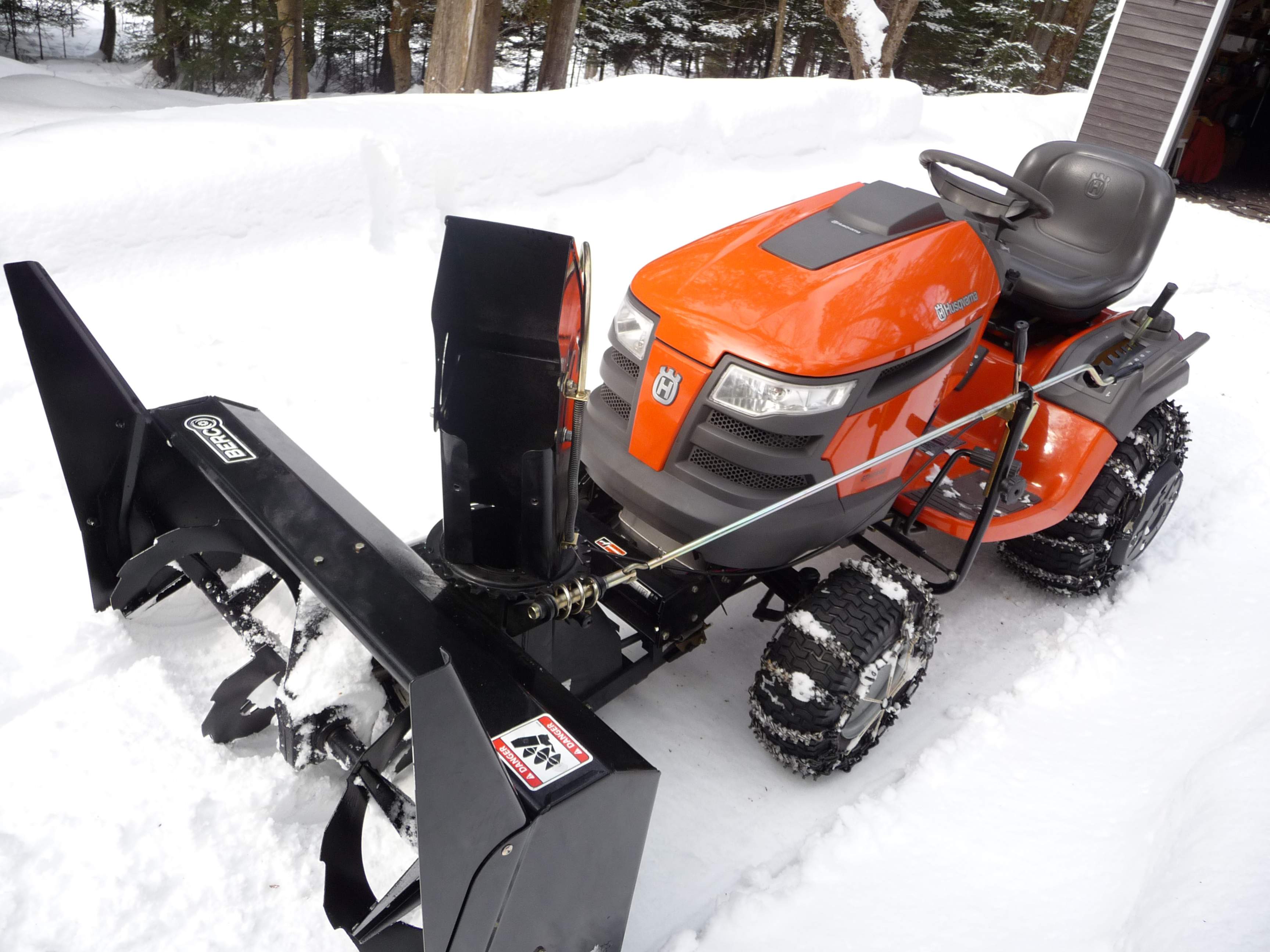

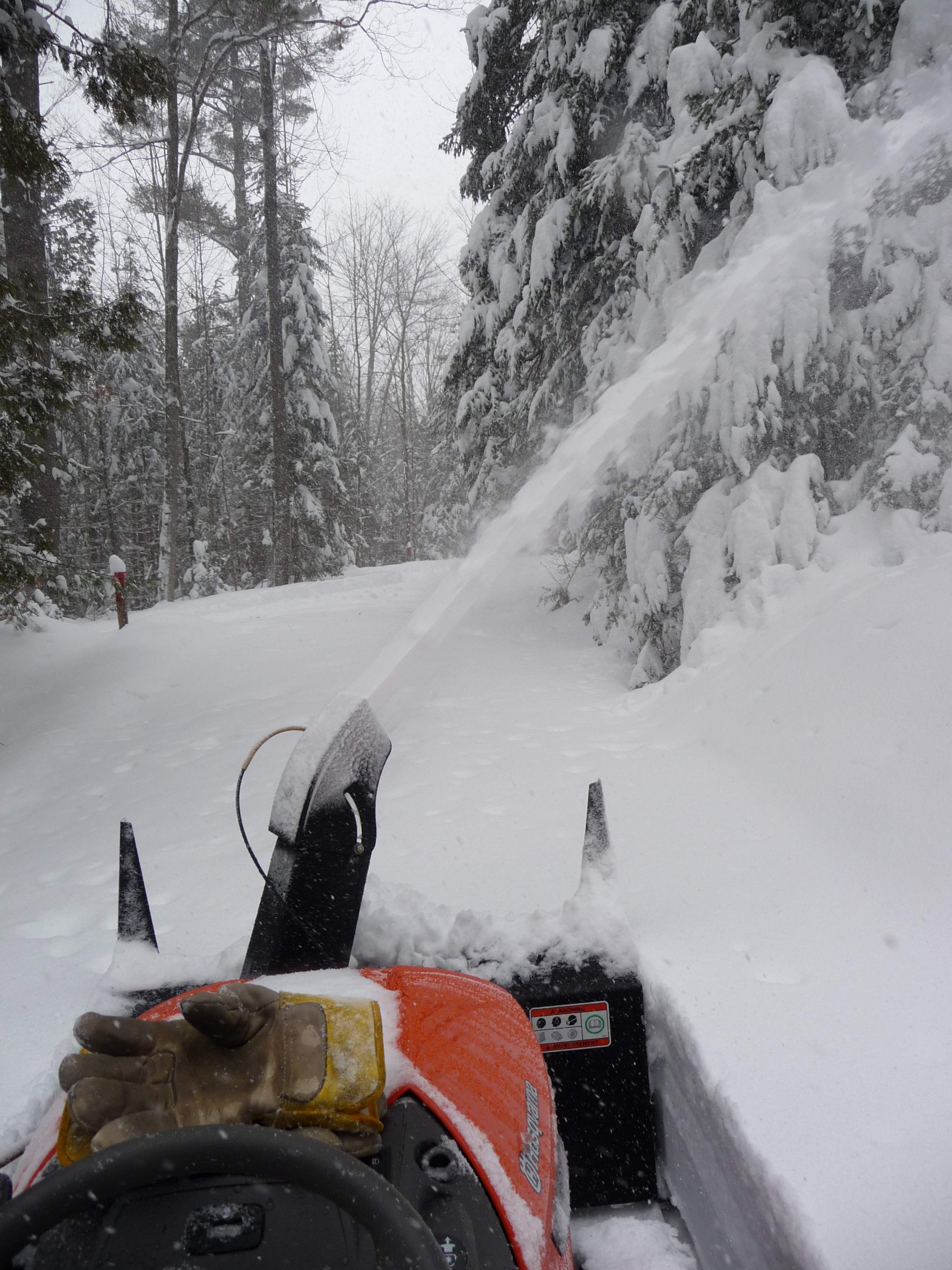

I had a 26hp huskvarna lawn tractor with a berco snow blower, with studded chain on all four wheels. It started with only standard chain on the rear, but proved to be inadequate for dirt road (800 yard). I really though I could make it with that setup, but really, it was a fail! I was able to sell everything to a downtown owner with a small diveway, he and I were happy!!! I ended up with a 4wheel drive kioti. I should have bought the Kioti year ago... I know, it's a learning curve...
