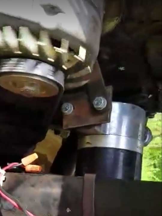

I have a Farmpro 2420 that I have owned for about 4 years. After 2 years of use I had to replace the water pump. No big deal, right?
I ordered a water pump, replaced the old one, and off to work I went.
A year later, guess what? Water pump starts leaking again.
Same deal.....I ordered one, replaced it, and off to work again.
I decided this time...Maybe I didnt grease it often enough, so I made sure to grease it a little more often.
I went to a shot of grease twice a month instead of once a month.
Guess what..........a year later............Water pump started leaking again.
At this point I am MAD!
$200 a pop for a water pump, once a year is ridiculous!!
I decided at this point I was not going to put another Chinese Water pump on this thing again.

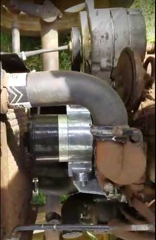

So....Being a Chevy man for half my life, and a Make it myself guy all my life I decided to go to work on a better solution.

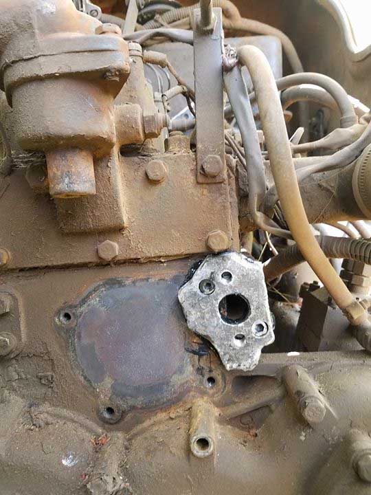

I removed the radiator, air filter housing, and water pump. Then I studied the situation for a couple hours.
Here was my solution.

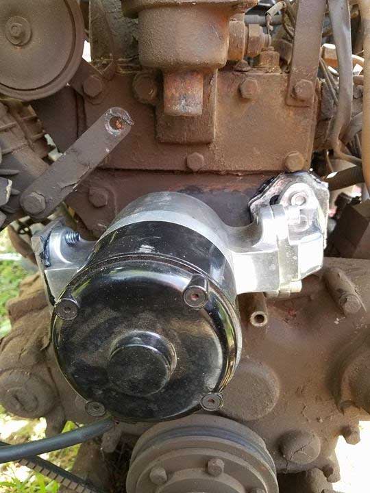

Dug out an electric Small Block Chevy electric water pump, and made an adapter plate.

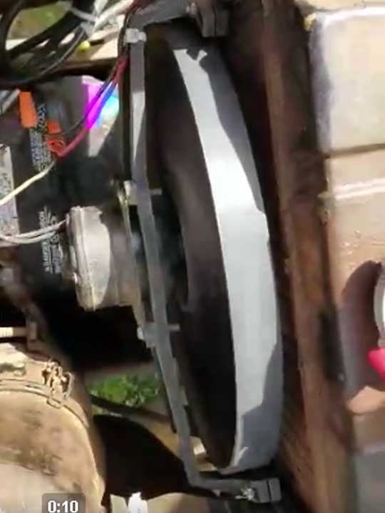

I also dug out an electric fan.
I have been steady using it for about 2 weeks now, and my operating temp has been a steady 140 degrees.
I may have to replace the thermostat to a warmer one to bring the temp up just a tad, but want to wait till hotter weather.
I also upgraded to a one wire Chevrolet alternator to handle the extra draw from the electric pump, and fan.
Now if my water pump goes out (which it probably will outlast the tractor) I can go to the parts store and pick one up for $100.

You probably have a lot of casting sand left over in the block. This is exactly why people install coolant filters. You will find coolant filters on all higher end equipment. I have them on all my equipment.
Interesting work-around you came up with.
Yes, 140 degrees is too cold. Should be 185-190 degrees to help evaporate the moisture in the oil and to increase thermal efficiency.

Thanks. Yes I can have that pump off, and a new one on in less than 10 minutes.
Like you, I set out to rebuild mine. However I was having trouble finding the seal. The bearings were a common 6203 bearing.
Having trouble finding the seal I just decided to go this route. I can find these pumps all day long for $100 If it ever goes bad.
