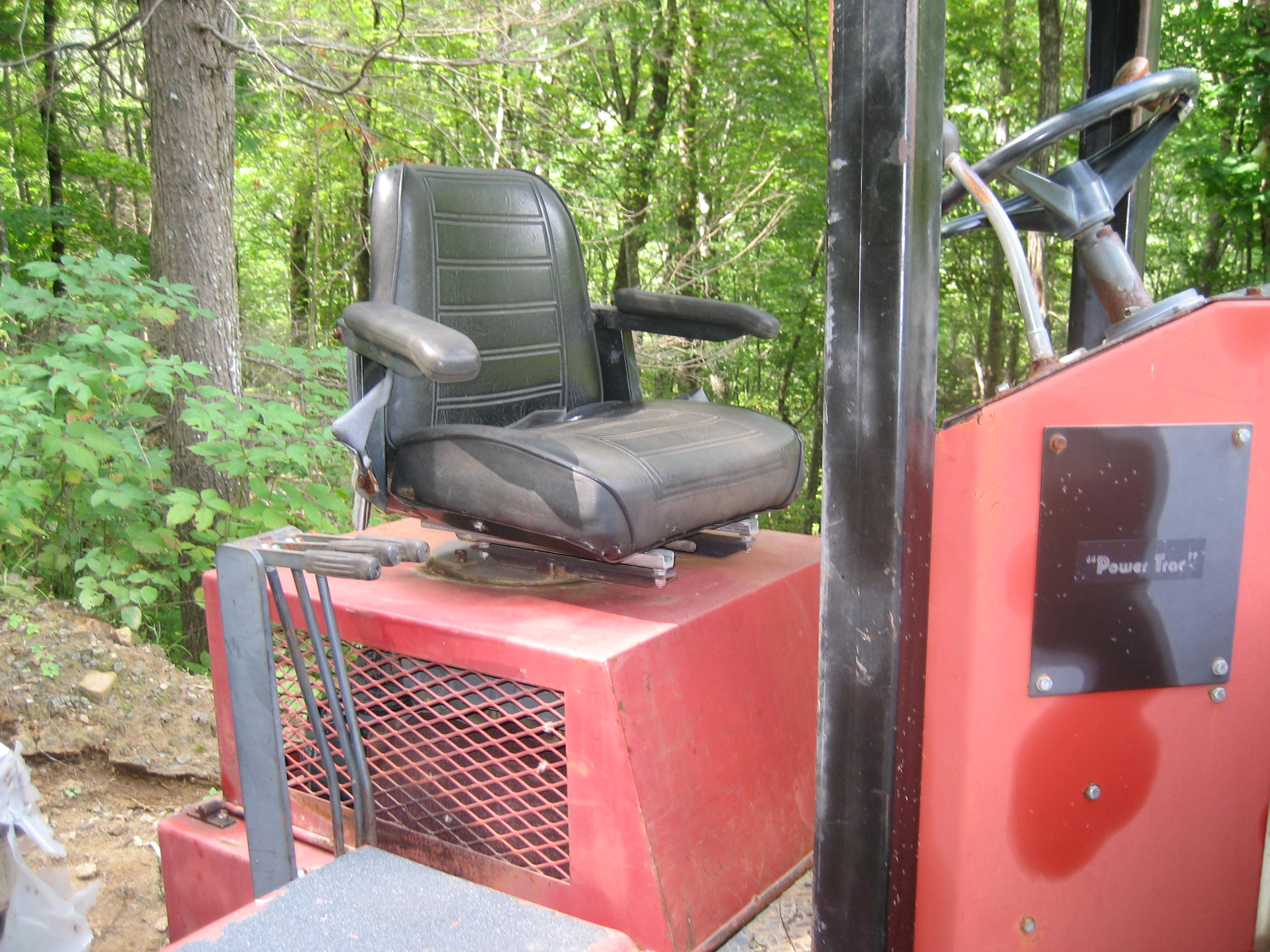

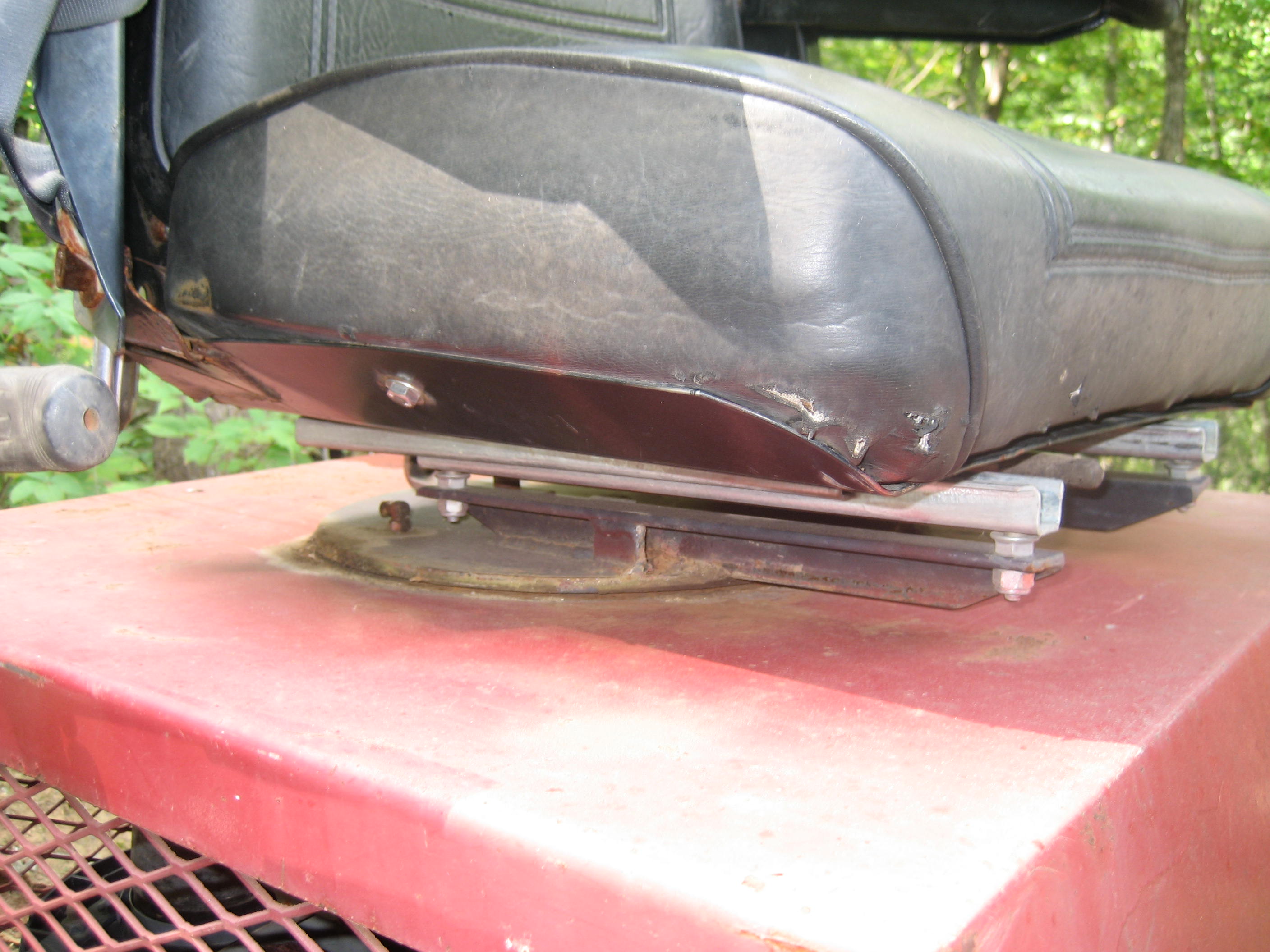

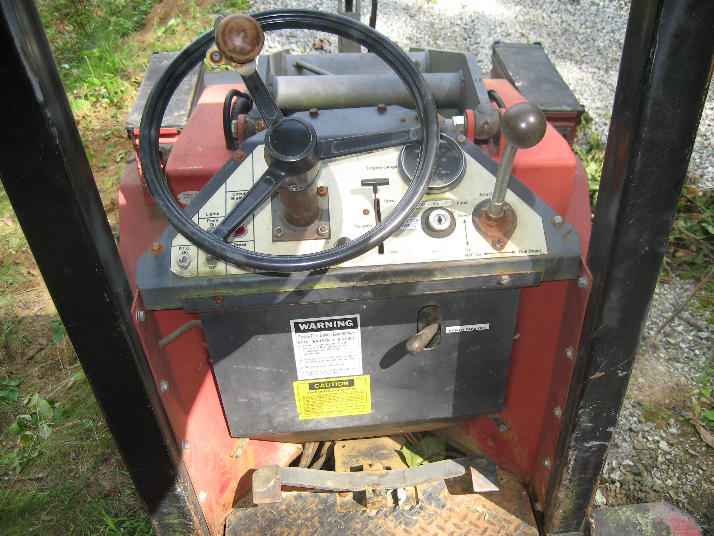

Bought it used from a priivate party....no slope limit or user manuals provided.....my wag is it will handle 40 degrees w/dualies
I'm six foot. When seated I maybe have 4 to 5" above my head. Hittiing my head a few times on that 1/4" steel has convinced me to buckle up. Not much margin for error, so height is definately an issue...
No room for re-jiggering the engine compartment or cover. The seat is mounted on a 1/4" steel disk that pivots on a center bolt. It works just fine for the occasional backhoe needs. I'm just thinking of adding some hardware to re-mount the seat (or a new one) on a 30% tilting affair managed by a small hydr cylinder and mercury activated switch...

My 1445 will not handle duals, and I don't think yours will either. Unless you build some long spacers. I don't think you can reverse your wheels, and if you can't reverse, duals will be a problem. The deep dish part of the wheel goes to the frame side, like on Carl's machine, and the shallow part of the other wheel connects with a spacer. I believe this is correct. If not, I am sure someone will tell me.
