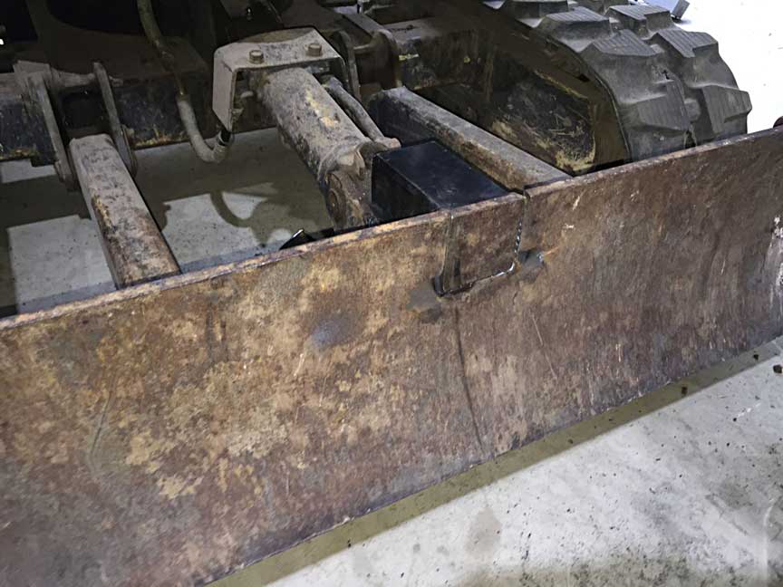

Project story. I know you fellas like pics.
Decided I wanted a hitch on the KX41 mini-excavator so I can drag a trailer or ATV to the worksite. Also in the plan is to tow a snowmobile trailer while picking up logs, stumps, sticks, brush etc with the thumb, spin around and set it on the trailer.

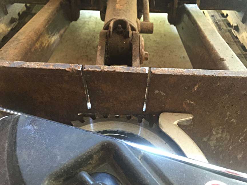

Cut the 3/8" thick blade with a skilsaw-type metal cutting saw. It was easy. Even the plungecut across the bottom was easy. I finished up the corners with a sawzall then welded up the overcuts.
439880d1441549296-2-receiver-welded-into-mini-1cut_blade-jpg

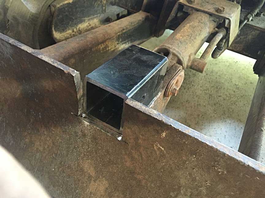

Tacked the receiver tube in. This receiver tube is 5 inches of an 18" long (2.06" x 2.06" inside dimension to fit 2x2) tube section from Harbor freight. You can make several receivers from one 18" tube.
439899d1441550277-2-receiver-welded-into-mini-2tack_receiver-jpg

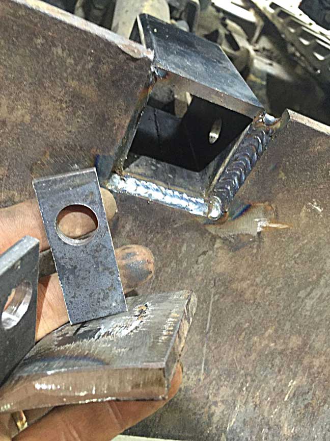

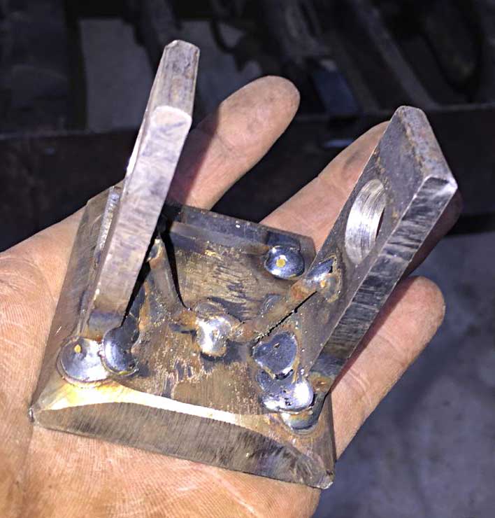

Decided to make a plug to cover the hole, so the receiver doesn't get packed with dirt. And because I'm **** and couldn't think of anything that entertained better. Getting these ears tacked on to the cutout blade plug - such that the cross-pin can go thru AND the blade plug aligns ( and aligns PERFECTLY, OF COURSE ! ) was a headscratcher.
439898d1441550277-2-receiver-welded-into-mini-3weld_receiver_plug-jpg

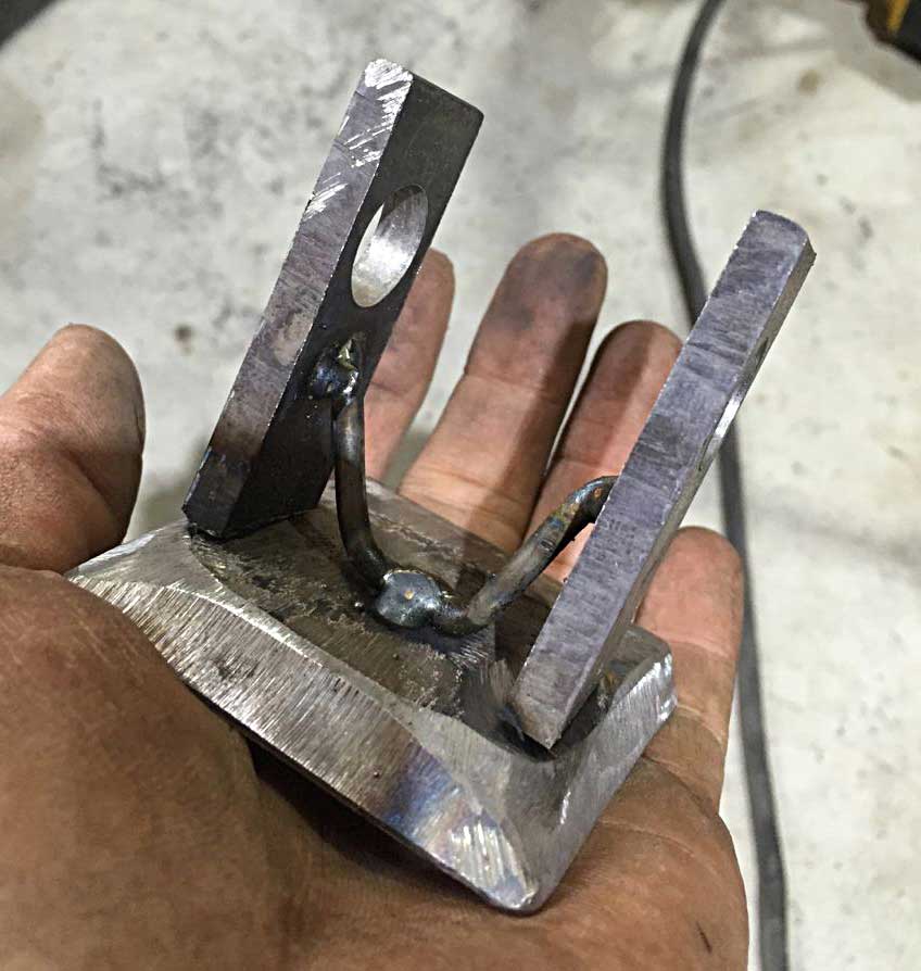

After headscratching awhile; welded the ears to a nail, a bendable jig. This worked really well, just pried the ears (thru the hole) until the pin went thru. Then pulled the plug out and straightened the ears, tested again, and ready to weld. Stopped short of grinding the nail/jig out since it looked pretty well centered.
439897d1441550277-2-receiver-welded-into-mini-4tackplug-jpg

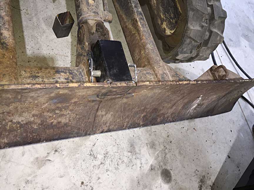

Receiver plug in the receiver, aligned, and straight.
439896d1441550277-2-receiver-welded-into-mini-5plug_inserted-jpg
Welded the receiver plug ears solid.
439895d1441550277-2-receiver-welded-into-mini-6plug_welded-jpg

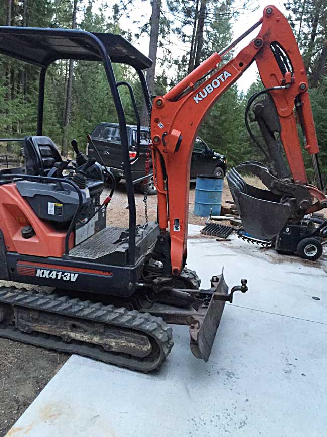

Pinned and done! Can't even tell this blade's been hacked. :cool:
439894d1441550277-2-receiver-welded-into-mini-7plug_inserted-jpg
Little guy looks kinda proud doesn't he? :D
439893d1441550277-2-receiver-welded-into-mini-8ball_inserted-jpg

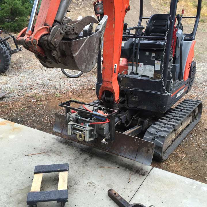

oops sorry, re-uploaded images. I'll plug my 12,000 lb winch in there for you (hope it doesn't tip it over :D )

Wow Good thinking on how to align those ears for alignment. :)
My headscratching sessions usually turn to disaster... the more I think about it the more far fetched (and impractical) my solutions become. Most often resembling something out of a sci-fi cartoon...

Very cool... and yeah smart thinking on the nail hold. I will have to remember that simple trick. The hard part will be the remembering.

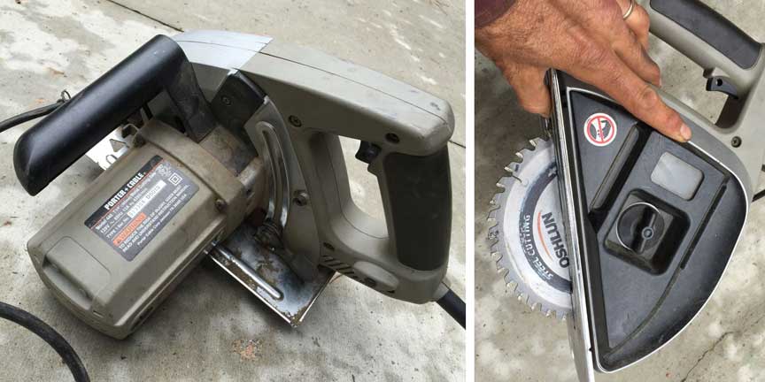

You cut that with that sawblade on the first picture?? I cannot imagine that at all. Any saw blade of mine will turn to crap after hitting a nail.
   / 2" receiver welded into Mini-Excavator blade
Not a skilsaw, it's for cutting metal. It will cut a sheet of 1/4" steel (it seems) about the same speed as a skilsaw cutting a 1 1/8" sheet of plywood. porter-cable-metal-saw.jpg
DE heres a pic for you. Notice this winch is so heavy it needs a dolly (100 lbs).
