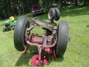

I am a fairly new tractor owner. I'd like to tow a small utility trailer I have to carry brush, etc. I am able to find no end of 2" receiver units for 3 point hitches, but the attachment that would seem to be a no-brainer, a 2" receiver that either bolts to or replaces the drawbar is not to be found anywhere.
I did see a nice photo of a home-built one on the site. Unfortunately I do not have a welder nor the welding skills. I could have a local fab shop build one for me, but I'm just amazed I can't simply buy one.
Any suggestions?
Tractor in question is a JD3520, if it matters.

I know what you are asking for, but, it doesn't seem to be manufactured anywhere.(I've searched everywhere)
You'll probably need to get one custom made.

This is where the confusion comes in.
The actual drawbar on a tractor is not the 3pt. hitch, the drawbar is the bar that protrudes from the bottom of the tractor near the rear end........it doesn't move.(well, not up and down anyway)
Some smaller tractors have the drawbar hole molded into the steel that is part of the tractor frame.
That is the 'towing-pulling point' of a tractor.
Edit: this Farmall BN is upside down, but the drawbar is visible.
