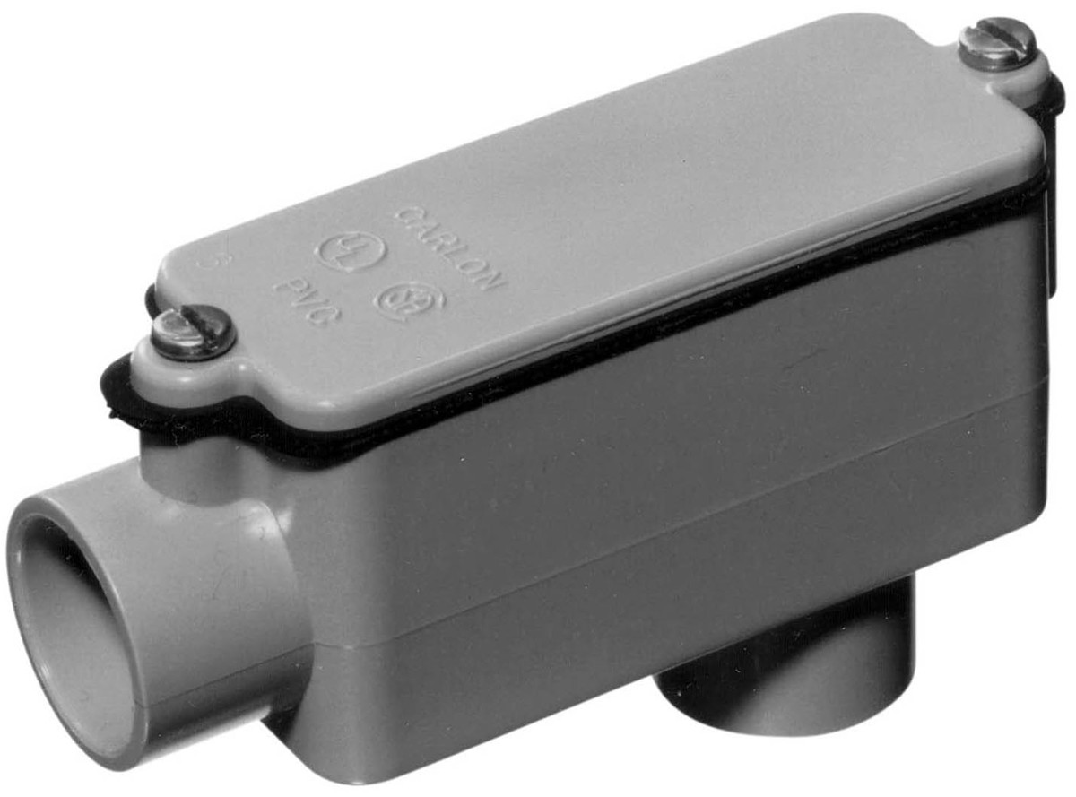

I am burying 2" PVC conduit for my generator permanently under a concrete pad so it pops up through the slab 2 feet from the wall. The generator is 3x8 foot and where the wires go into it is a 90 degree, approximately 10" from the floor. Not ideal. So, . . all I can think of using is a 2" LB PVC Conduit Body.
Again, not ideal. Would prefer something better for vibration. Please help with suggestions. Thanks.

Sealtight. Liquidtite. Whatever it's called in your area. And the associated connectors at the rigid pipe and generator frame. Use straight connectors and let the flex conduit make the bend. The connection to the generator needs to be flexible.

I agree wholeheartedly with the liquid tight flex conduit but also suggest an LR or an LL so the top is not getting the rain. It's the same basic L connector with an opening on the left or right side instead of the back.

Thanks guys. Exactly the info I needed.
Now I just need to find a supplier that will sell me 2 lousy feet of 2"!
   / 2" PVC Conduit Generator 2-2-4 end piece? LB? #5
Any electrical wholesale house will usually sell it and the 2 fittings
