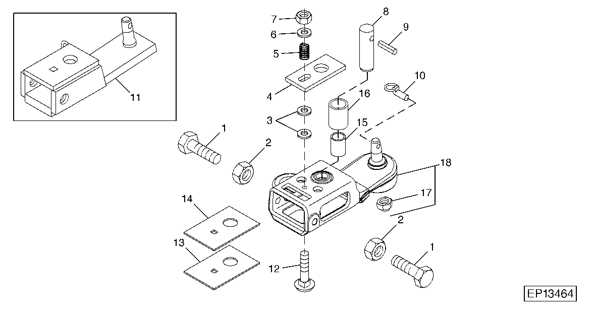

Has there ever been an adapter setup made for the regular size balers to be able to turn sharper? I seen the pictures of a small baler that made to turn sharp. I'll be doing small fields and it looks like something that would have it's merit so a fellow doesn't bend his PTO shaft when turning. bjr

JD sq balers beginning with 336/346 models have equal angle hitches that allow the tongue to be at 90 degrees with no pto shaft ill affects. The equal angle hitch made the pivot point of the tongue exactly 1/2 way so that the angles on the 2 u-joints were always the same therefore eliminated the vibration.
