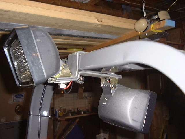

Bob, you might want to look at 3M marine adhesives 5200 is quite permenent (chisle it off) 4200 might have a chance to remove it /forums/images/graemlins/smirk.gif. on My BX I have a height problem so I made brakes and used 3M thick (foam) double sided tape. For the tape I would make sure you have a fare amount of surface area. So heres a link to my solution to the lighting (sorry can't post a attachment work firewall)
kubota light bracket
Cheers
Tony

I like your brackets. You must have the same height issue I do! I never considered side brackets like you designed becuase I was afraid of snagging trees, but you have full protection, or as full as can be expected, with the housing you build around the lights. Your design is very clean and compliments the tractor.
But I have a couple questions.
#1, I noticed you ran your wires inside the ROPS (your picture #13), does the BX come with holes in the ROPS or did you drill them?
#2, You used doubled sided foam and I wonder how long you have had the light brackets attached. Also is the foam waterproof? I attached an XM Satellite Radio faceplate to the dashboard of one of my convertibles with 3M double sided foam and found that it lasted about 6 months. It never got rained on, but the sun would soften the adhesive enough to drop the faceplate. The faceplate only weighs about 3 or 4 OUNCES and still it would fall off on sunny days. I ended up using SuperGlue to hold it on.
#3, Have you hit anything with your bracket yet? I am curious what the shear strength is on the 3M foam. I would expect that if you hit a house or deck it would tear right off, but if you hit a branch, what happens???
#4, In one of your pictures you have a box on the back of the tractor (picture #15) is that a weight box or is it some sort of a spreader for salt/sand?
#5, I love that Jeepster Commando, this summer I almost bought a Commando Pick-Up, I had never seen one before. It had an integrated cab and box but the owner had redone the interior is red crushed velvet and getting closer to stock, or even putting in some nice seats would have required more work/expense than I wanted. Somehow I just couldn't bring myself to driving something with a red crushed velvet interior!

Tony, your lights look fantastic!

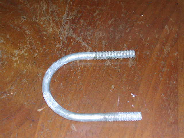

FWIW, I installed a pair of KC Hilites driving lights to my ROPS using the double sided tape that came with the lights. The tape lasted about a year before I found the lights hanging from their wires. My tractor is kept in a garage. I've since switched to using U-bolts.

Foam has been on over a year and the only problem was when my wife went to mow the yard next door and whacked a large branch the foam sheared bracket was ok and so were the lights so a quick scrape and some new tape back in biz, small branches no problem but she cut the corner on a 4-5" dia willow, glad she only hit the bracket if she hit the ROPS I think the tree would have really won /forums/images/graemlins/shocked.gif
I drilled the ROPS and repainted and used gromits for the thru holes so I don't have chaffing. If the size hole that I drilled cause a problem with the ROPS then I think I'm already
in alot bigger problem at that point. (but do you like the "custom" Homie Depotie electric switch box /forums/images/graemlins/grin.gif?)
The box is the standard Kubota weight box I have four bags of paver block base (pulverized granit) and now is has shrink wrap over it to keep out the rain/snow but is vented to let the moisture out.
My parents bought the Commando new from the factory its a 67' they picked it up in 68' she was one of the factory test jeeps (fashion bar,different front to the soft top,extra hood latch). Its a fun Jeep soft ride and easy to drive mom still drives it and she just turned 75 last thursday.
Red crushed velvet?? sure it wasn't from Detroit /forums/images/graemlins/shocked.gif??
