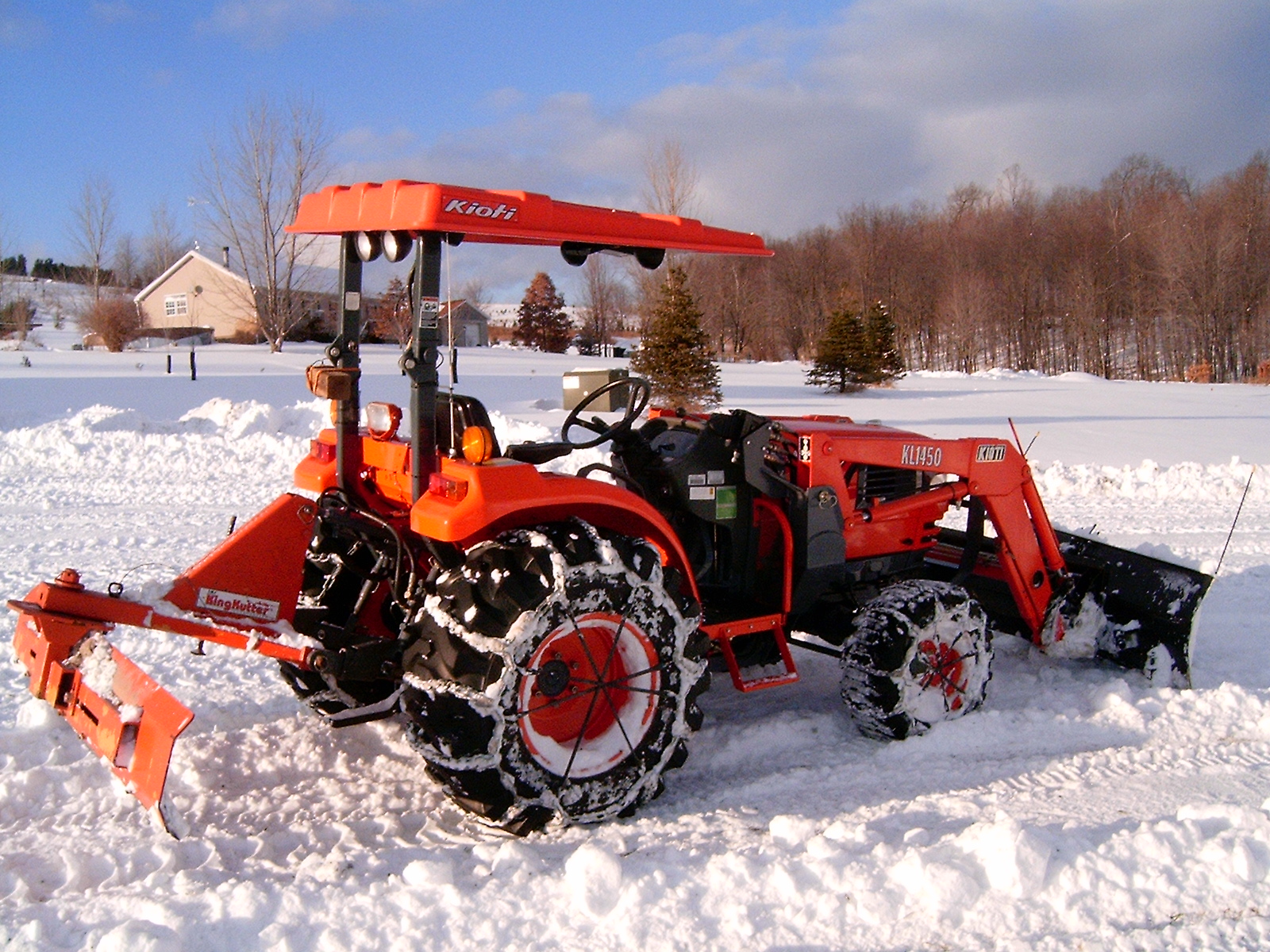

It really depends on your situation. I have a level 150' drive and the 4-link chains are fine, although a bit bumpy. These are mounted on turf tires, BTW (see the attached pics).
2-Link chains will provide a "smoother" ride then the 4-Links do. Downsides are the 2-Link chains are heavy and cost considerably more then the 4-Link chains!!
So, if the area you plow is level, save some bucks and your back and go with the 4-Link chains.

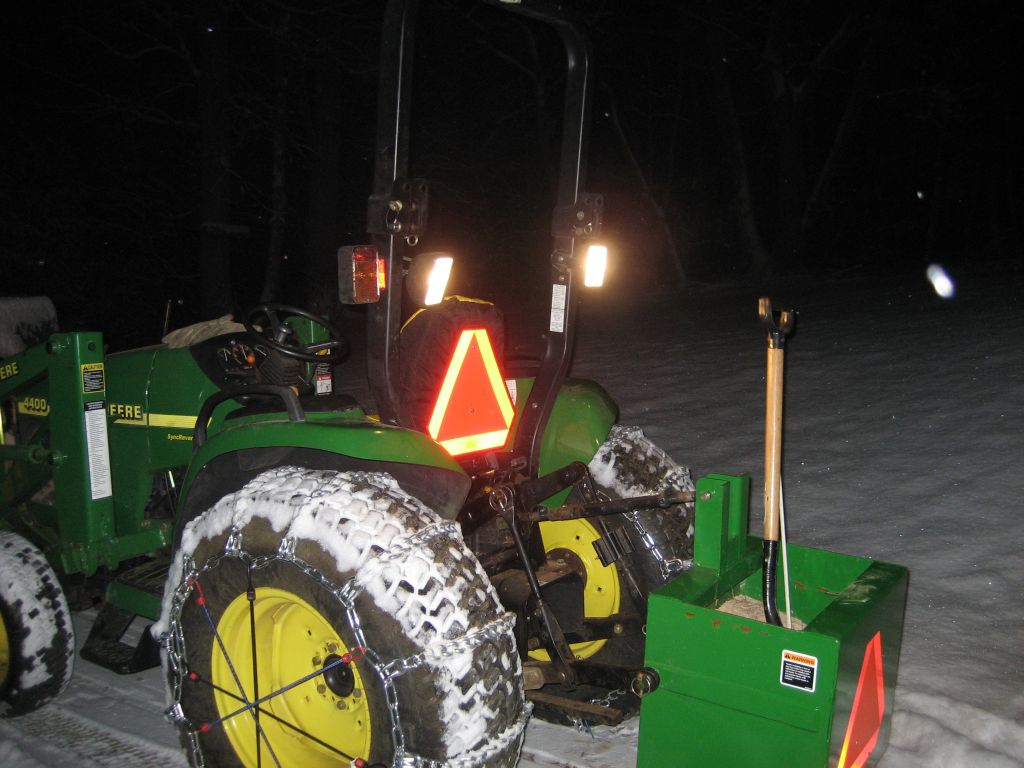

I run 4 link chains for snow and ice and have very good traction.
Never tryed them in the mud.
