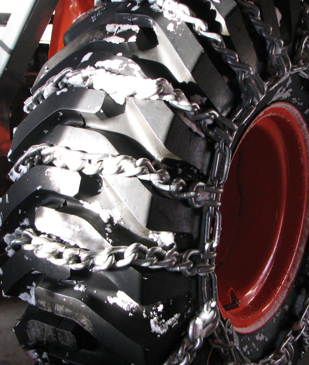

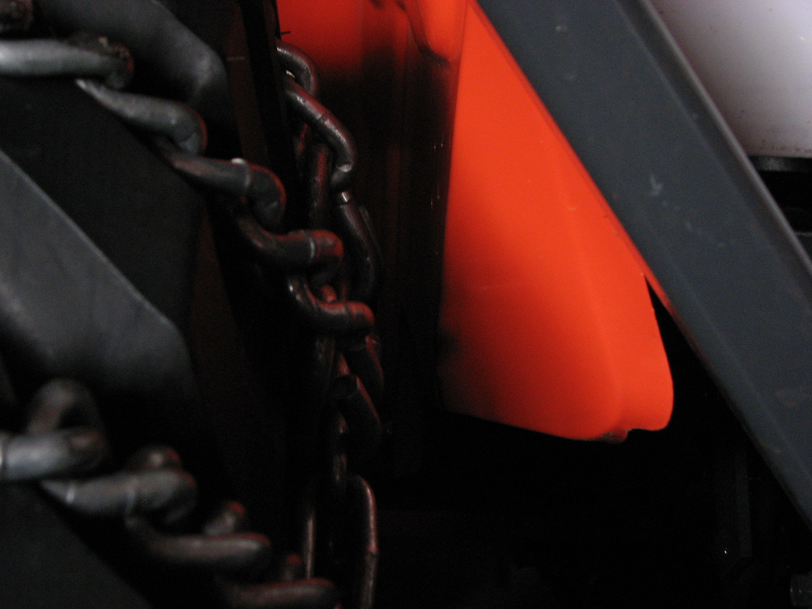

Have had my 2 link ladders since 2005.
Can't recall how much chain I cut to get them to fit.
Have about 1 " clearance from inner fender,
so I have never had any problems with the chain hitting anything.
I don't use tensioners, I let all the air out of the tires
(I don't have liquid ballast in my tires), install the chains, then
fill the tires up to about 16psi. Chains fit very tight and don't move.
Very happy with them.
