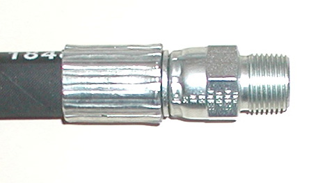

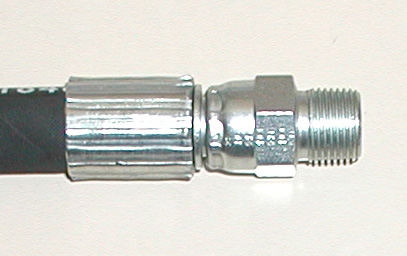

I have purchased a whole set of hoses (all NPT) with one swivel end from Agri Supply.Some of them are connecting solid but there two so far, that even though are torqued very tight, I can still move the rubber part of the hose 1/32 +/- up and down.
On all these hoses out of the box you can move the threaded male part about 1/16" in and out, as shown in the pics below.
I can't believe they are all defective. Looking inside, there is nothing that I can see, that can the close the gap when it is tighten. I am hoping that when there is pressure applied they will seal. I am in the process of installation so there is no fluid yet.
Any thoughts?

I never worked with fittings like that before. I don't see what would make that swivel part tighten up when you install it. I guess this will be a "try it and see" case. Sorry I can't help.

Thanks. I feel better now.

IMHO - I would recommend avoiding NPT whenever possible. It is much easier to get a sealed joint with JIC, no messing with tape or dope, the swivel is built into the female hose end, and there are a lot of elbow options (45, 90, long 90, etc). Put adapters at your valves and cylinders, NPT-to-JIC or ORB-to-JIC. This is the way any self respecting OEM does it.
If you want the Cadillac fittings go with O-ring face seal (ORFS). There provide a very good leak-free joint - but they cost about 20% more than JIC, are physically larger for a given dash size, are harder to get the thread started due to the straight thread, and have a less fitting choices. Some OEMs are willing to make these trade off's to emilinate warrenty work, but I don't normally recommend them.
