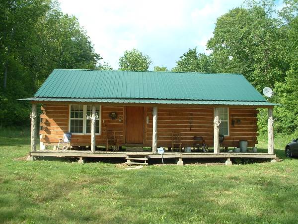

I agree with Kent that you should consider a stain used in the log home industry. I built a weekend getaway log cabin on my farm a few years ago. I used pine cut off the farm. I use a oil based stain called Woodguard. It is easy to apply with a pump up garden sprayer. All you need to do is spray it on and back brush. I am very satisfied with the product.
Note that Woodguard has antifungicides and insect repellants mixed in. Be aware that wood boring insects can be a serious problem with wood siding. The only thing it won't control is Carpenter Bees. These critters look like what I have called a bumblebee all my life. They will bore holes about 1/4 inch in diameter in the wood and start a family. About the only thing I have found to combat them is a badmitten racket and quick reflexes.
Woodgard comes with a variety color finishes. I use a color called honey on my cabin. Attached is a picture of the cabin.
