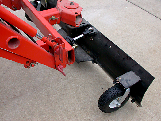

Blackfoot,
I'm not exactly sure what you are looking for but I have a 6 foot dirt blade hooked to my loader arms via a homebrew adapter. I added the power angle cylinder the next year. Have pushed snow high as 12 inches for 4 years now. If this helps you I have more pictures and can supply more information.
   / 2 Angle the plow blade #7
Hi, great looking snow blade. Could you send me some pics., and info. Thanks
   / 2 Angle the plow blade #8
zmansmac, are the wheels on your blade to keep it up off your stone road or driveway?
Sincerely, Dirt
   / 2 Angle the plow blade #9
zman,
I like that setup a lot. Because I plow both gravel, and blacktop, it would be so nice to have it angled back for the stones (blade riding on the feet), and angled forward for the blacktop (blade resting directly on the blacktop).
I think I'll be copying that setup in the near future :)
   / 2 Angle the plow blade #10
On most pickup mounted blades eg Fisher, they use a mushroomshaped skid plate that is cast iron.
Main reason is when the blade is angled off to one side the plate does not care which way it is aimed.
Just kinda slips along.
For height adjustement they simply add or remouve washers from the shaft.
Tires can go flat plus they would tend to freeze up in that crappy slushy muck that we have to plow.
It is the KISS approach. (keep it simple and stupid!)
