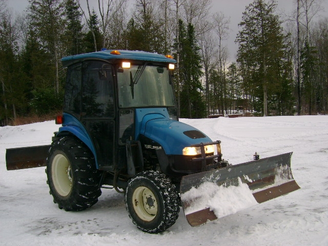

We got about 20 inches between Sunday and Monday. We do commercial snow plowing and one of the machines we use is a TC45D with a 702C front mount plow (with a Jodale Perry Boxer hard cab). So between Sunday and Tuesday I have put about 20 hours in the tractor seat....
We use to use the FEL but it is too slow by the time you push and then have to dump. The plow is fast, just in and out of the row, plus we have less bucket spill to clean up after every pass.
I will post a picture of the rig shortly (pics are on my computer at work and not on my laptop.)

As promised, here finally are the pics of my TC45D with my new to me 702C plow....
Jeff
