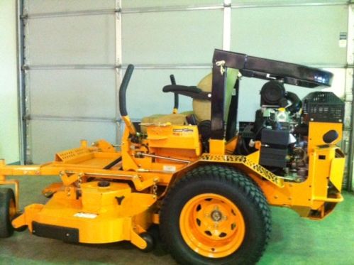

Looking at getting a new scag TT, likely within the next year, maybe much sooner if the right deal comes along. looking at buying new, and was wondering if anyone had actual first hand, or maybe direct second hand (ex. good friend of yours has one) knowledge of that engine as used in a turf tiger (horz. shaft engine). I know they are air cooled, and after having a coolant leak in my f725, I am ok with air cooled. Not too worried about higher fuel use compared to the efi models, as it will likely see less than 50hrs a year. Thank you all for any input you may have about the engine.

I have a early Cheetah with the Kawi 850 on it and a new Turf Tiger with the Kubota 25 diesel. The new Kenda tires on the Turf Tiger have a more aggressive tread and are softer more tacky rubber. They grab the turf and tear it more on the turns. I think they are Chinese tires. The Carlisles on the early Cheetah have rounded edges on the tread lugs and the rubber seems slicker and harder. They leave much less turf damage. Current Cheetah's have Kenda tires also. :rolleyes: If you mow 50 hours a year with a Turf Tiger you'll mow just 40 with the Cheetah! If your getting air cooled the B&S Vanguard 35 is a great choice. Its made in Japan by a division of Toyota. Are you getting a 61 deck or the 72" deck?

The Briggs Vanguard engine is as good as they come in an air-cooled gas engine. Pretty much bullet proof by everything I read. I've got a much smaller 18hp Vanguard in my Deere GT235e. It's 11 years old and has given me no problems at all. (Knock on wood.) My order of preference in air-cooled carbureted lawnmower motors would be:
