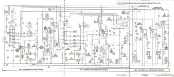

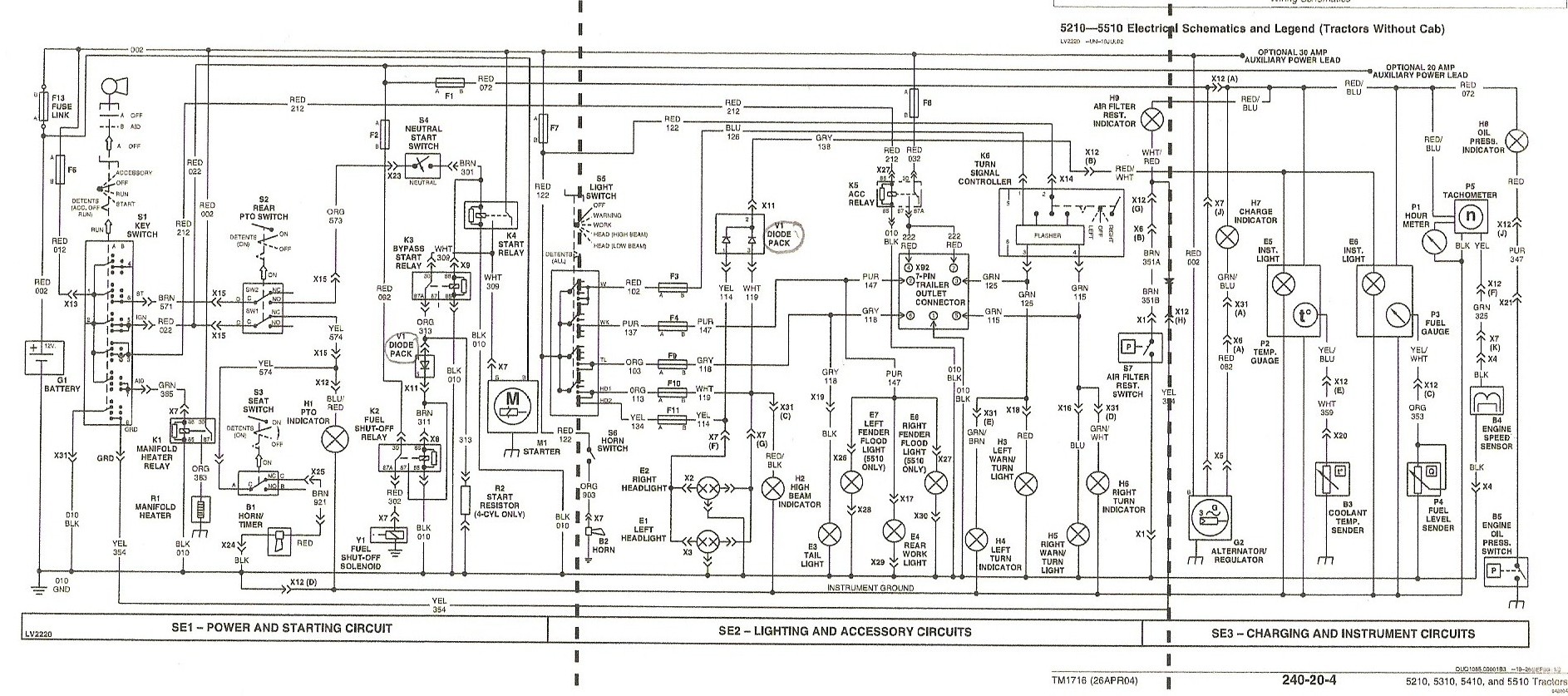

Here is a wiring diagram, also check selectmanuals.com $35 for the tech manual. Make sure you put equal pressure on the 8 screws when replacing the cluster to avoid breaking the glass.
If you do decide to get a new cluster check out greenfarmparts.com $543 and if you register on their web-sites a couple times a year, they send out a 10% off coupon. While I have not had problems with their stuff, there is a NO return policy on electrical items. Also on the new clusters, all three needles swing to the right, then back to the left and there is small wiring change that is needed.
On the lights/flashers the problem could be in the diode pack RE262484. I do not see were the diode pack plays a role in the fuel/temp gauge, but you could pull it and see what happens, since it sounds like you have already removed the cowl and it does sound like you are get some voltage to those gauges when the wires to the sending units are disconnect.
