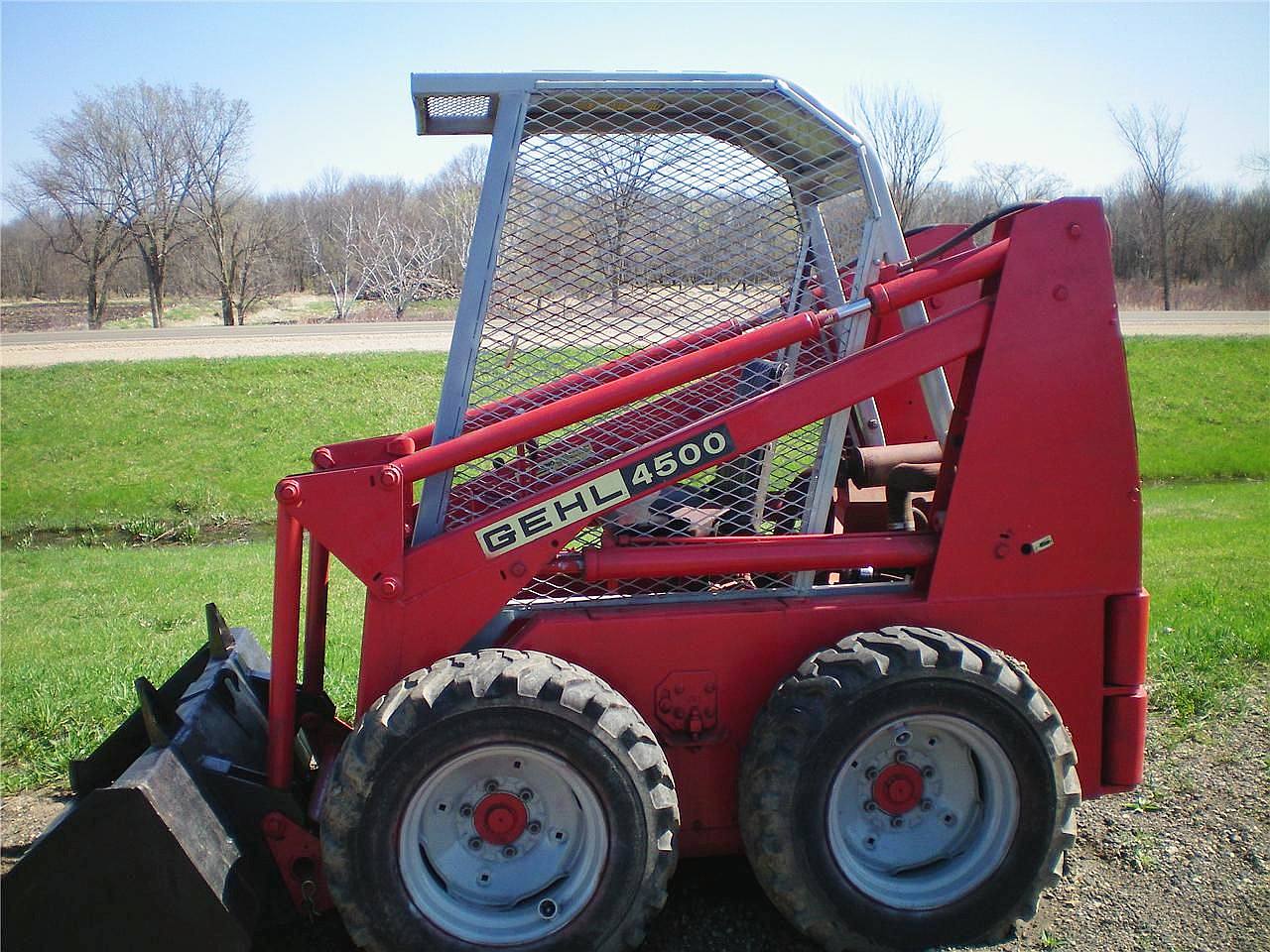

Hi I own a gehl 4500 and the rear tire seal is leaking does any one know how to remove and replace the new seal

Bob I've been Told that it's the same as a Pinto /Fiesta Motor I ordered On for mine a While ago and found I didn't Need it . But it Was the Same . For Some Reason my 4500 keeps not wanting to turnover I've checked all the Cables and connections. I thought maybe it was the old ford thing where the starter locks into the flywheel but turned it over by hand with the fan and still the same thing . I took the Starter off (What a ***** )and bench tested it and put it back on and worked fine for a while. This thing is driving me. It does not make any sense that the starter will bench test ok and then not work good again after a bit. I thought that maybe it has a dead spot but bench test good ! Any Ideas . I bet yours is the Same Problem ! Thanks Al

Al, Thanks for the reply, I believe it is the same problem mine is intermittent some days it will start right off and other days it does act like it is locked up the solenoid kicks in and draws current but the motor wont turn. One day it would not start I reached down with a plastic handle pry bar and shorted the battery hot to the solenoid switch wire on the solenoid and it started and then worked for a while again. I would really like to get a repair manual for it for I plan to rebuild the motor and all worn parts. Thanks Bob

To all with the intermittent starter problem on the Gehl 4500 and maybe many more, finally found the problem, The wires going to the starter solenoid from the switch is to small and if the battery is just slightly low the voltage drops to much to kick the starter al the way in, The solution is to install a starter solenoid down near the starter and run heavier wire from the battery to the new solenoid and then to the starter solenoid, then you can operate the new solenoid using the old wires from the switch because the new smaller solenoid don't use as many amps as the old starter does. Hope this helps. Bob
