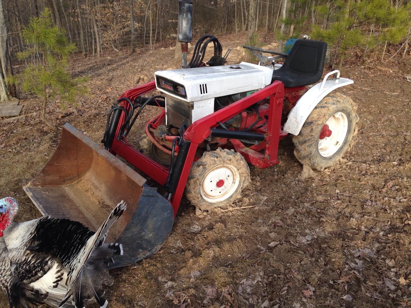

HI, I just purchased my first tractor, a 1979 ISEKI TX1500F / G174. I am concerned about the lack of safety features. Is it possible to install a ROPS? ? where would I go about searching for such a feature? Due to the light weight of this tractor I have also considered adding some weight to this tractor so I can fill the loader lol. Would anyone care to share their experiences of adding a substance such as windshield washing fluid to the tires? Also I have searched the internet for a free service manual with no luck, any help would be appreciated!!

For my tractor I went to local junk yard and got 2 55 gallon drums of used antifreeze.Then tractor suppy carries the adapter to fit on valve stems and attach a hose.Got a pond pump on ebay for 23 bucks and a plastic well footvalve from local farm store.Loaded my tires for less than 75 bucks and the antifreeze will not rot your wheels.You could always go to local fab shop and have them fab up a ROPS or if your handy with a welder make your own.Just be sure its made to bolt to your real axle housings

Hello I was looking at the picture and that looks like a turkey,
Iseki tractors tend to attract turkeys :laughing:
