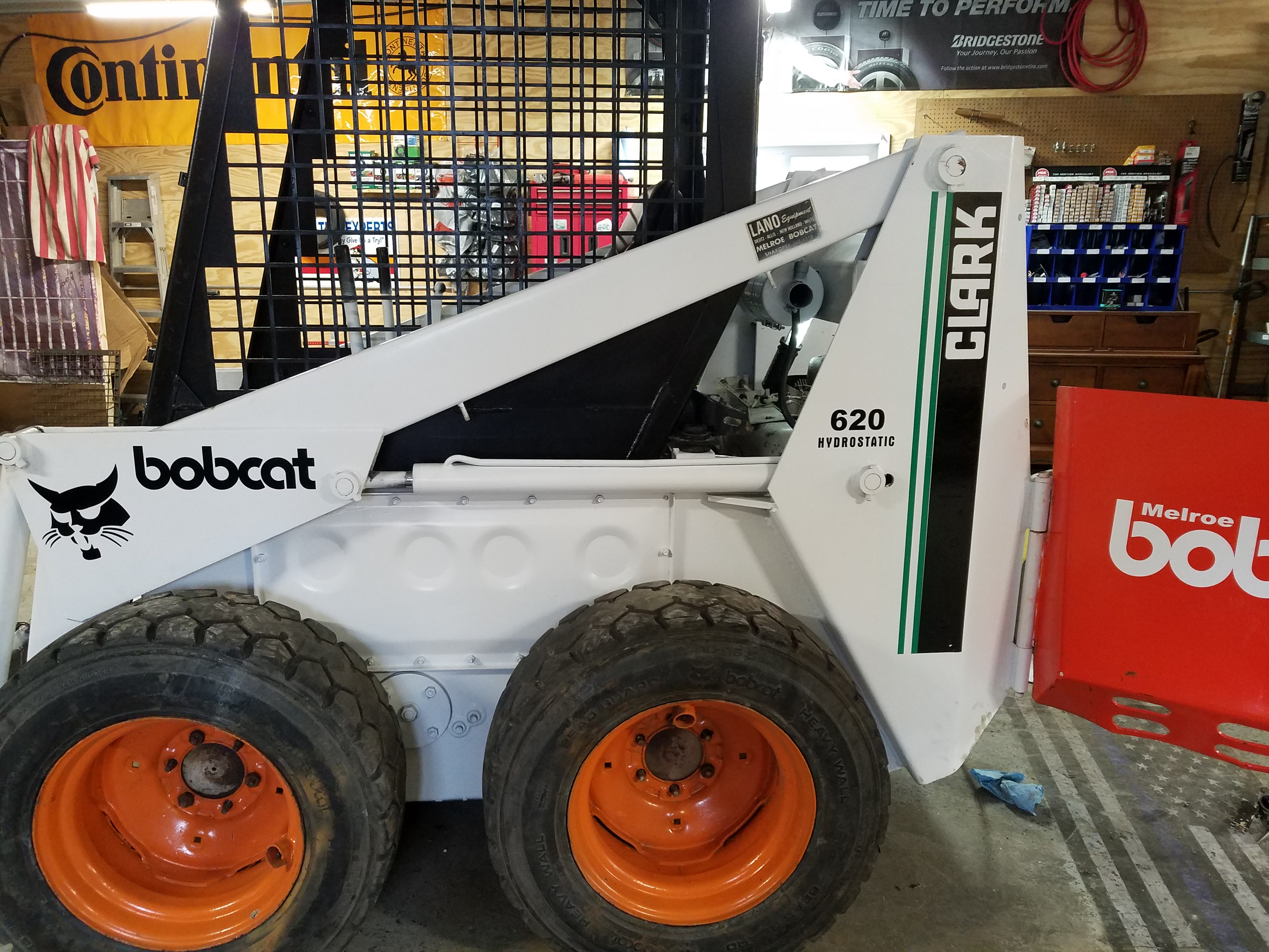

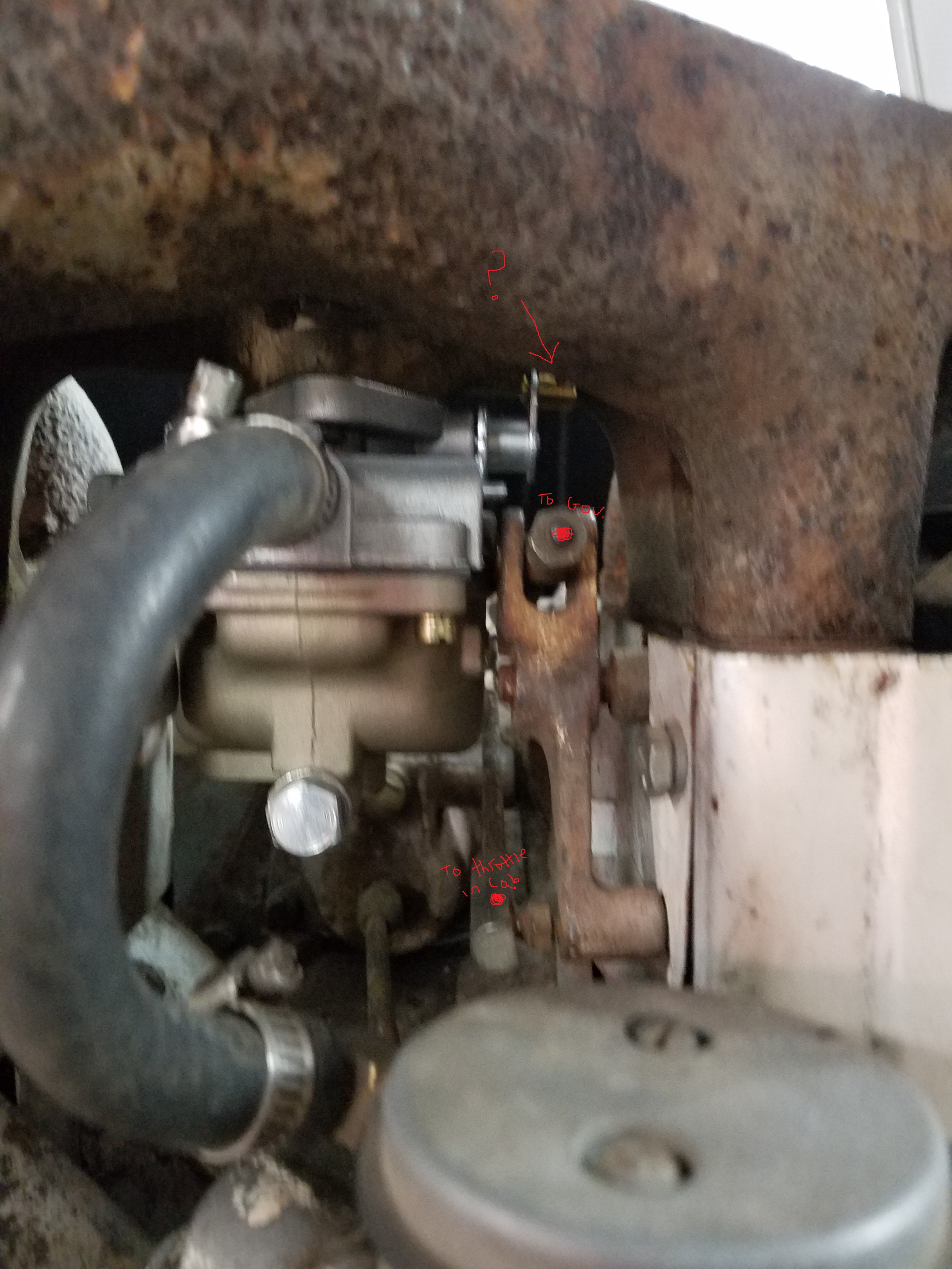

Does anyone have good photos as to how the carburetor should be installed on the Wisconsin vh4d?
/ 1976 Clark Bobcat 620 #2
It should be basically the same as my 700, so the air intake side goes toward the front. The governor and choke linkages would be on the wrong side if it was on backwards.
This site should have the relevant manual for that, there was like three different carbs used, a manual is good to have.
Yeah, the linkages are what is messing me up. I have the carb on correctly, but the links dont look or work correctly.
More specifically, the throttle controls. Nothing is matching up with what I have in front of me. Picture showing throttle linkage to cab of Bobcat. What connects to the carb. side? bobcat.jpgcarb.jpg
/ 1976 Clark Bobcat 620 #5
The top one that you have the ? by is the choke. The cockpit throttle goes to the governor, and that goes to the carb.
Nice looking machine.
Thank you. That doesnt match up at all either. This thing is kicking my ***. LOL
